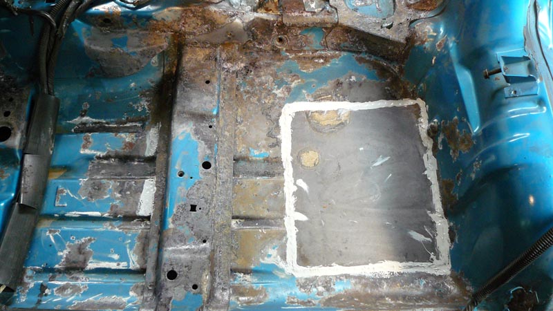

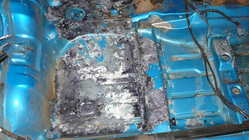

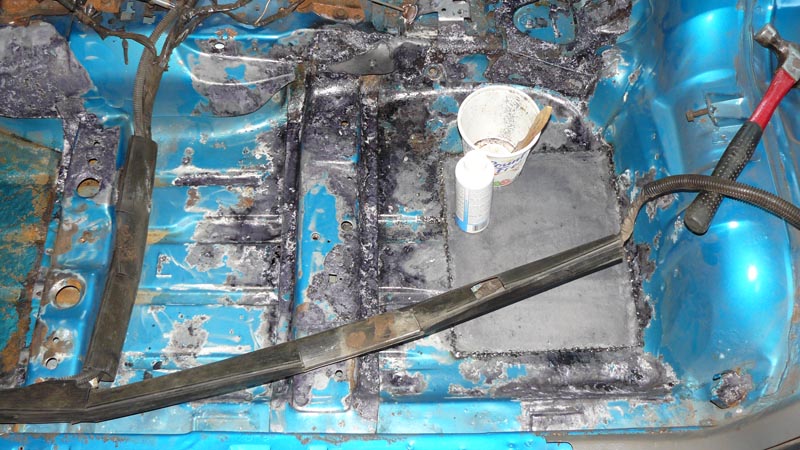

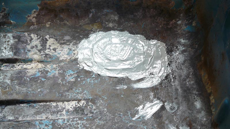

Speaking of pics, here are a couple from this morning after the rust stuff had all night to work on it... Man.
Looks like it did something to the rust.... The new panel is completely rust free even!

What was that stuff? Looks like it did a better job than the deruster I used. Still need those rails?
Re: DTMAce's project continues....5-26 - Floor Pan Disaster!
It is called Rust Converter. Contains phosphoric acid, isopropyl alcohol, & tannic acid. Bottle simply says that it converts rusty metal to a paintable primer. Surface rust simply rubs away. Bad rust like what this thing has it simply eats up, turns black and inert (I'm supposing). Very watery, and looks pale orange. Stinks bad too. And you don't want to get it on you, it will burn.
Basically its an acid wash, that eats the rust. Bought it in Canada at Canadian Tire for like 10 bucks a bottle.

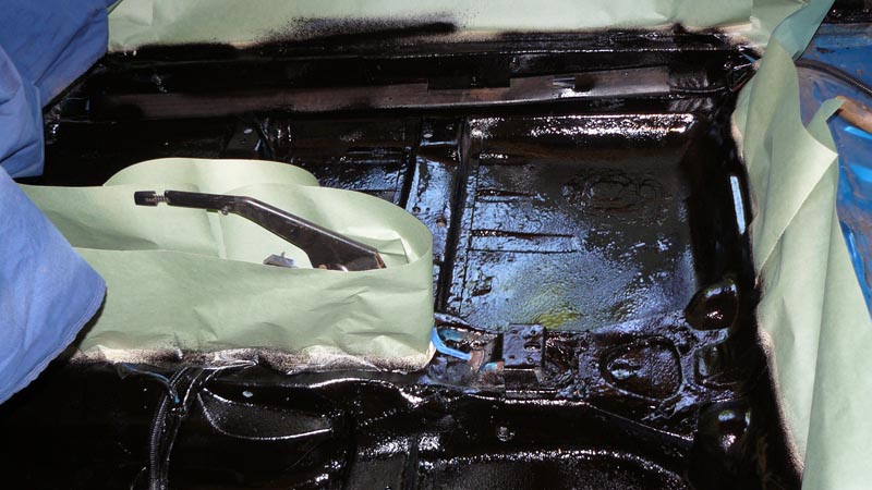

Hello once again, more updates on the work....
Today started in on trying to get the prep done for painting. Been a bit nuts! lol
Anyway pics!

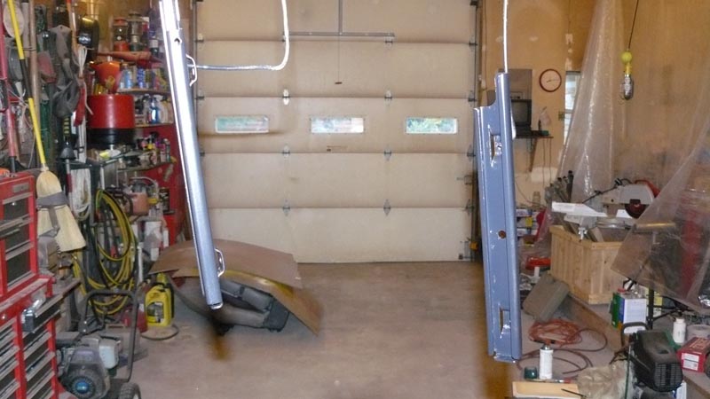

Shot out the door of the pole barn. It was raining today which means the mosquitoes were out like crazy!

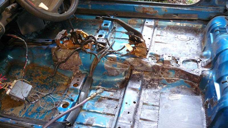

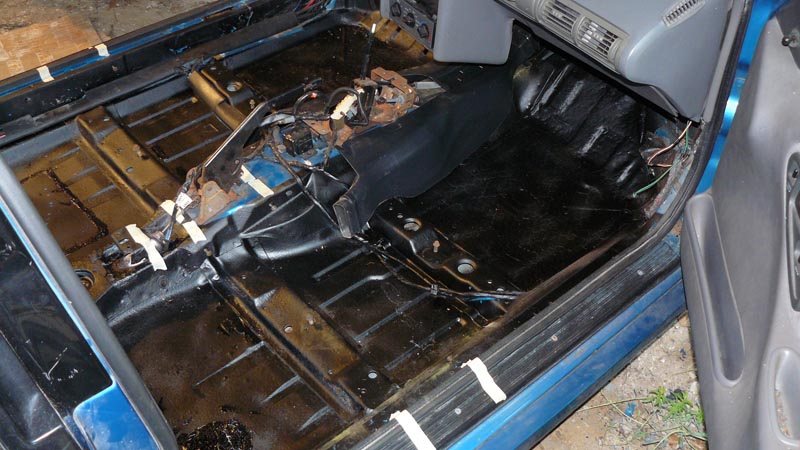

Floor pan after final go over and prep for sealant.

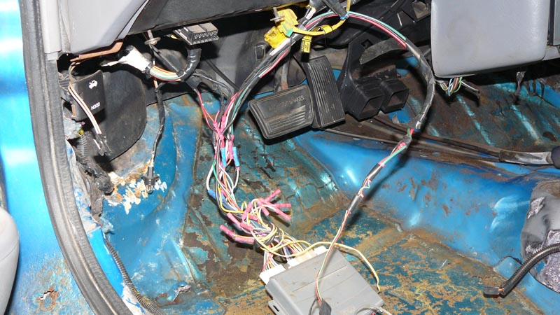

Ok, now for this rat's nest.
Little story. This alarm system was installed the same day I drove the car off the lot. I had taken it to this place in Dayton OH right off the 70/75 interchange. Apparently the car was so new, they did not have the correct wiring layout of the harness, so they screwed up the dome light somehow. Basically since that day, the dome lights will not come on when you open the doors. But they will if you flip the switch on the dash.
Here is the kicker: They couldn't figure it out, and was blaming the GM module as defective. Well, took it to a dealership in downtown Dayton and once they looked at it, they told me that the alarm system had to be removed before they could do anything for me. So back to the sound place, only for them to tell me that to remove the alarm was going to cost me an additional 200 in labor!!
Basically I told them gently caress you. Granted had I been more like the pushy bastard I am these days, I would have had it fixed, and no one would have been charging me anything, but oh well.
However all the wiring mess you see there is a direct result of THEIR work. I have never seen so many butt connectors!!
Anyways, I think I am going to have to pull all this crap out before it goes back together. Just hope I can figure it out. Thing sucks anyway and I don't need it.

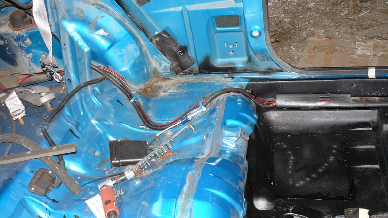

Sealant installed. Yay.

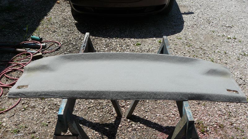

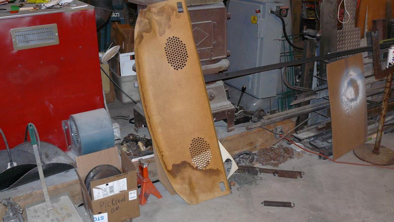

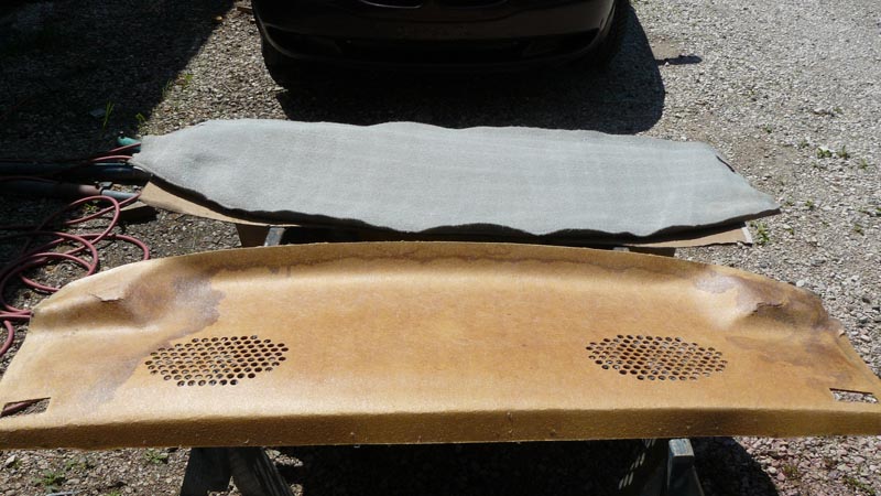

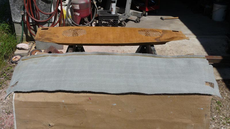

Deck speakers after removing the panel.

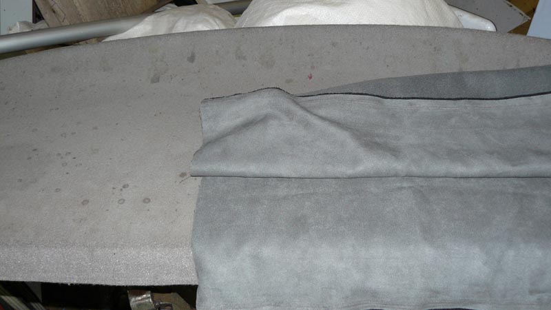

The current panel with an idea of using a different fabric to cover it. Not sure yet, but may do this.

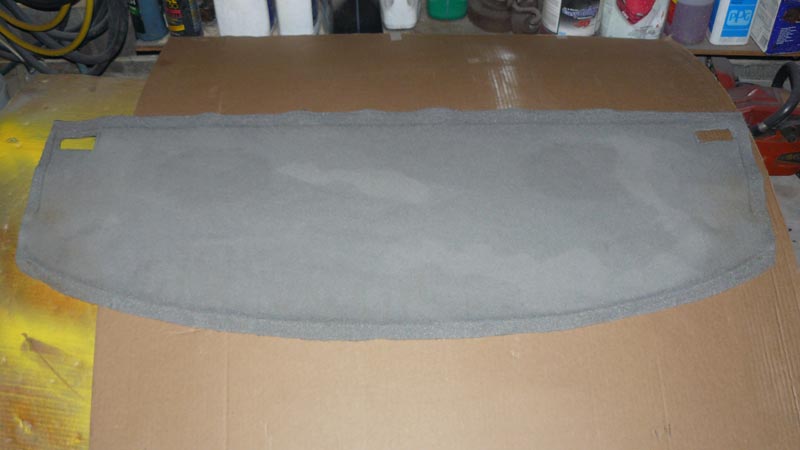

The wood support panel for it. I pulled the fabric and threw it in the washer! lol It was just nasty, couldn't hurt it much worse.

This was after it was washed, laid it out on the cardboard to dry.

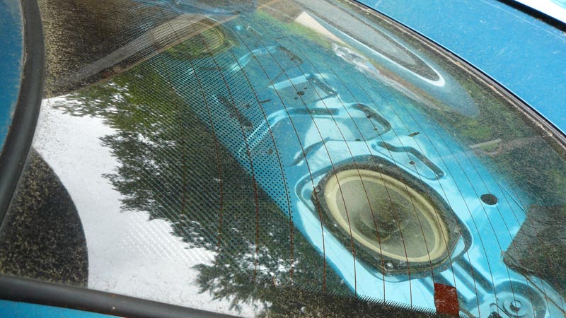

Do you need a wiring diagram for the car? I can provide you with a complete one if necessary. Its of a 95, but should be very similar other than the cruise control circuits.
Well, I can see where they tapped the wiring..... Cut circuits and fed them to the system. Not sure if I will have time to dick with it or not. But will see. This thing would kill the engine if it was set off, and flash the lights, crap like that.

Yeah the one that's in my car I think will kill the engine, I'm not positive on that, but I do know when enabled it should render the key useless since it has a ignition interceptor, or appears to have one wired in.DTMAce wrote:Well, I can see where they tapped the wiring..... Cut circuits and fed them to the system. Not sure if I will have time to dick with it or not. But will see. This thing would kill the engine if it was set off, and flash the lights, crap like that.
I had the same deal, pulled my dash apart and found the aftermarket on wired in already... Actually not done that bad, but I had to clean up some of it before putting the dash back on. It also has steel ball switches on the hood and trunk to go off if either is opened. AND also immediately goes off if the battery is disconnected and then reconnected...That is actually the most annoying part when I work on the car since I need a set of keys nearby all the time to shut it off.

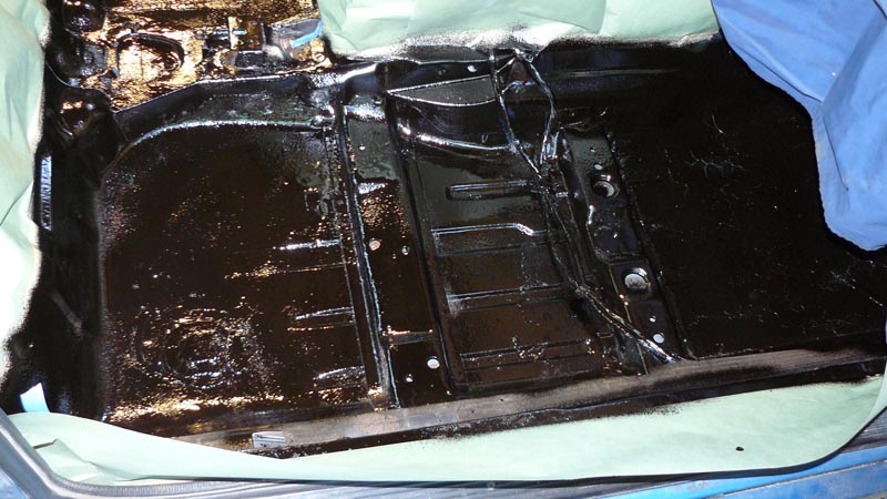

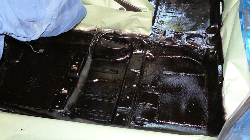

Finished painting the undercoat on the floor today. Pics!
Once that dries, its carpet time!

My 95Z had an aftermarket alarm system when I bought it. I had no idea, it was apparently disabled and I got no remote for it. One day under the dash I must have turned it on because it kept auto-locking me out after 5 mins of the ignition being off and sounding the alarm when you tried to open the door. Killed the ignition too so I had to unhook and rehook the battery every time until I found the switch to turn it off.

This was a shot later on after the rubber undercoat was starting to dry up.

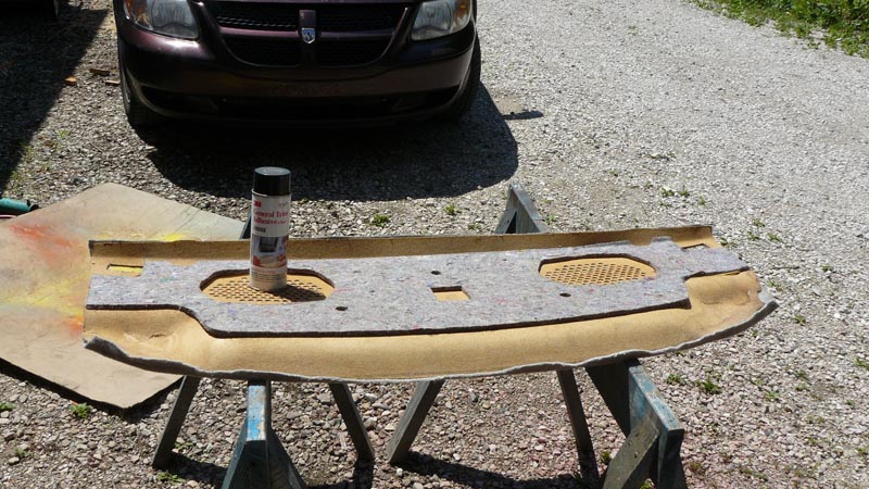

These next few are the re-assembly of the deck panel.

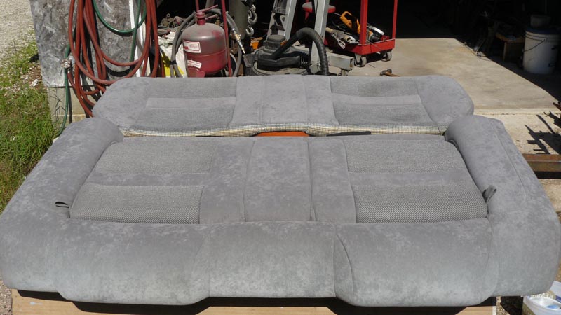

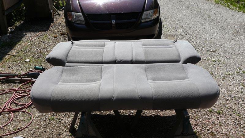

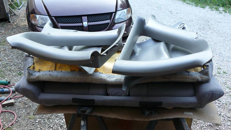

Next, I was working on the rear bench seat. This is after I thoroughly cleaned them. Would you believe I actually had to change the water/detergent mix I was using after doing just the back!

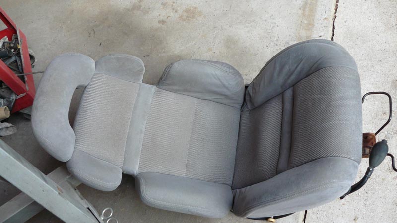

Then it was the driver's seat. This was after I cleaned it. I will be going over it yet again later, not clean enough to suit me yet. But it looks a lot better than it did. I also had to lubricate the sliders, fix a bent wheel on it, one of the seat springs had come undone, etc...

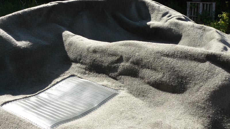

Ah... The new carpet. I finally have pulled it out of the box it has been in for a year and a half! Man. I actually laid it out on the roof of the caravan to warm up and flatten out some. But it came well made. Already pre-molded. Just have to cut a few places, do some trim. There is actually going to be enough trimmed off to also redo the console and the kick panels, whether I will have time to do them though.
Ready for carpet. Put in bolts so that I could find where things go, tape indicators too, and my heat ducts for the rear.
And I have started putting in the carpet! lol No I am not done yet. Letting it form into the floor a bit more. Going to have to do some gluing to get it all to fit well and form completely. Plenty of excess to trim off and use for other stuff.
