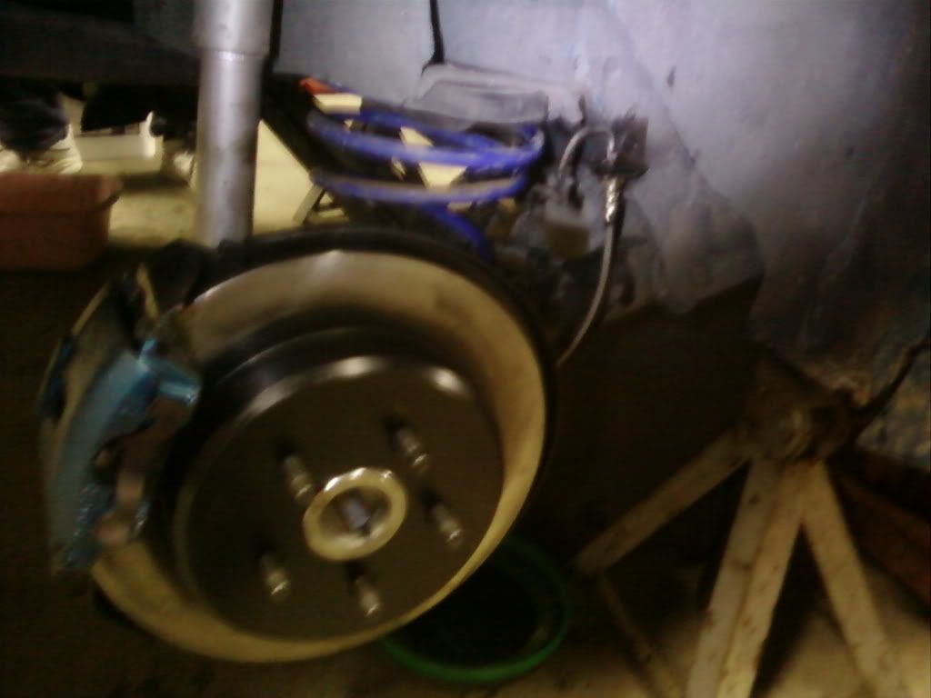

Swap is done. Forgot to plug in the abs sensor on the driver side when putting it all together. On a pre 95 axle, I need to remove the whole wheel bearing again. NICE.
I like how they look though. Ebrake works really well.
Kinda a pain in the ass swap if you run into issues, but its not bad over all.
I have 1 washer between the bearing and the bracket, and 1 washer between the rotor. Just 1 washer wouldn't clear my dust shields, idk why. Maybe its the replacement bearings I used?

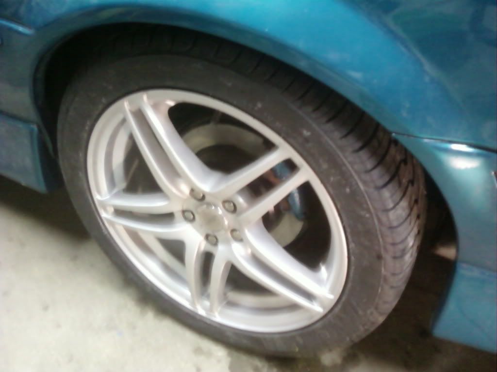

Tires rubbed back fenders REALLY bad, so I started rolling them today. Its almost good now. A tiny bit of camber wouldn't hurt, but no chance of that now, there's enough washers going on.

Posts: 4778
Re: It all goes downhill at once!
Looks good. I've gotta do this with mine...
You need a new camera, or one that will focus up close.
