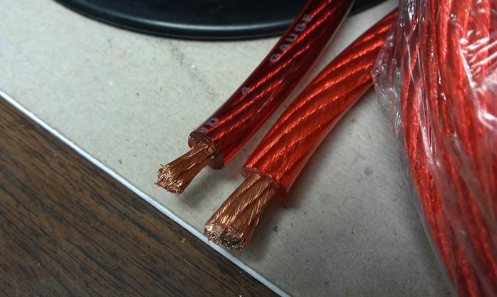

Also installed a slightly larger gauge wire for the alternator... The one I had was tagged 8GA but it would fit 10GA lugs, so I think it was miss labeled audio wire to make you think you were getting more than you were... I'm using the same brand thats tagged 4GA and it seems more like its really 8GA, but that will work fine till I get my new wire and lugs in the mail.

they do some tricky stuff with that audio power wire. my friend had what he thought was 1-0 gauge cut the insulation down and you would be lucky if it was 4 gauge. people use to say to use welding cable as you actually get the gauge your suppose to unlike the audio companies that pull fast ones on you.

Yes, that was my issue, I was using a cheap ass large blade fuse, and the current through it made it too hot and it melted... Now I have an ANL type fuse holder. They are made to support higher amperage, or at least thats what I've been told... We'll see how this survives once I use the AC for a few hours... LOL The new wire I ordered looks much closer to real 4GA than the crap I have, at least it looks larger than what I'm currently using which was already larger than what melted the fuse holder... so I should be golden once thats installed.

Both tagged 4 gauge... Who's lying?
One on the right is replacing the one on the left as my charge wire... The one thats there now is probably just fine since its larger than what I had to start with and what melted my fuse block, so the new wire is simply overkill I know :)

the one on the left looks more like 8 gauge.
what brand is the new wire you got. i wanna redo my stuff to all the same wire under the hood.
