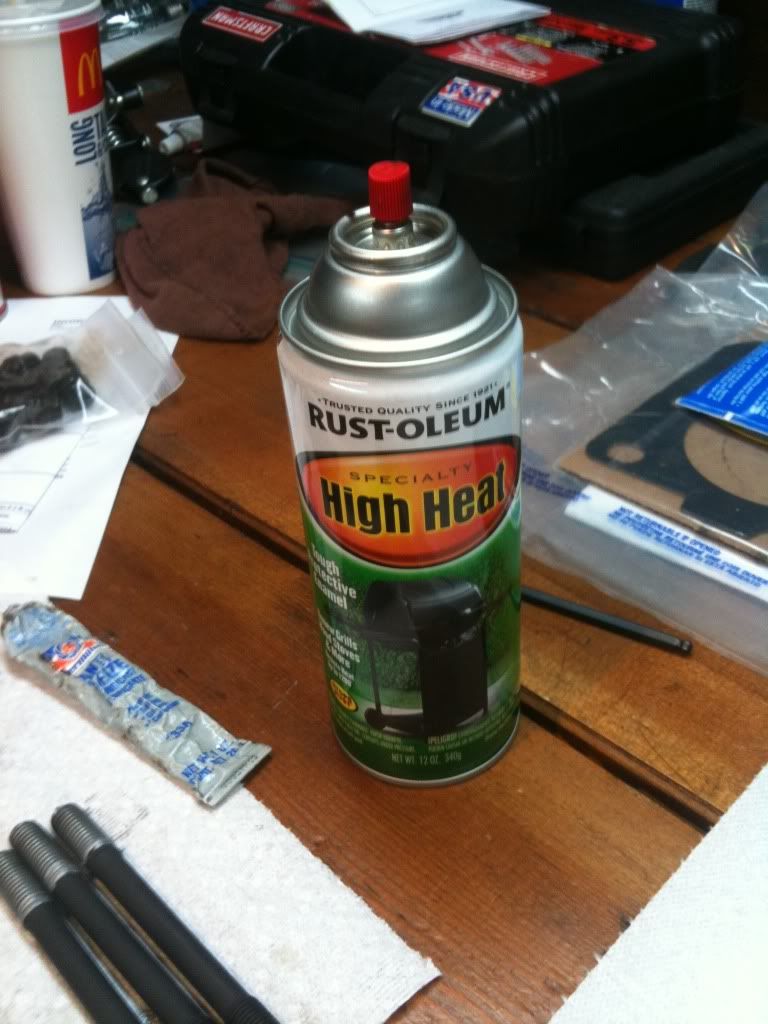

Some updated photos of my new head studs... coated in black BBQ paint and antiseize on the base threads! No moly lube down there!
Hopefully the combination of this and being stored in the garage and not outside eliminates the rust issue I had with the original set of head bolts.

The trans info needs a sticky somehow. Those studs are looking good, hope that does it. When will you start putting the engine back together?
