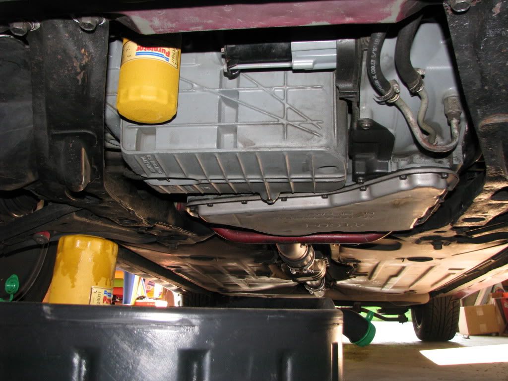

I also did my oil change last night since my injectors didn't come and will probably show up today. Its nice when you get under the car and its as dry as can be... This is my second year now on all factory gaskets installed with no silicone on them at all. I put one thin coat of it on the timing cover gasket around the coolant ports and thats it. None on the oil pan, none on the valve covers and everything is staying tight and sealed!

Coming down to the last minute before bfest.I just swiched to that same filter on the wifes sentra.How do you like them, must be cheaper then 14 bucks for a K&N??
Everything looks good
- Posts: 10923
Re: 1996 Mr.Pink
I've been using purolator since I built this engine. They are a very good filter for the money. Many tests have proven that too.
- Posts: 4789
Re: 1996 Mr.Pink
I noticed the same thing with my Beretta when I was under it. Nice and clean!

Re: 1996 Mr.Pink
Mines a bit dirty but all the new stuff is still dry too! Not like my old oil pan that I had to wipe up every time before doing anything, lol!
