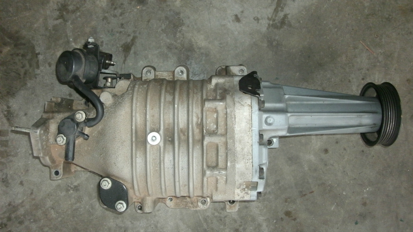

I got another brilliant idea. Adapter plate then bolt this sucker on! 8)
I can sacrifice one of the 3 spare 3.1L plenums and make it work. Then I'd just have to figure out what to do with the engine hood being in the way.
Supercharger
Supercharger
EDIT:
What I mean is I can totally take the intake plenum of the 3.1L, then cut off the throttle intake, weld it shut and clean like on its other side.
Then cut an inlet opening on the top after leveling a surface that will seal with the supercharger.
Then drill holes where needed, thread them, and bolt together.
All while making sure the belt lines up with its pulley.
Considering where it might end up, I can probably remove the Power steering and then install an idler pulley to wrap the belt around the supercharger.
Install an electric pump for steering, then figure out what I should do with my engine hood last.
Man, I'd hate to cut a good engine hood... :cry:

GHOSTOWLGRID wrote:I got another brilliant idea. Adapter plate then bolt this sucker on! 8)
EDIT:
Yep, very do-able, in fact, it has been done. I don't remember the guy's name, but IIRC, his Beretta was black. Might have been a 3x00, or it might have been a MPFI V-6, I don't remember, and he had a hood-scoop covering that M90 monster, and it worked fine, but it looked ugly -sorry. :sorry:
You would still have ECM tuning, fuel injectors, FPR, and possibly the fuel pump to worry about, as well as a 2-Bar MAP, if you really want to do it right.
I'm planning on possibly doing the same thing on my Fiero GT, already updated with a 3x00 from a W-Body Monte, just because it is so much simpler than a turbo, and the exhaust mods are all done and installed for the 3x00. But, the Fiero has the engine in the back, and I don't really care if I have to bulge-up the engine cover to make the M90 fit... It might even look good, maybe. :pardon:
Edit: You wouldn't even need to worry about welding-up the 3.1 manifold's TB inlet -just make a block-off plate and bolt it on. It won't be in the way or anything...
