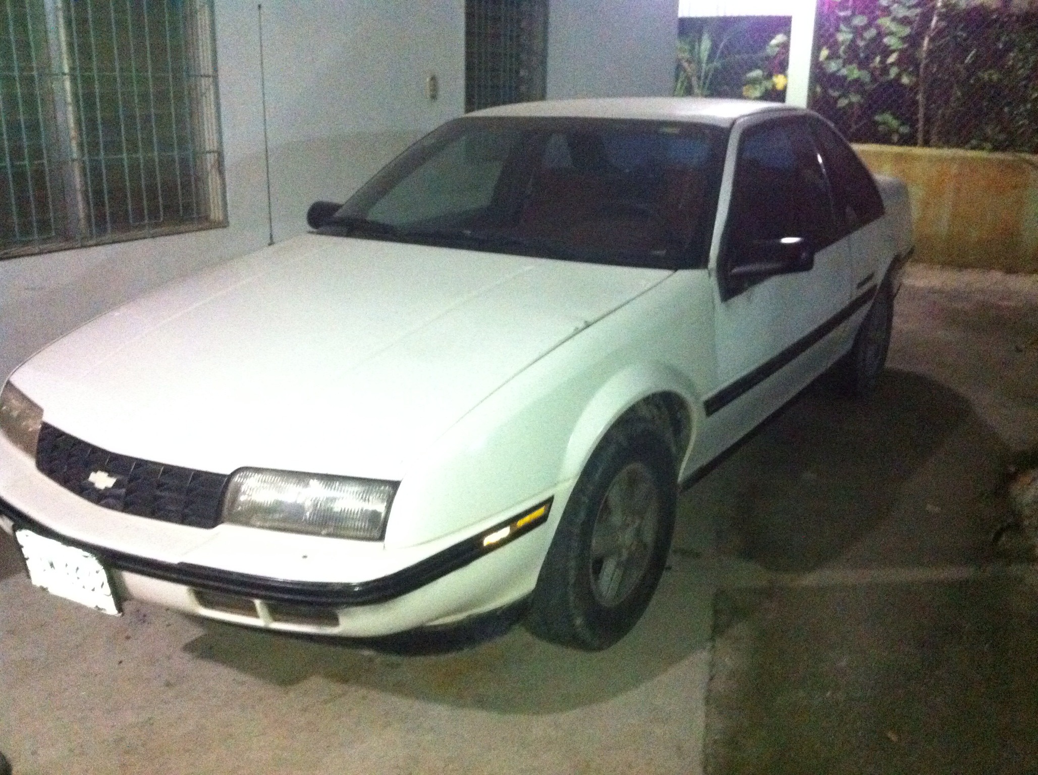

Yes i have some pics of the car in the members rides sections, however i have many new pics i havent got the time to upload yet. Added a pic just to show you how it looks right now lol more pics coming soon as im getting most parts next week
