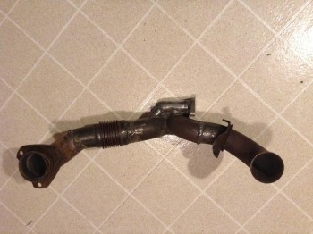

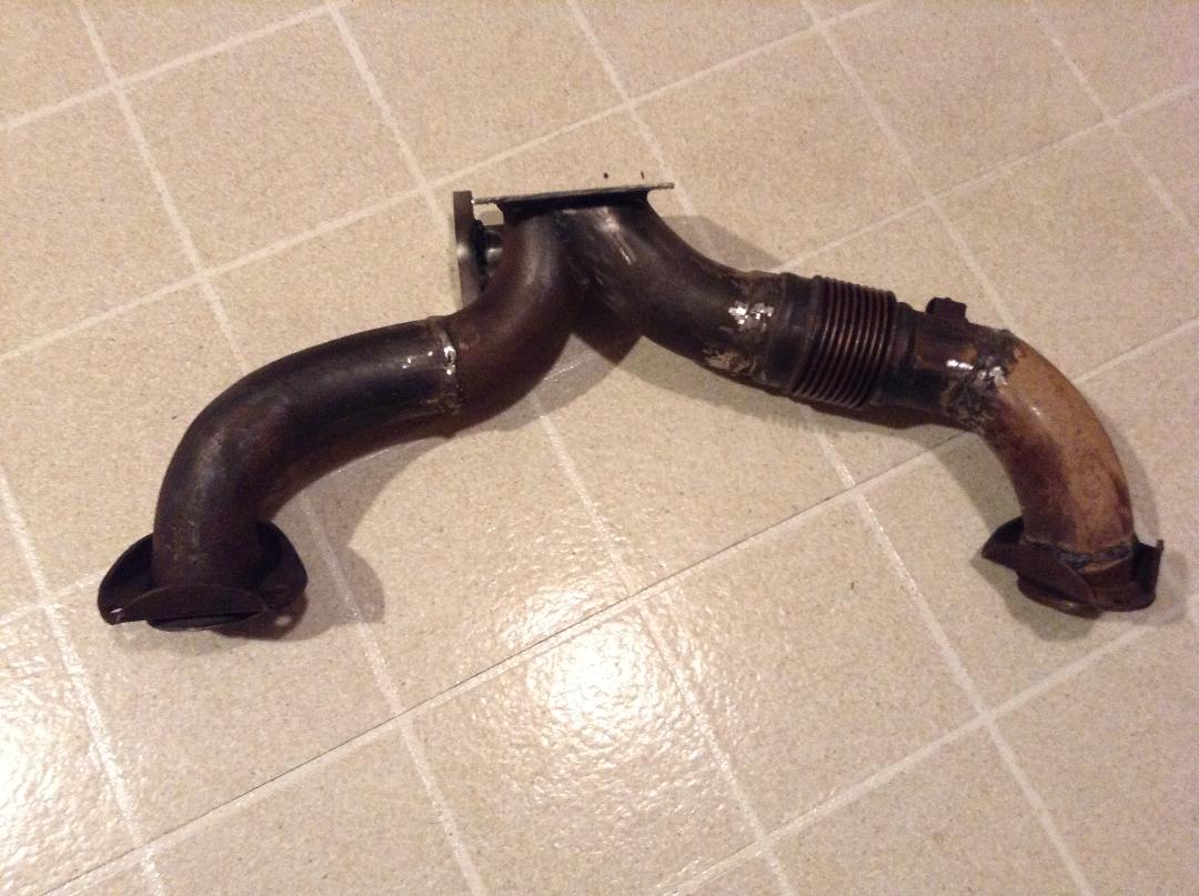

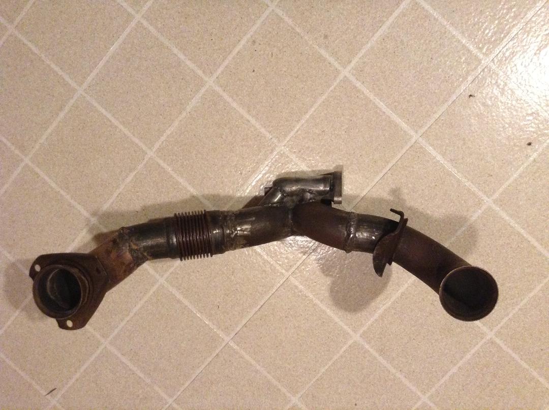

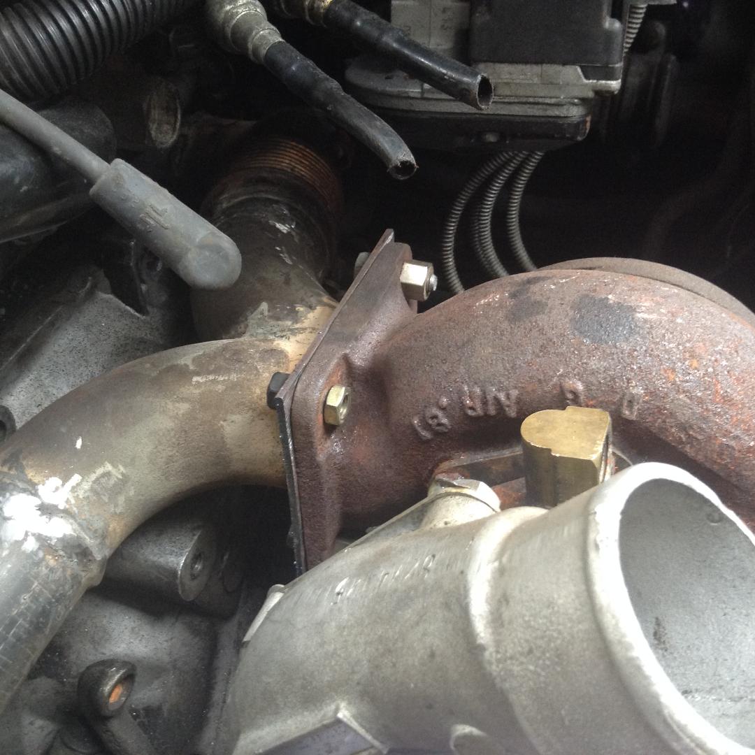

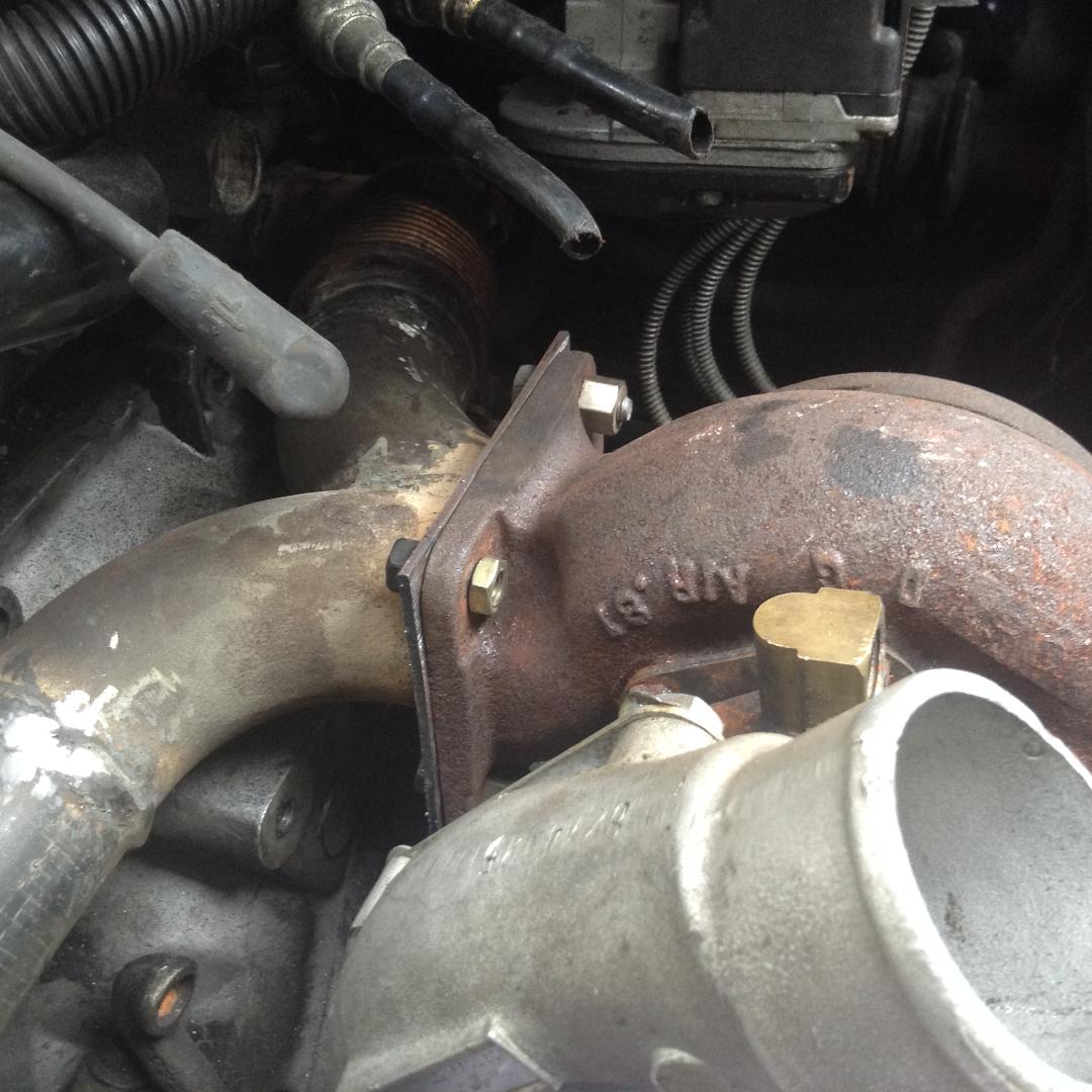

Got the crossover pipe built today, except for the T-4 flange and outlet for the external wastegate. My Garrett T-04 has an offset angled inlet: the front part of the port runs straight into the housing, but it has about a 45-degree sweep-in at the rear of the inlet, so I used a 90-degree elbow from the front bank directing flow straight into the housing, and the rear bank angles in to let the housing turn the flow. It was a little trickier to build, but I think it will help to keep both banks balanced (at least at some RPMs) and still allow me to push the turbo forward a bit more to give more space for the intercooler. It will definitely flow better this way, and far far better than just chopping a hole in the side of the crossover pipe would.
I haven't 100% decided on just wrapping the crossover pipe, or if I want to modify and re-use the factory insulated heat-shielding.
Edit: Finished the flange today, and snapped a few pics. Remember, this is 2.25-inch pipe GM used on this thing, from each bank!

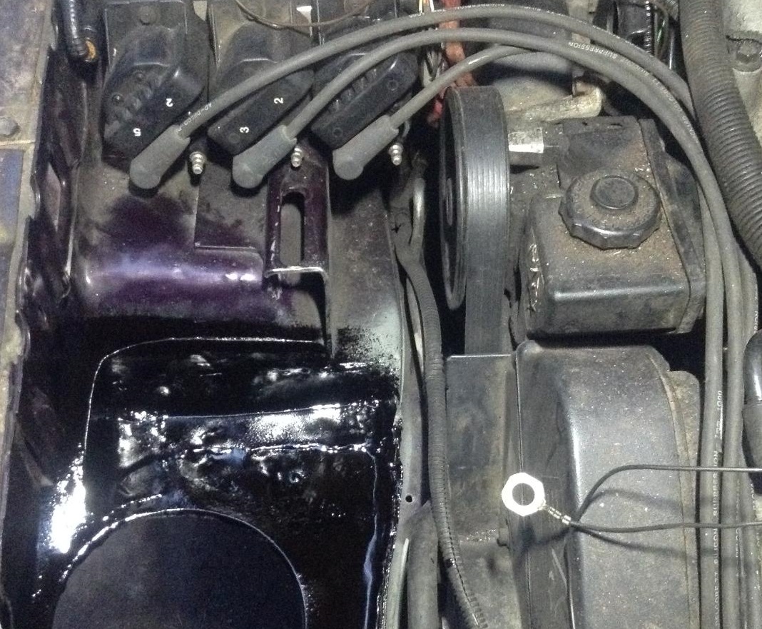

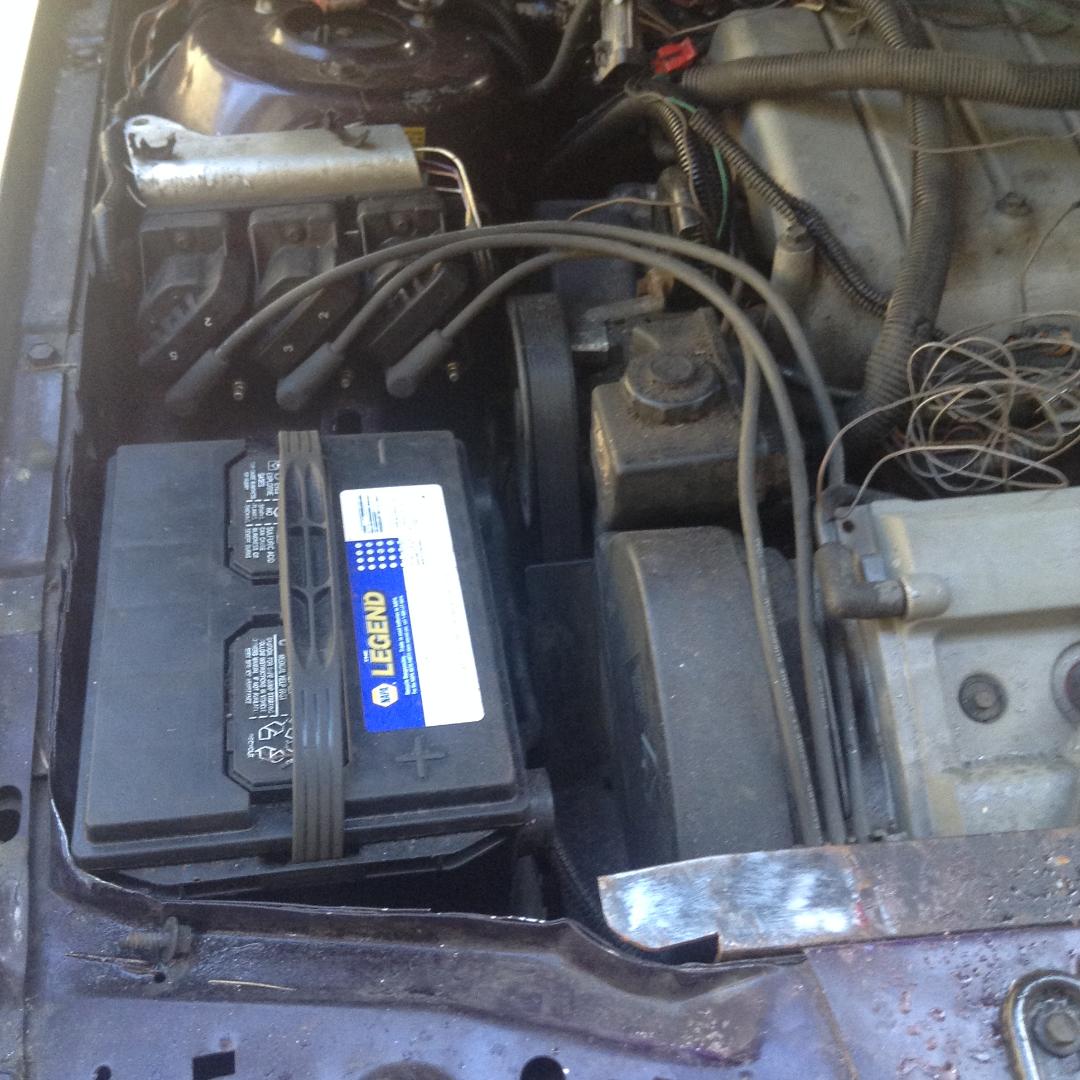

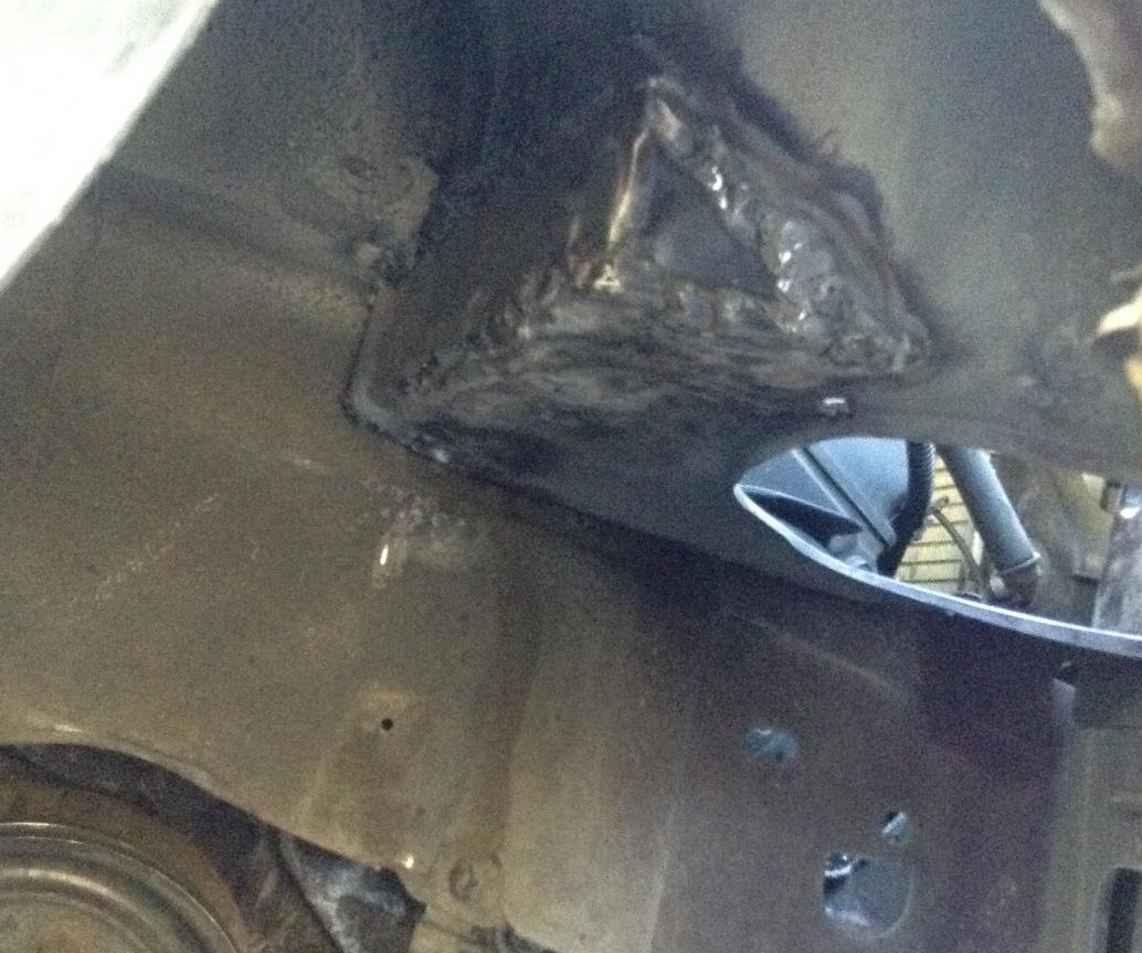

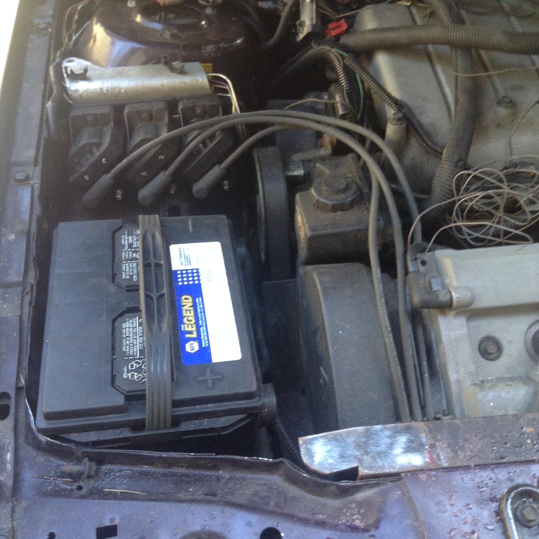

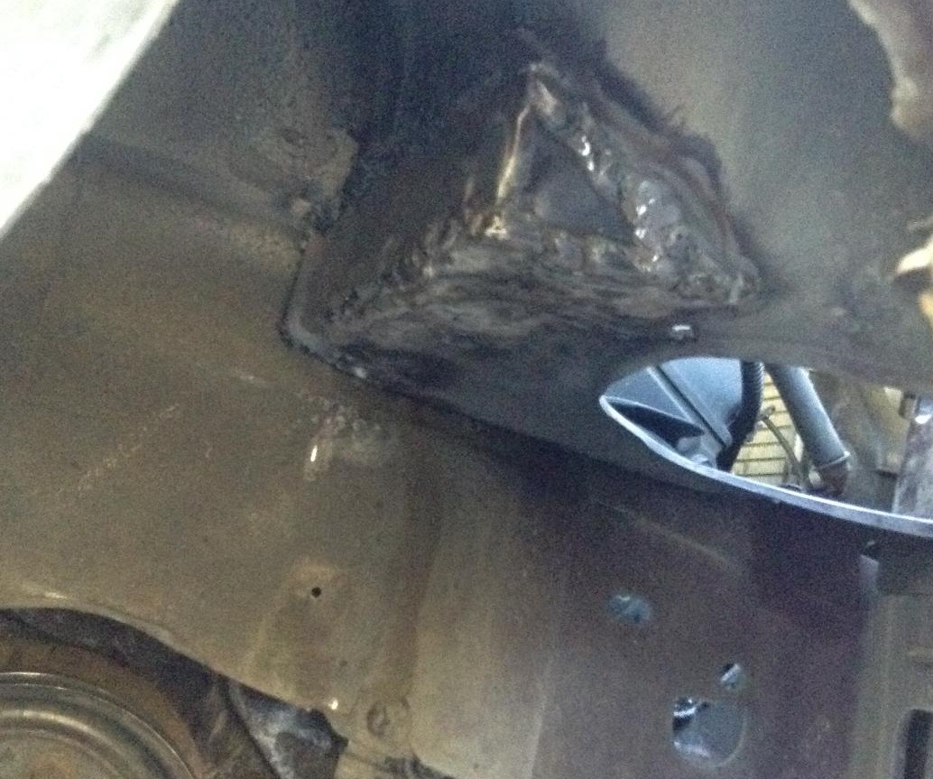

Battery relocated! The right side of the car is shaped a little differently in front of the strut-tower, having more of a gradual ramp up to the top of the tower. The left side has a steeper ramp up because it starts farther back, to leave a long flat spot for the battery. I love the idea of transferring weight to the rear of the vehicle for better weight distribution, but hate the idea of having to run massive cables the whole length of the car. So, I modified the space in front of the right strut tower to allow enough room for the battery to comfortably snuggle in there. I still have to place the coolant expansion-tank elsewhere in the bay, but I don't see much trouble there, and may even do something cool for it instead.
I started out building an actual battery tray out of stainless steel, but it is such a tight fit it just caused problems. So, I just grafted-in a small corner piece instead. There was about a 1.5 inch gap created in the steel, to give an idea how much the metal had to be moved to make room for the battery. Given the usual corrosion issues that batteries cause, I am glad I listened to my own complaints and upgraded to the stainless for this part. I then primed the whole area, and topped it off with rubberized undercoating. I also applied a generous coat to the underside, where it could be exposed to water. I am actually pretty happy with how this all turned out.
Still working on the wiring, as can be seen here. I am spending a lot of time intergrating the two harnesses, in a way that doesn't damage either one or make permanent changes to the car's harness (the original tape is removed, yes, but that doesn't count). The hardest thing to overcome is the different styles of bay-to-body main connectors -the Z-34 uses rubber gasketed connectors, like the connectors used on the sensors in the Berettas' bays, but the Berettas have slightly different main connectors -no rubber boots sealing the wires in the back of the plugs, instead the whole connector is covered and packed with black tar-like dielectric compound. Makes a huge mess, and is a pain to work with. And we all know what happens inside the car when that compound gets old and cracks... More on the wiring later though... Then the exhaust build comes up after that.

Yeah, those main wiring bulkheads are such a piss poor design. Makes dash work such a pain in the ass because I got it all sealed up and decided not to separate the connectors.
I like the battery relocation. I wanted to do something similar on the pass side bit decided not to cut it up when it was already so "finished."

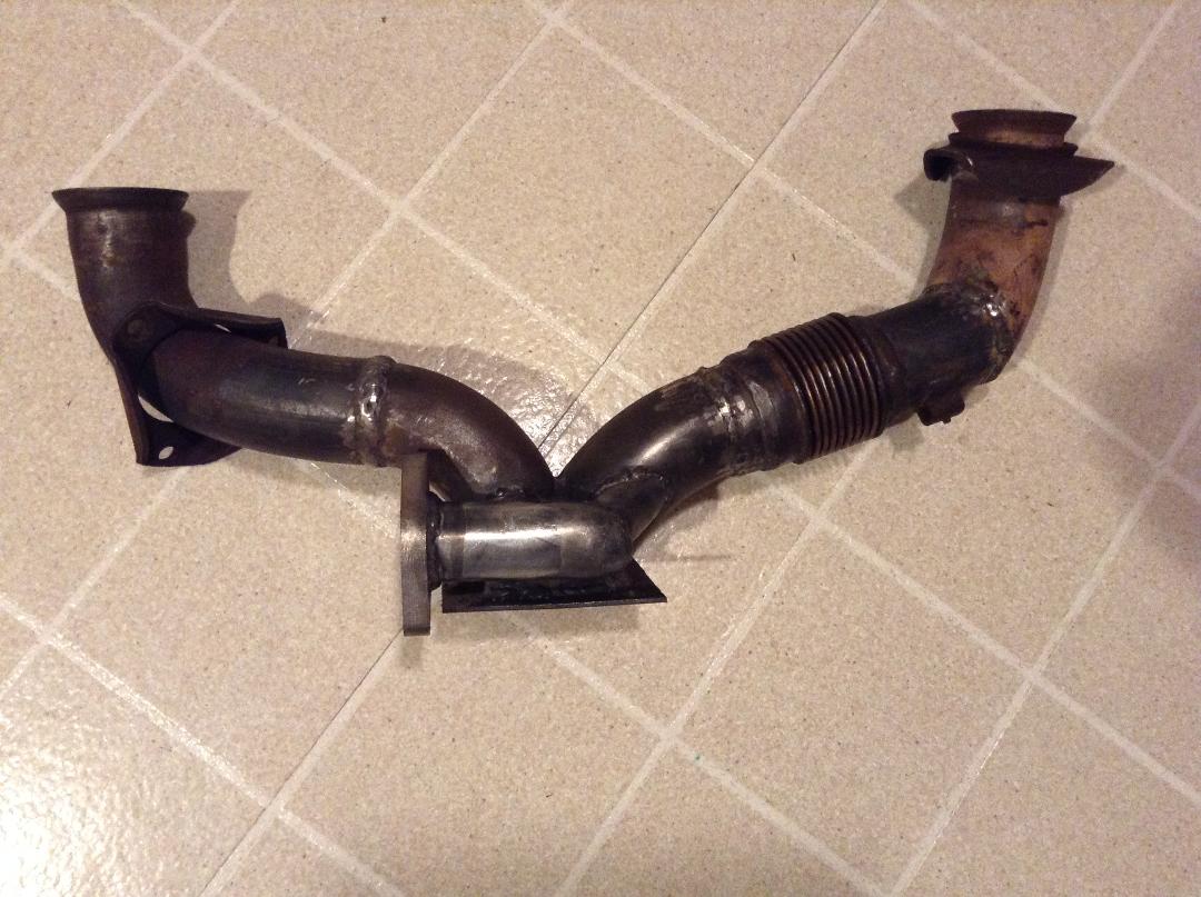

Finally took enough time today to finish the external waste-gate supply-pipe from the cross-over pipe.
I really didn't want to chop into the joint of the two banks as they come together and into the turbo as it just seemed like it would effect the exhaust flow, especially from the rear bank. So, I decided to draw individually from each side of the joint. I am really happy with how this turn out. Now if just needs finish cleaning, paint, and thermal wrap. I must say, adding the external waste-gate is a PITA -it is a good thing that I am deleting the coolant pipe running from under the throttle-body (I have no need for a TB heater, thanks) to the coolant outlet by the water-pump. Not only does it clean the engine up by removing pipes running half way around the engine, but it adds over one inch of clearance to the front cylinder head in front of the throttle body, so the waste-gate actuator valve has enough room. Now, running the pipe for the valve's outlet will still be tricky, as the clutch slave cylinder sits right underneath the valve, and my outlet points down towards it...

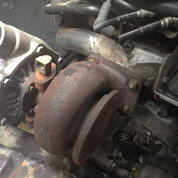

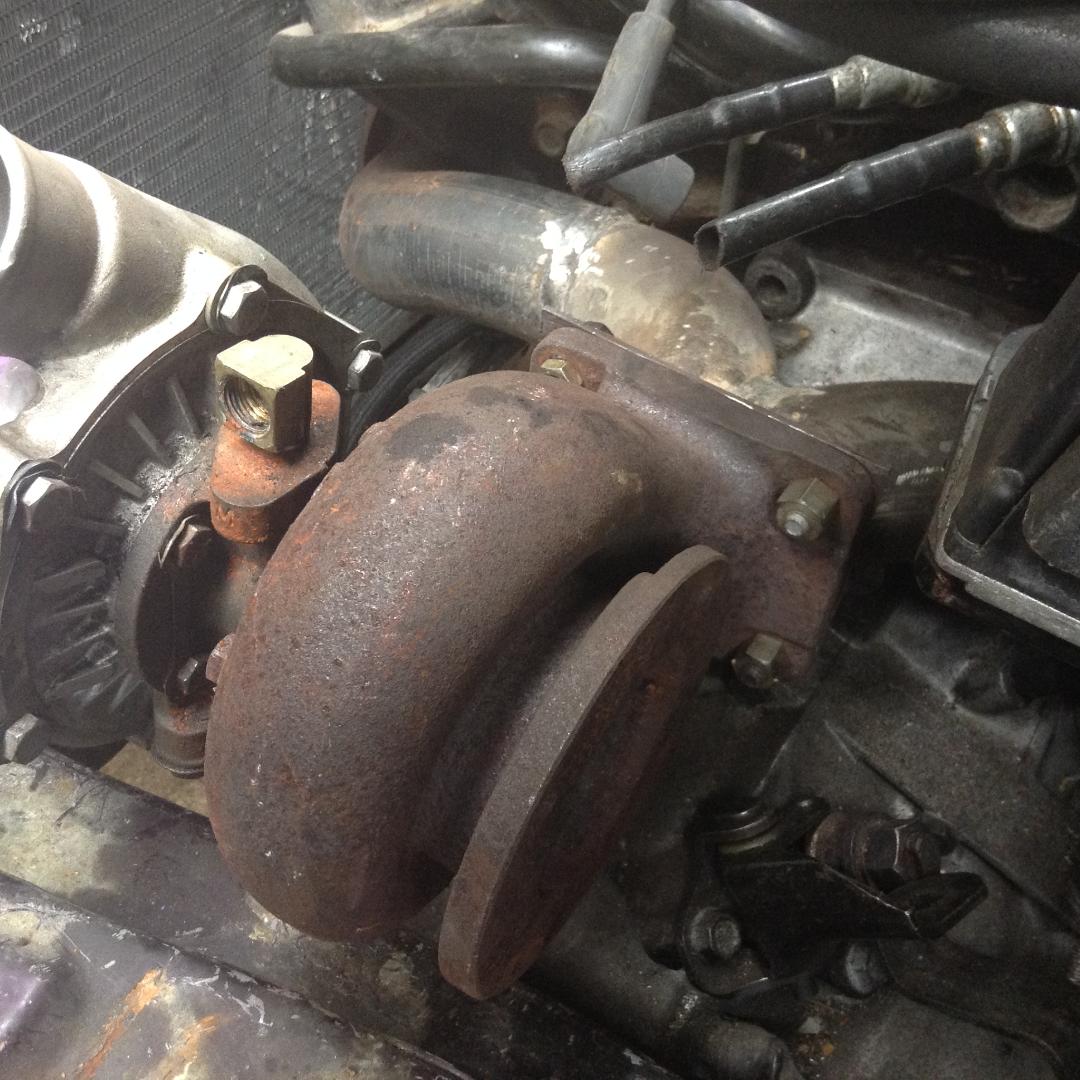

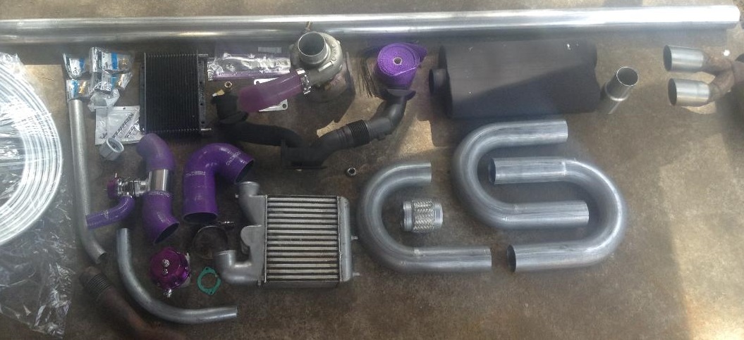

Snapped a quick pic of the exhaust parts and turbo pieces. I had intentions of running two 2.25-inch pipes out of the muffler (single 3-inch in, dual 3-inch out, would use a pair of reducers like the one pictured with the muffler to bring it down. A single 3-inch pipe flows more than two 2-inch pipes, btw, so I was going to go 2.25-inch to keep restriction out of the exhaust) over the axle-beam, then to the rear as semi-duals, but the muffler body is too long to fit in the catalytic converter cavity, so the exhaust will just stay 3-inch single to the rear, with the muffler mounted in the stock location and splitting from there (I waited to buy the smaller tubing because I wasn't sure the Flowmaster would fit). My old '95 Z-26 will be donating its' exhaust-tips (slightly reworked to mirror the stagger originally present), so the car will have four total outlets, with a factoryish look. Not certain what I will put back on the old Z yet -I would like to use a single large rectangle, but I'm not going to put any money into it right now, it runs and drives nice but needs so much work I'm not sure what I'm going to do with it yet -that is for another thread though.
I am overall really happy with how tight the intercooled intake setup is. It all stays inside the bay, nothing running back and forth across the car, nothing in front of the radiator core-support. Clean, short, compact.
Yes, the waste-gate, bypass valve, and silicone intake fittings are all purple, as is the exhaust wrap and even the silicone radiator hoses are purple -hey, the car is Black Rose Metallic, which is really just a super-dark plum color, so it fits.

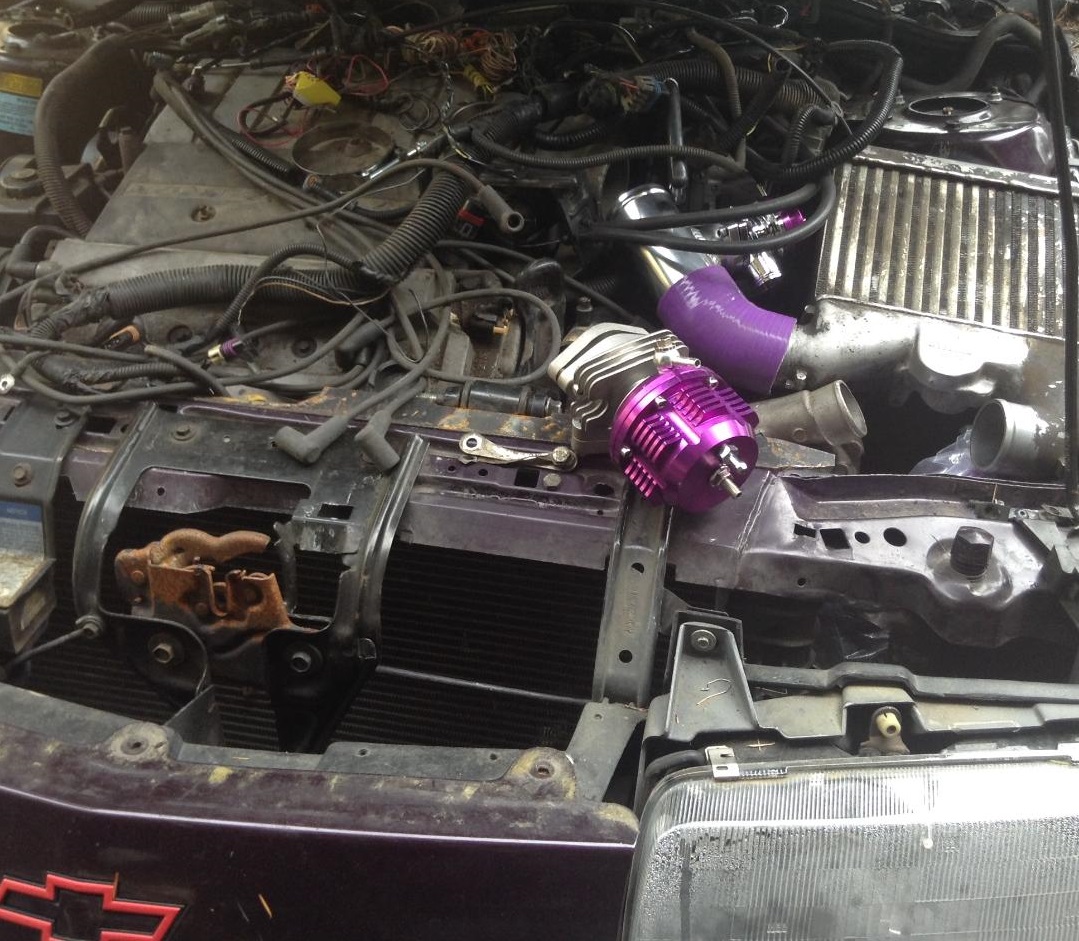

The intercooler is not in front of the radiator? I am interested to see how you had space for the intercooler in the engine bay.
Re: Finally...
Yeah...definitely interested in the setup as well.WhiteGTZ wrote:The intercooler is not in front of the radiator? I am interested to see how you had space for the intercooler in the engine bay.
Re: Finally...
Remember where my battery USED TO sit?WhiteGTZ wrote:The intercooler is not in front of the radiator? I am interested to see how you had space for the intercooler in the engine bay.
This particular Blackstone intercooler has a small footprint, but a very thick core, so still gets a decent Delta-T despite its' size. I'm not going to be running high boost levels, so I'm not too concerned with having a massive intercooler either. The biggest problem of course is feeding cool air to it inside the bay. If you know how I set up the ram-air on my '90 Turbo T Beretta, that will give you a sneak-peek as to my solution here too...
It was a bigger issue to fit an air filter in there with this thing and the required MAF. I really didn't want to run a 3.25-inch intake pipe in front of the wheel-well splash-guard and up in front of the radiator (or under the headlight) just to place an air filter or air-box in a semi-accessible location, and I wasn't going to put an air-filter directly in front of the splash-guard where it can't be serviced without removing the wheel. I wanted this all in one place with as short an intake run as possible into the turbo.
Come to think of it, this is the second time I've put an intercooler under the hood of a Beretta -back when my '90 'Retta still had the LG5 and its' original T-25, I relocated the battery behind the engine nestled into a customized heater-duct plenum, and stuffed the intercooler in that spot. But the air filter was a tiny K&N cone clamped straight into the front of the turbo, no MAF, no external waste-gate, no BOV or bypass valve, and the biggest pipe was about 2-inches in diameter. That thing spooled at 1800 RPM, and was an absolute kick-in-the-pants fun to drive though. The FMIC it has now is definitely a better way to go for that particular car, but yes, it has intake piping running back and forth across the front of the car.
So yes, not only can this 3.4 DOHC fit in the Beretta bay, but it fits with a T-04 turbo, an intercooler, ALL of the intake ductwork and air filter, the ECM, original cooling fan, retains all of the ABS system, AND still keeps the battery under the hood!

Thats pretty cool how you mounted it. I'm interested to know how well it will work based on engine bay temps, do you plan to vent the hood in some way for air flow?
I've been debating on doing a 3400 swap or a cheap turbo on my 3.1 sunbird, seeing your car makes me want to turbo my 3.1 sunbird. lol
Re: Finally...
DO IT! Forced induction = fun.WhiteGTZ wrote:Thats pretty cool how you mounted it. I'm interested to know how well it will work based on engine bay temps, do you plan to vent the hood in some way for air flow?
Essentially, there will be a divider between the intake/intercooler and the turbo/engine-bay to keep heat away from the Intercooler.
The Intercooler will be cooled by air supplied from the high-pressure air in front of the radiator which also passes into the fender area in front of the splash-guard then up through an OE hole about 3.5 inches in diameter, about where the battery originally sat. It will also get fresh air from a 280Z Turbo NACA-style hood-scoop (like the one in my '90 'Retta's hood). That hood-scoop will also provide the exit for the heated air that will naturally rise from the Intercooler. A little foamy weather-stripping should help control the airflow well enough to let the Intercooler do its' job. All this nice, fresh, high-pressure air will also feed the intake air-filter, yielding maybe another 1/4 HP at 287 MPH...
The hood on this car looks nearly perfect though, so I won't be chopping a hole in it. Instead, my old Z-26 (also Black Rose Metallic) had gotten a replacement hood from a '96 Base, then last year before I was able to get the car back home, a major hail-storm dented it up a bit. I will still try to make it look good, but I don't feel quite as guilty cutting a hole in that hood. The 280Z scoop is beautiful, and fits our hoods' contours nicely. I may even install the non-scoop vent from the other side of the 280Z's hood on this car, despite the fact that it will be just for show.
