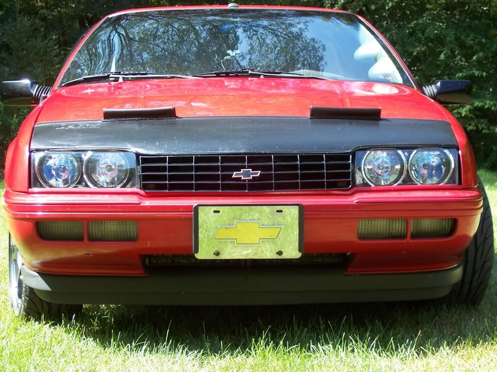

LOL, you mean these?
I got them from E-bay, I can't remember the name of the style, but they have a LED halo.

This is similar to what i bought, but I got the ones with the BLACK housings inside i cant find them... Only where the bulb is has the chrome.

Yah I tried looking for them too and couldn't find an exact match. I find it funny I ended up getting something from you through someone else =). No offense but I this particular set looks better on my car
LED Halo isn't perfect but it looks pretty darned good at night. CCFL would be epic but I like these, nice and simple.

Why do you think I sold them... LOL Right now I have just the stock E36 ones on there.

They definitely look better with a black car or at least a black eggcrate, cause I couldnt get them to fit worth a crap!

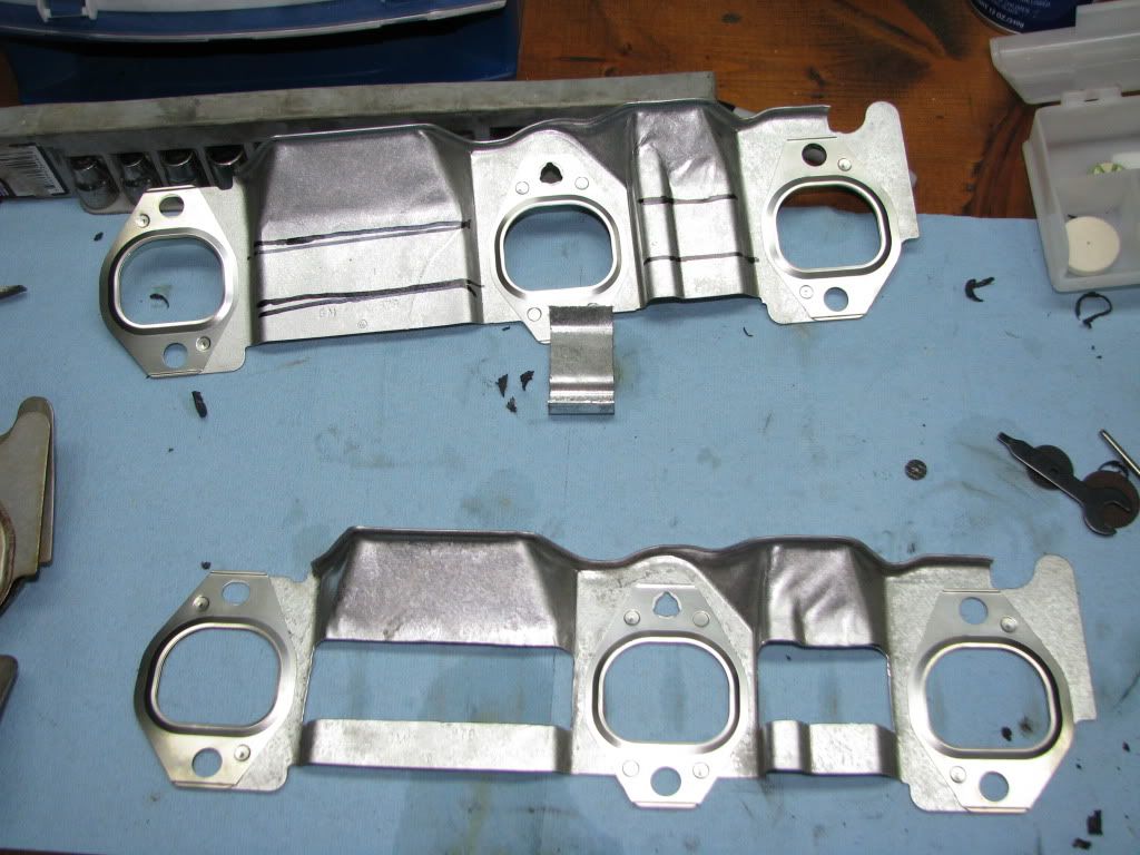

wow where did you buy those gaskets from? They are simply cutouts of the factory gaskets.
I like my version MUCH better, I retained the stock heat shield.

I could have done that too, but i probably would have had a lot more scars on my hands from installing the header lol.
I like your way too, but mine works just fine. That would have made it easier to install the gaskets though haha.

I might use the metal gasket this time around too just for shits & gigs.

Just make sure to double check the raised part of the metal gaskets to your flanges, I have one spot where a weld took some of the flat area away and it's RIGHT next to the sealing part of the gasket, so I need to try and wiggle the header UP and the gasket down when I bolt it in to get that port sealed... OR fill in the dimple and have the flange re-shaved.
I did mine that way with a dremel, worked like a charm and they drop on the flange and stay in place when installing

Yeah that is handy dandy, it's a little annoying to get them lined up when you don't have help. Thanks for the advice =).

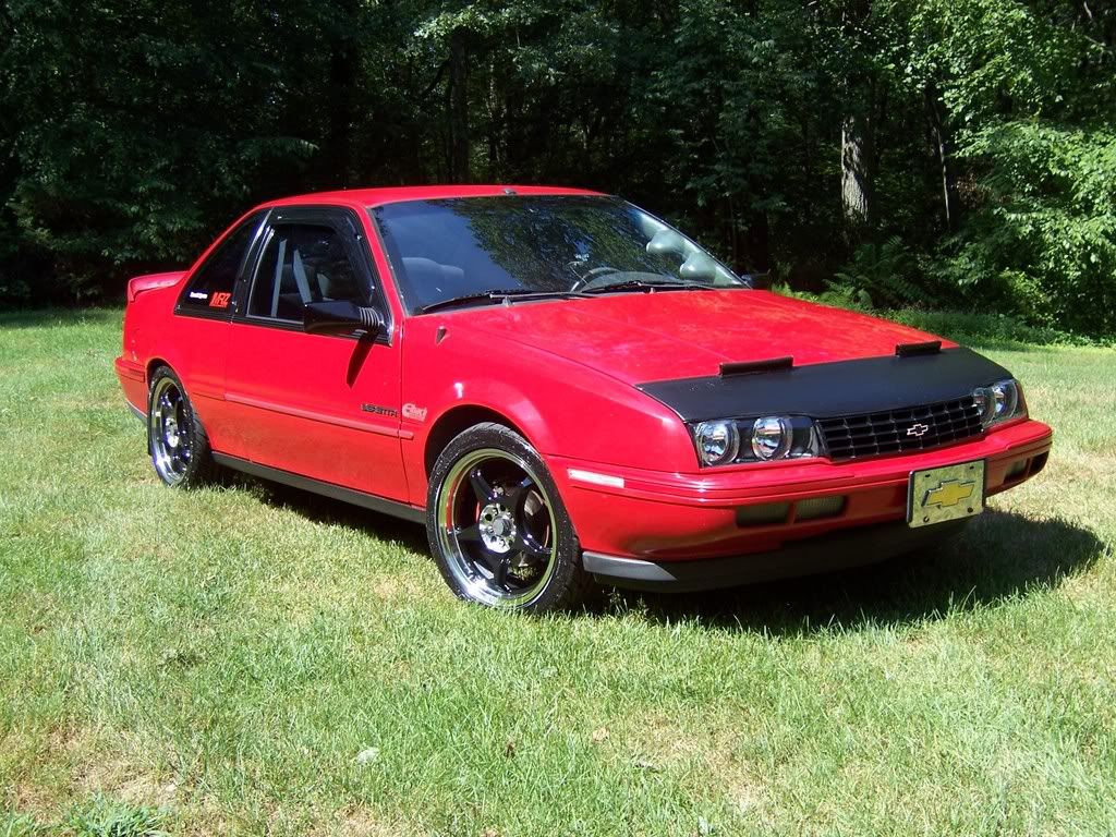

Alright, here is a new picture.
As far as updates: Plans are in the works for a new transmission. She will also be getting at 65mm TB this spring. I also have another upgrade planned, but it depends on a few things that I'll have to look into next time I go see her.
