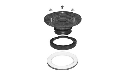

Anyone ever get pics of the 88-94 upper mount? I bought the KYB/Eibach assembles in my car from "FlatBlackTerror" Mike and judging by the 95-96 pics and the old mount pics on rockatuo, etc...it looks like I have a 95-96 mount without the angled spacer. Driver side one is shot. Positively identified it as my steering creak when I unhooked the tie rods.
old:
new:
And according to Jon's assembly pic here:
vs the pic of my strut I just pulled out:
it definitely looks like the angled spacer is missing, which I'm sure contributed to the early death of the mount. According to Mike, the springs & struts only had about 10k miles on them when I bought them.
So here's a question. Are the 95-96 mounts superior? If they are I should be able to buy a new pair and use them with my 91.
And another question. Would using a 95-96 mount give me more wheel gap than a 91 mount in a 91? The older mounts sure appear to be lower profile than the 95 stuff.

Not sure on the second questions but I like the design of the newer mounts, and that spacer is definitely missing and it looks like your insulator parts warped as bad as mine did... I actually grabbed the oem ones from my 96 and put them back in... Shitty part is I think Monroe is the only one who offers replacements on those insulators and if they warp that easy that's crap.

I doubt the two mounts would change the height, but if they did that would be very odd.. The location of the strut mounting never changed car to car... I can only assume the differences were only due to improvements in the type of upper bearing used.
- Posts: 4744
Re: Best strut mount? Kyb?
I did some more digging online and found that the spring cup and isolator are sold separately on the old ones and it looks like that is the difference in height I perceived. And the bearing surface on the newer ones is bigger so that has to be a good thing.

All on its way. Hopefully this will help the handling. I've always been a little underwhelmed with it.
