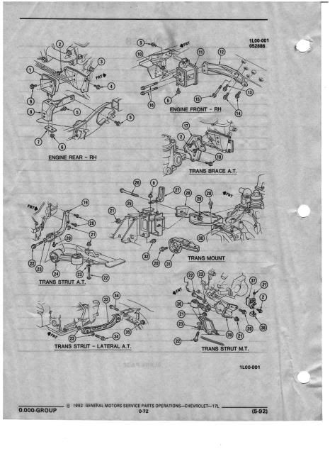

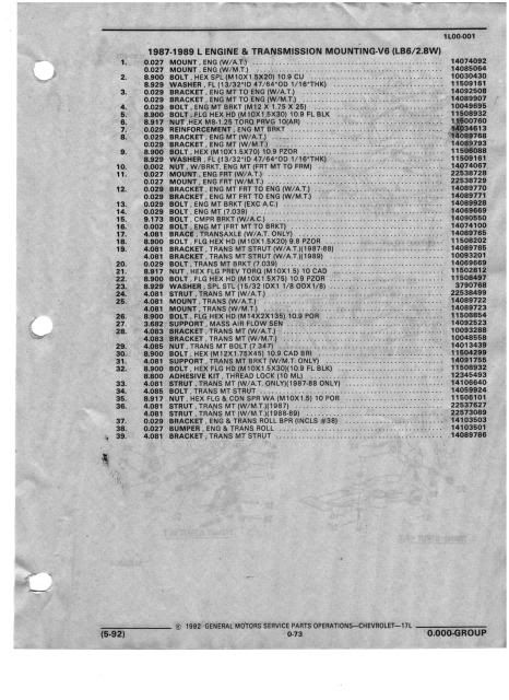

i can look into scanning my document. Here it goes on P/N
Engine REAR RH (this applies to above post)
mount bracket to engine AT 14092508 MT 14089907
upper piece AT 14074092 MT 14085064
lower piece AT 14089768 MT 14089768
There is more....FRONT RH
and obviously the trans mount.
