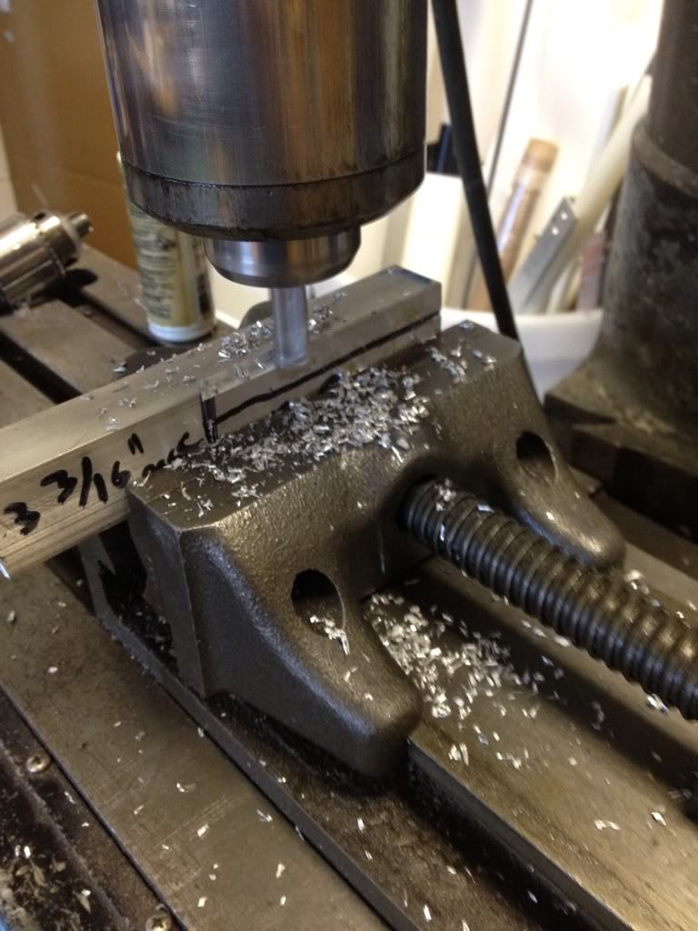

Barry wrote:Yeah it's frustrating. It took me 2 nights just to make custom pedals. Every part I make takes a night and I only get to work on it 2 to 3 times a week
Welcome to my world... Trying to get the race car done is the same timeline... March 30th... and look at its progress. I don't even have a usable body for it yet. OR parts to make it run... LOL Granted we can order everything but I'm stuck with the same work time frame, about 2 nights a week, 3 if we get parts and only from about 6pm to 10pm each time I'm there.
The biggest problem is we don't know what to order till we are in mid project, so we make lists and then wait 3days for parts to show up... Right now it oil lines and ignition that should be in tomorrow and after that it's steering column re-design to clear headers and hopefully sometime next week we'll have a body made up for it... yikes...

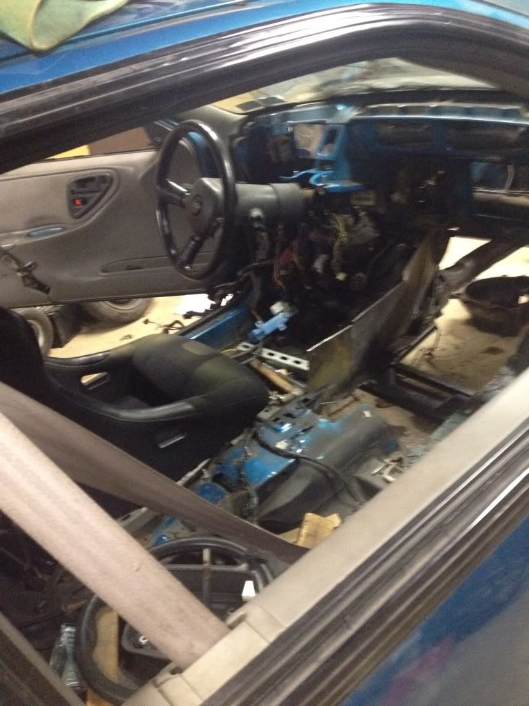

Pedals done, column mounted. Lumina wheel installed. Seat installed.
