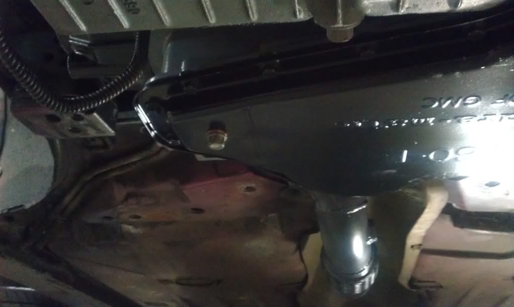

I also FINALLY drilled a hole in the pan for a drain plug... I hope this will work out so I can drain the fluid out of the trans before having to do anything again. That seems to be the biggest pain when I have to take it out or do any work on it like if I want to change the accumulator shims.

Finally put a drain plug on my transmission,
It's also running, it moved forward and backward and cooked on the header paint, ill take it for an official ride tomorrow morning. Too late tonight.
Quad4Z26
Posts: 122
Joined: Mon Sep 05, 2011 9:43 pm
Re: 1996 Mr.Pink
Post by Quad4Z26 »
Forget that drain plug......that's a really shiny pan you got there.
It all looks too clean.... :shock:

DTMAce
Posts: 3510
Location: Michigan EUP
Re: 1996 Mr.Pink
Post by DTMAce »
Hell, you could eat off his engine, its that clean.
Barry
Posts: 1871
Location: Hatfield Pa
Re: 1996 Mr.Pink
Post by Barry »
Did you weld some threads inside that pan I hope?
Posts: 10923
Re: 1996 Mr.Pink
Barry come on.. I just tapped the 1/16 thick pan lol.
There is a nut inside brazed to the pan, it will leave a 1/2" of fluid but at least it won't be pouring out the seams when I'm loosening the pan bolts.
Oh and Ace, it was very clean its actually showing some signs of leaks now I think it's the valley silicone leaking some oil since it's following down the corners of the heads and coating the front and rear of the block, no Signs of the value covers leaking though, so maybe I'll fix it but I'm not that worried.
