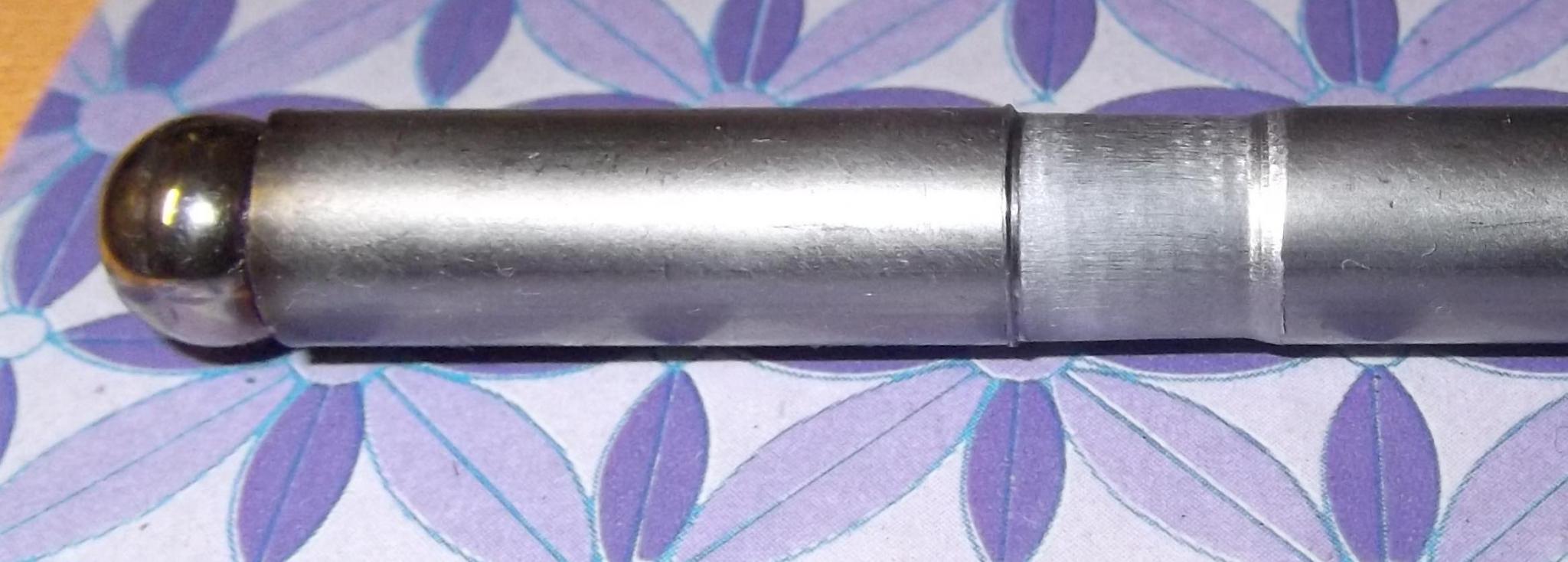

These should have a slight preload on them, you should not have any lash... your running hydraulic lifters.
Stupid question... please tell me those pushrods are hardened...

Well I obviously have my terminology wrong. I always assumed valve lash was the point where the wiggle room on the rocker ended and the resistance came on before I did the quarter turn finisher on them. I stand corrected. (I actually looked up what valve lash was, I wasn't even close).These should have a slight preload on them, you should not have any lash... your running hydraulic lifters.
They are OEM spec pushrods for the 2.2 so to answer your question...probably just regular mild steel. I would assume they are tough enough to withstand the guide plate as that is what they were designed for and my stock ones lasted well over 180K miles. The springs are the same and the engine cuts off at 6400 rpm so I don't really see any additional stresses to warrant hardened ones or any kind of crazy pushrod deflection due to an extreme change in geometry. This upgrade is new territory to me so I welcome all knowledge.
Re: Chevy Beretta FF
Hardened is necessary if you have guide plates... but if they are OEM spec and the guide plates came OEM then they should be hardened.
If they aren't you'll wear right through them. I had a friend who didn't know about that when building his ford engine..... talk about a mess in the motor.
It would look like this after a while.

Yikes! It's like the equivalent representation to what you see at Gyro joints:Hardened is necessary if you have guide plates... but if they are OEM spec and the guide plates came OEM then they should be hardened.
