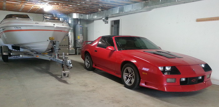

Re: Camaro paint job...after almost 10 years
Looks good! Damn - When you're done with this, you need to come down to Tennessee and help me with my 1991 Z28. I've been so wrapped up in other projects, I've really neglected it since I swapped in the T5.
