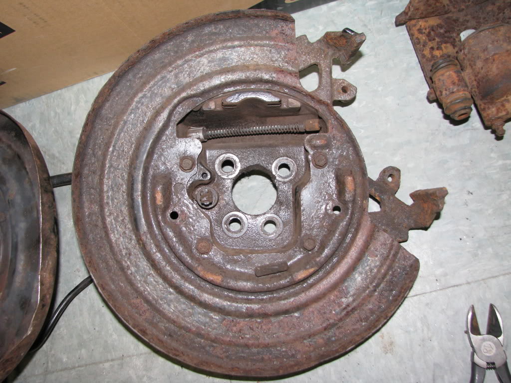

ClonedGTZ
Posts: 235
Joined: Mon Aug 03, 2009 11:02 pm
Location: gilbertsville PA
Re: Neon Rear Disc Brake Upgrade.
Post by ClonedGTZ »
im goin with the lebaron set up, since the backing plate and caliper bracket are one piece, instead of having one made for the car.

Ask the J-body guys really... I found this on their website and went with it. It had the two things I wanted... a 10" rear disc, with a DRUM parking brake.
The 300m is a 5x115 or 114.5mm pattern... Not 5x100mm.
ClonedGTZ wrote:im goin with the lebaron set up, since the backing plate and caliper bracket are one piece, instead of having one made for the car.
Explain your last statment... I had nothing "made" for the car... Only the bracket machined out to fit the bearing. The rest is all factory parts.
Post by Barry »
The neon bracket and backing plate are 1 peice as well...
Posts: 10923
Barry wrote:The neon bracket and backing plate are 1 peice as well...
No they are not... they are two pieces...
Without backing plate installed.
With backing plate installed.
