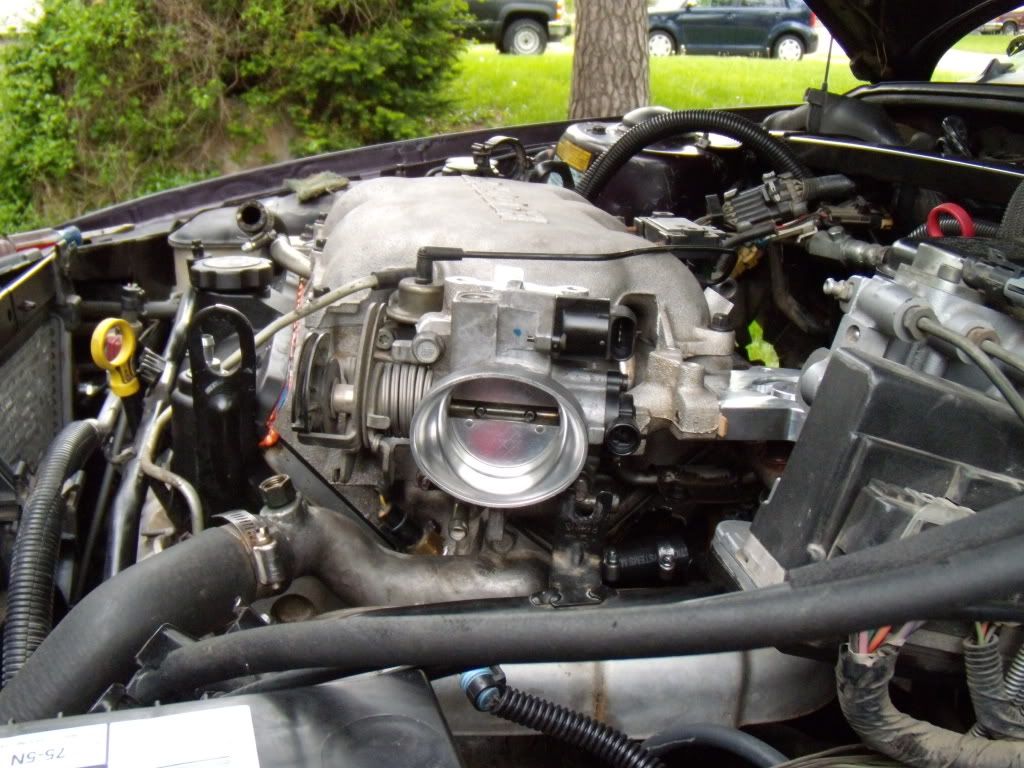

My injector harness is very tight. I don't like this and it makes me think bad thoughts.

What do you mean tight?

Well, you can see it in the first photo. There would be more slack if I didn't have the strut tower bar. I'm going to have to find a way to make this work!

Grab some alum covers, remove the silicone, put it just in the V notches of the covers and re-install.
No idea about your injector harness, you must have it routed wrong. Shouldn't be any different than before.
Re: top end swap ?'s
Yea it's strange, I don't see how it got this way. There are not very many ways that the harness can go. I did try to put it on top of the PS line, but that didn't help. I can't put the alt on the way it is. Right now the harness goes out the back by the PS pump.

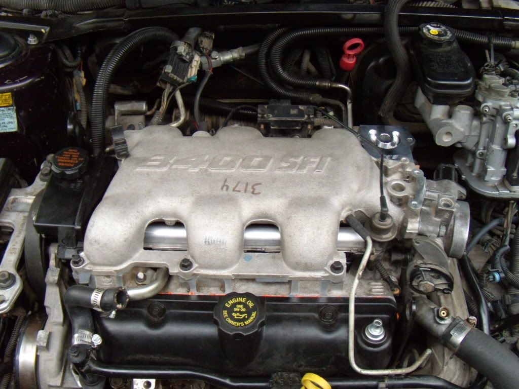

You need to post a picture of where your harness is routed over by the PS pump, I can't see that in the pics you have so I can't tell if its routed wrong.
Checked some old pics and the harness needs to go over the fuel rail, not under. I'm going to take the upper intake off and redo it. I'll keep you updated on this 3X00. I'll get to work now and will be back later in the day or night. There is still many other things to do other than this and I need to get this car back on the road. I'd be done if it was not for having spent so much time on the T-stat by-pass line. Hope that thing seals, the parts stores couldn't find an O-ring that would fit very well.

IIRC the harnes goes out between the 2 runners by the brake vacuum port area as well, in case you dont have it going that way.
Got the upper and the fuel rails off and moved the harness. It is ok now and the car is running again. I now have an exhaust leak. I thought of putting it by the vac port, but it just didn't look like there was enough room. If I had it to do all over again I would have had the lower threaded for the T-stat bypass. I lost a total of a days work screwing with that. The oil has been changed and the cooling system is starting to fill again. When do I need to change the oil again?
