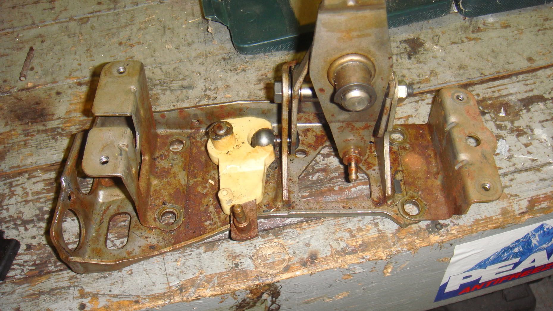

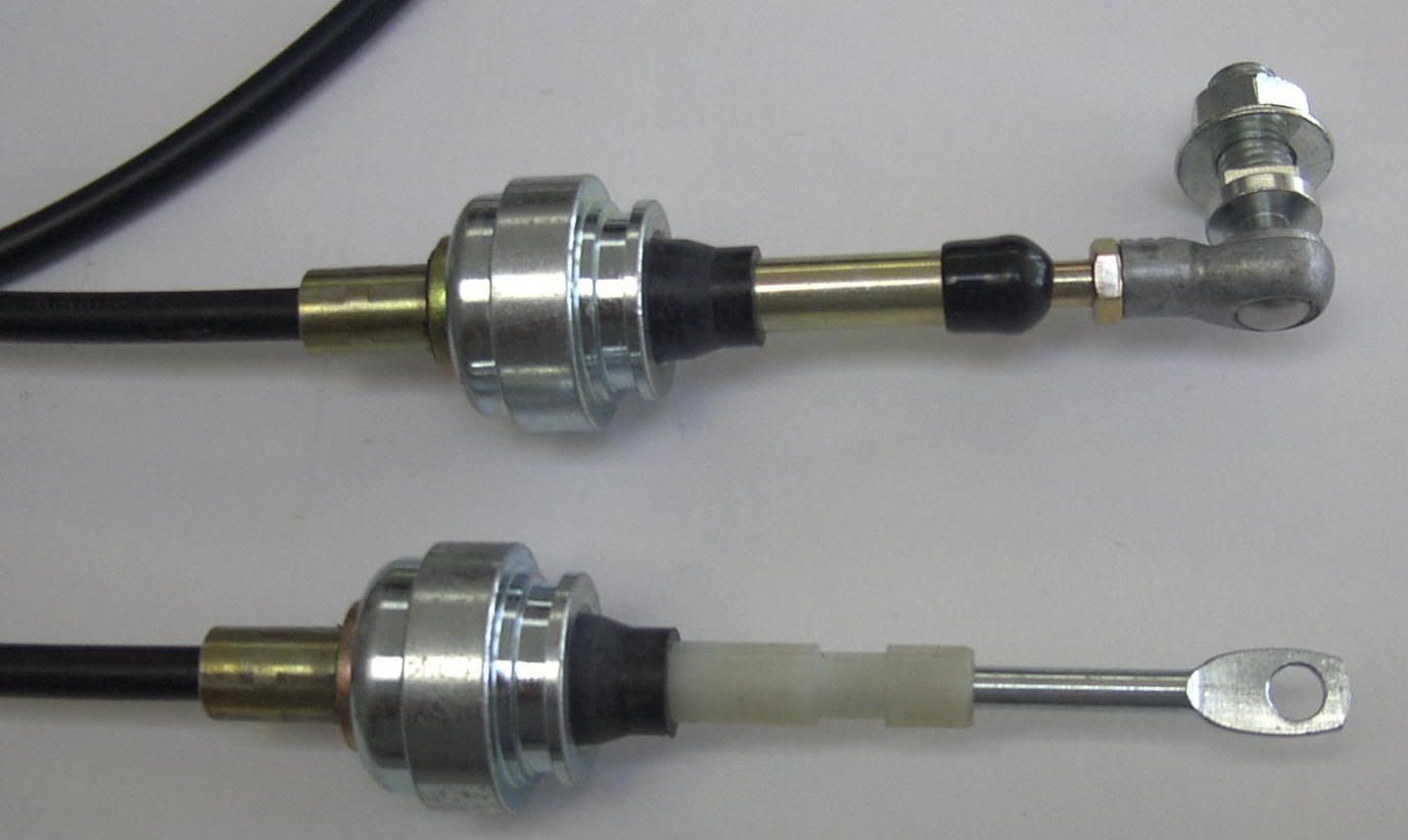

Well I took my old cables off. (91 manual Iz tranny) and went to Inland and they don't have the ends. But if they said they might be able to use old ends. SOOOOO.
It looks like the ends are about 0.250in on the shift and the tranny. In my case on my tranny I had a 0.250in and a 0.316in +/- 0.005in.
I was also looking at the Rodney Dickman's cables.
The tranny side of the shift cable looks different.
But since that pin can be removed and that ball joint put in I see no problem. Just as long as the bolt is not to big then drilling will need to be done.

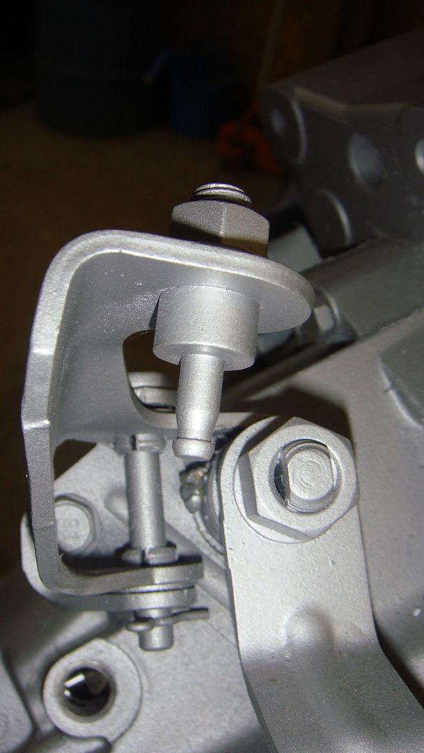

Now the shifter side I see there is a problem.
Not the greatest picture but on the shifter their is no nut on the back side. That is just a note. But also the cable has no bushing in it. So something would have to be done with that. Has anyone try to contact him for a cable and asked him about our problem. I will, but will not order a set due to me having one already.
