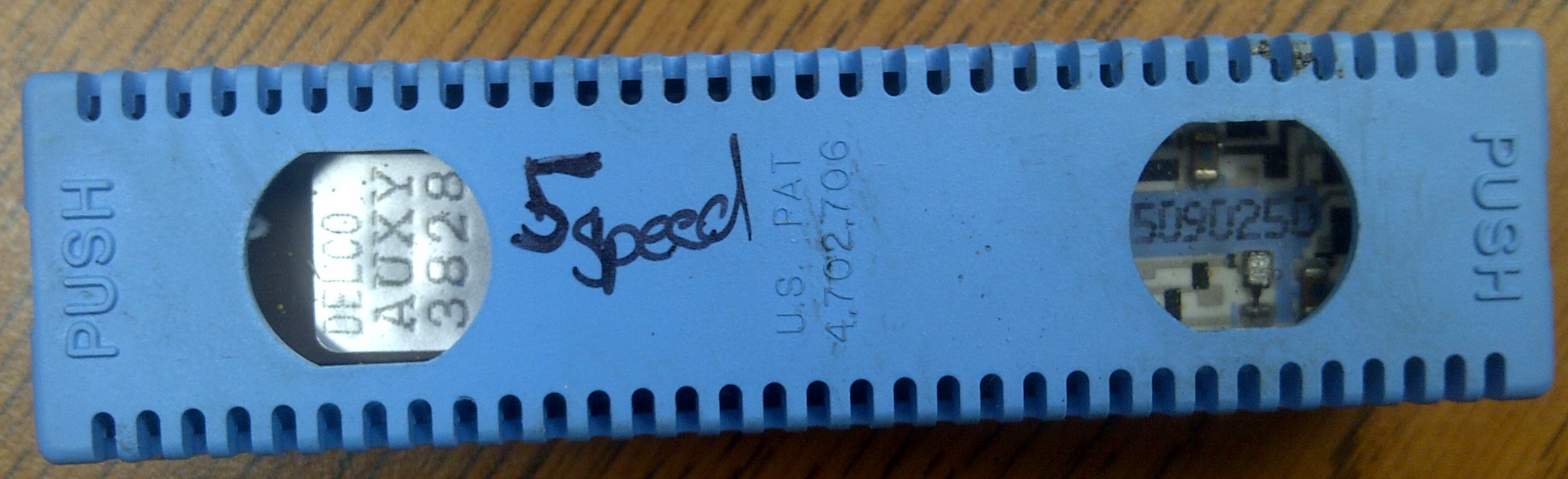

edit: one more question is there any way to tell if i actually have a 5 speed ECU with the tech 1 or scan tool? is there any part number on the actual eprom chip?

Yeah, there's a 4 letter code for the specific prom.

any year with 3.1 5 speed 1990 to 1993? Here is the one that I have, I believe its a 5 speed. Took the car out again today it really does seem to be a LOT smoother and no bucking.

That's the first release for a 1991 with the 3.1 5-speed and federal emissions.
Re: rich smelly and farty
