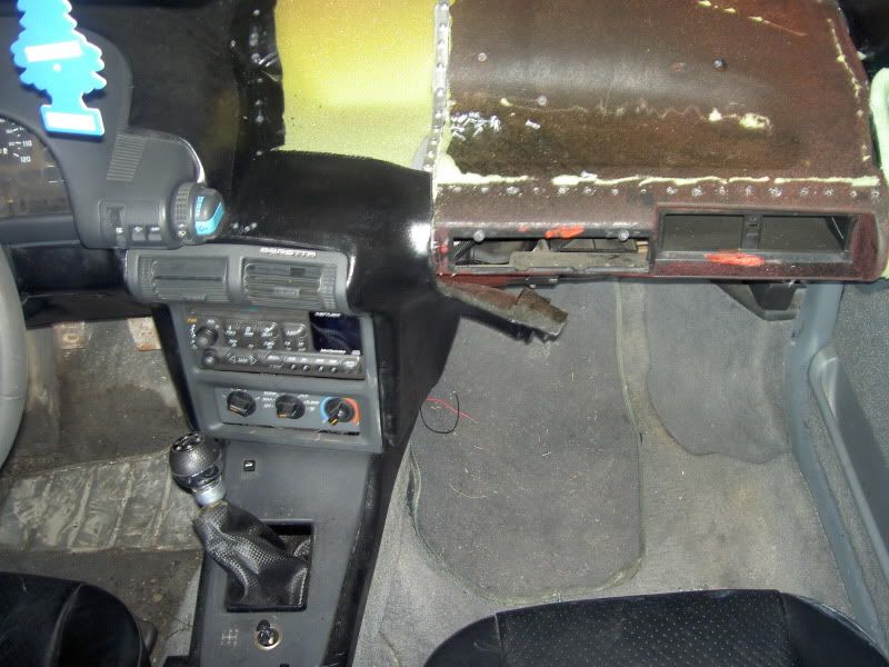

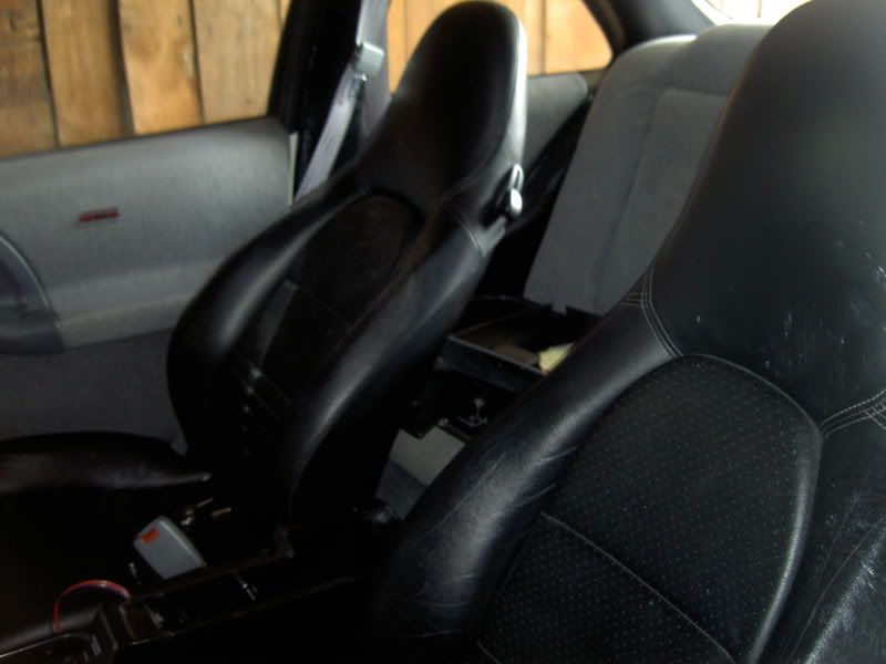

Wow Penfold really did a number on that dash lol. Looks like the Porsche seats at least held up.
Re: project 4444z HELP!!
got some more pictures today, still having problems with the brakes, but heres some pics of the the cars current state, and some of the stuff ive managed to pick up for the car...
as i started to tear the leather crap off, and sheet metal flashing, and hundreds of self tappers later, i managed to find the dash was origanaly a black dash, now its just garbage...
the seats he put in, its going to be a pain to undo everything he did here, and the kick panels he painted black, im hoping i can either get the paint off of them, or manage to find replacement panels, im not having to good of luck though.

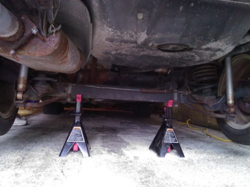

here you can see the rear sway bar, kyb shocks, and eibach springs all in one picture, theres some surface rust under it, probably from sitting in high grass, but nothing major..

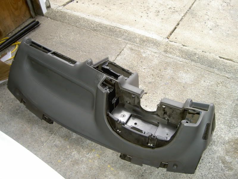

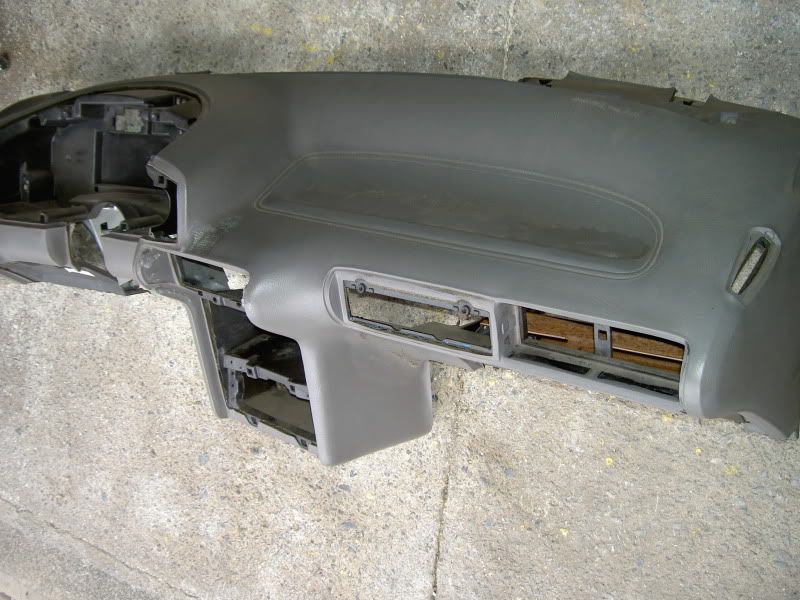

heres the replacement dash i found in a 92 beretta, for those of you who dont know, 93- grey is different from 94+ grey, and makes it even harder to find a dash for us.

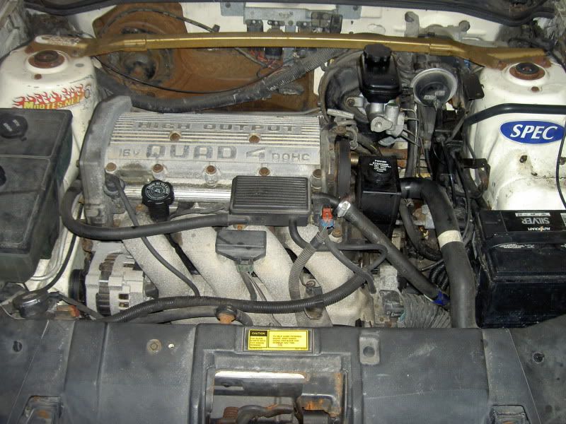

heres the engine, some of you may remember how it did look... pretty rough now, i just changed the oil, its already needing another one... oil is NASTY! i used mobile 5000 fully synthetic with a mobile oil filter...

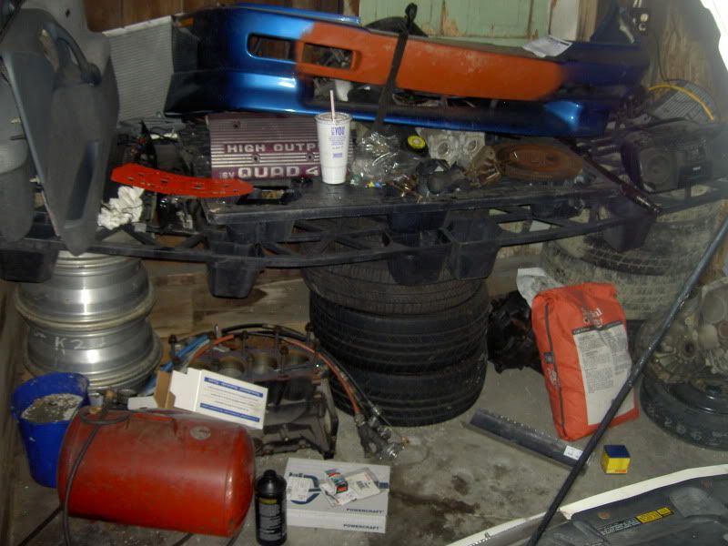

and heres whats in front of the car, 2 transmissions, a spare engine, quad parts, cams, 2 sets of wheels, tires, bumper, and much more...
i just have no other place to store it, my other place is packed!
