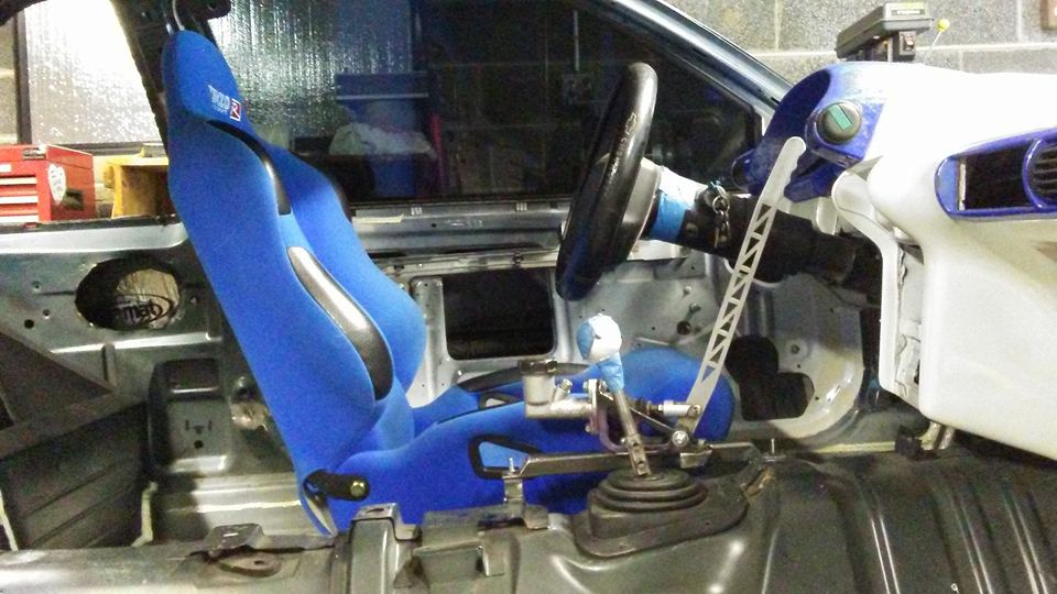

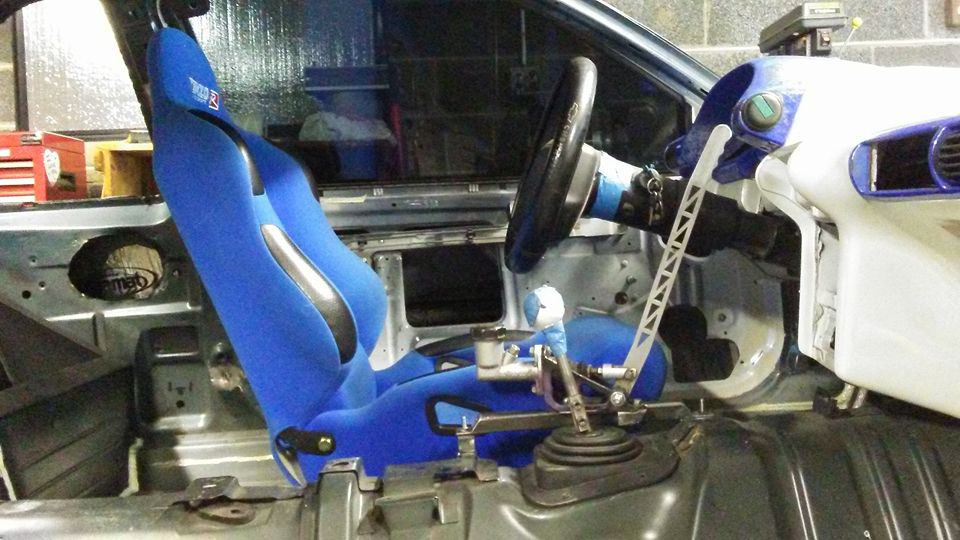

Post by jjanke »

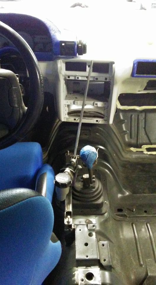

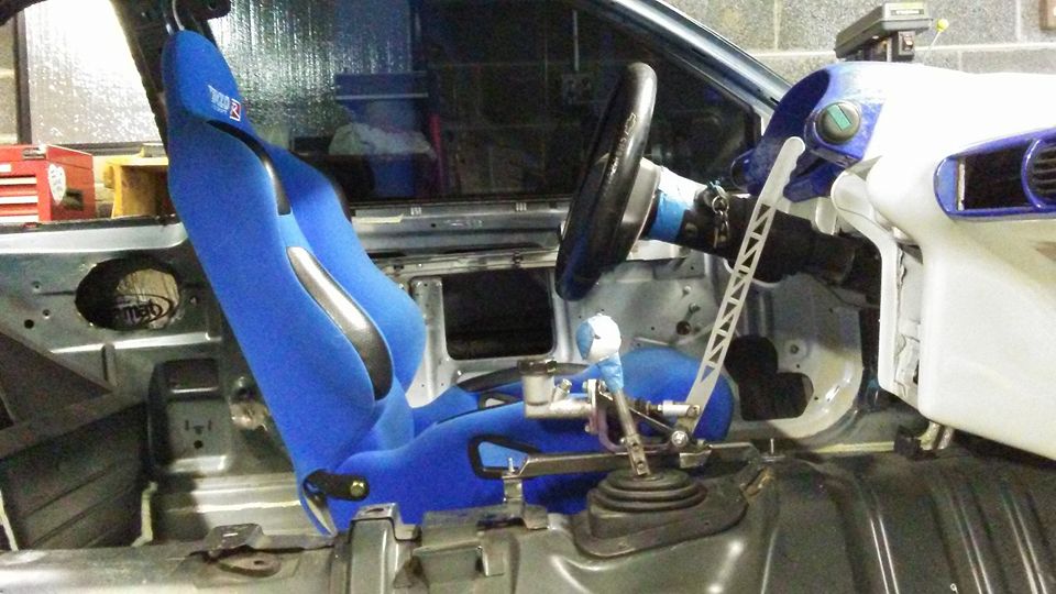

Still got some tweaking to do ....but placement should work well. Hydro E-brake mount done

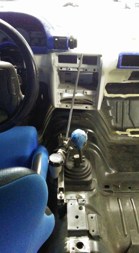

Post by jjanke »

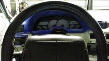

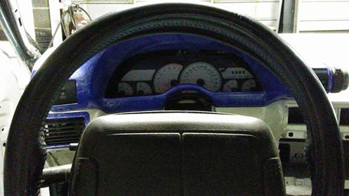

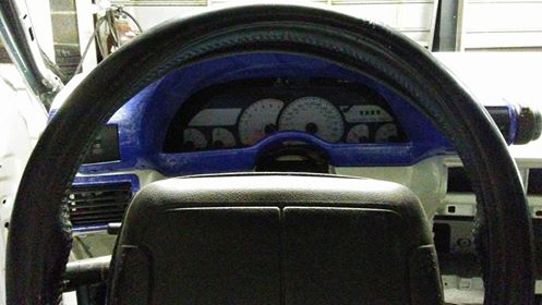

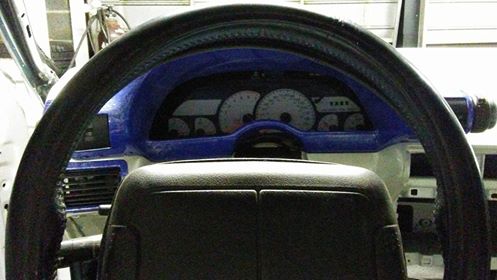

As always If it don't fit ....start cutting ....Camaro Gauge cluster in the Beretta IP/Dash

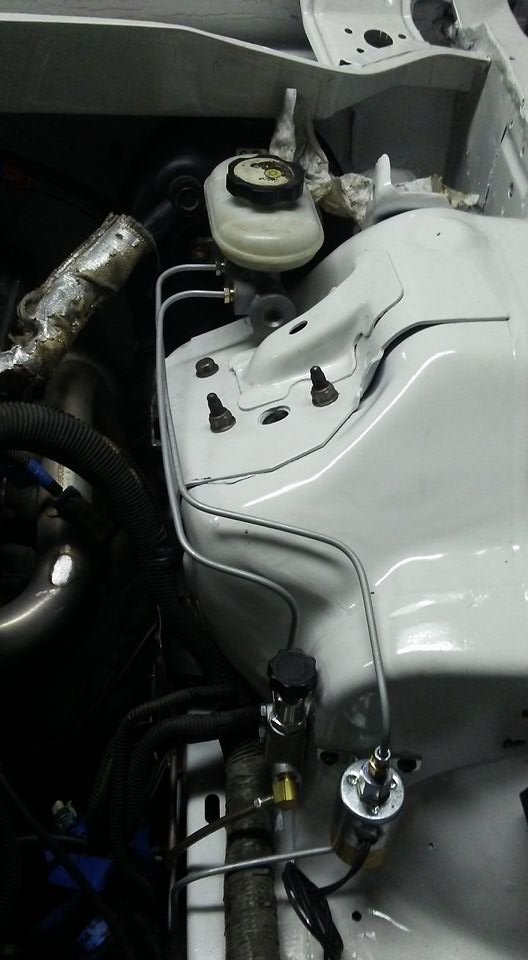

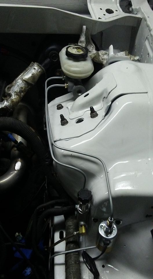

Post by jjanke »

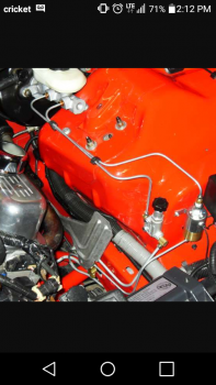

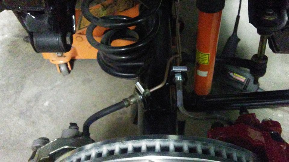

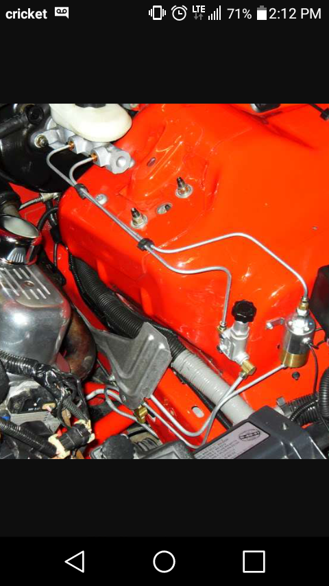

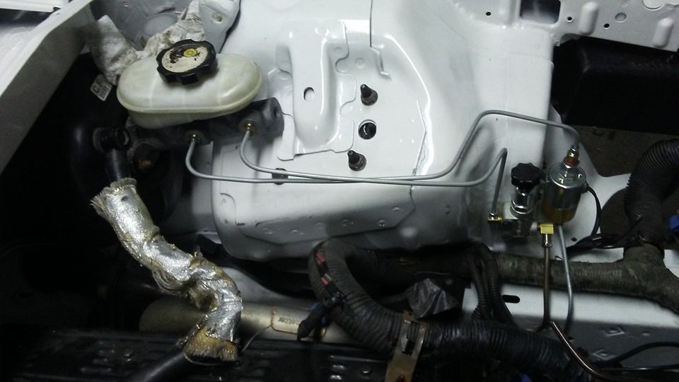

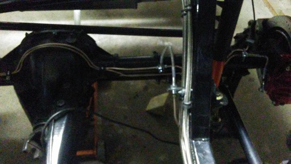

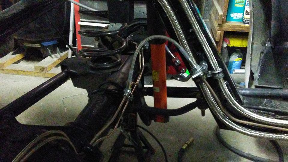

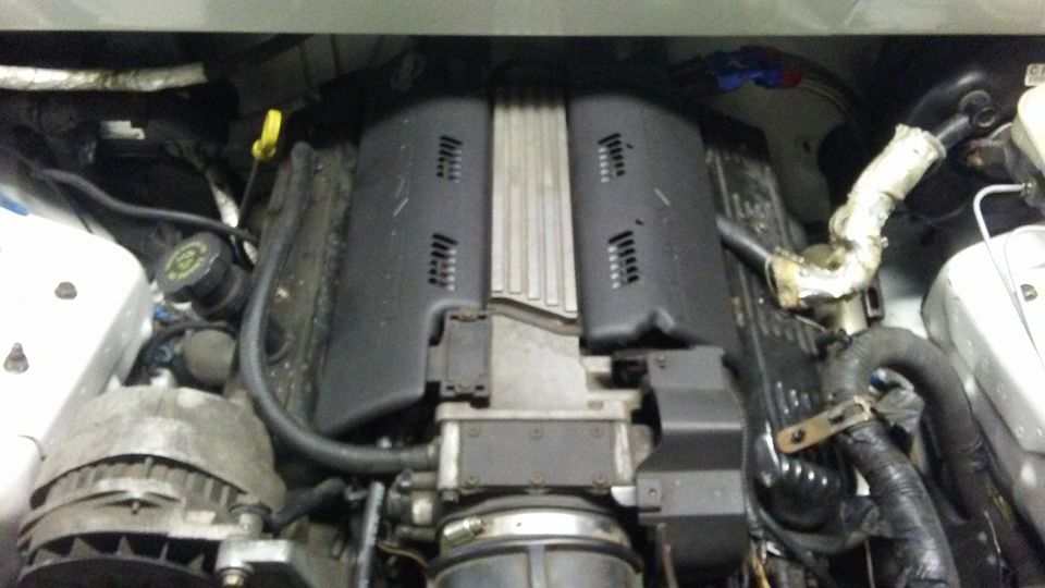

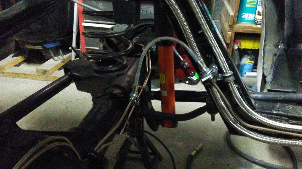

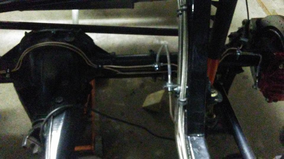

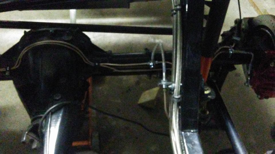

All brake lines and braided brake hoses ran. Abs delete with SJM performance front line lock and willwood rear proportioning valve. Just gotta get fluid and bleed. Also got the Corvette engine covers on to dress/ clean up the clutter on the LT1

Post by jjanke »
Re: Beretta Z28
That looks as if it's touching the strut tower?
jjanke
Posts: 425
Re: Beretta Z28
Post by jjanke »
Yes....The master cylinder is very close to the strut tower.... but not touching....the fire wall may have leaned forward when I welded it to the cowl......it did clear so I didn't worry about it

That's kinda how the 4th gen Camaro are ..... everything is pretty packed in there

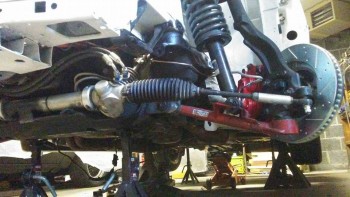

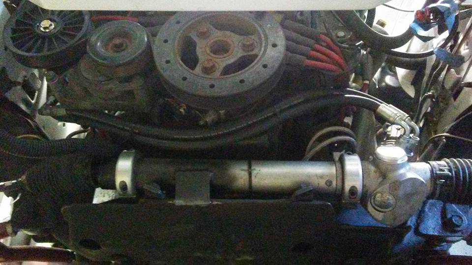

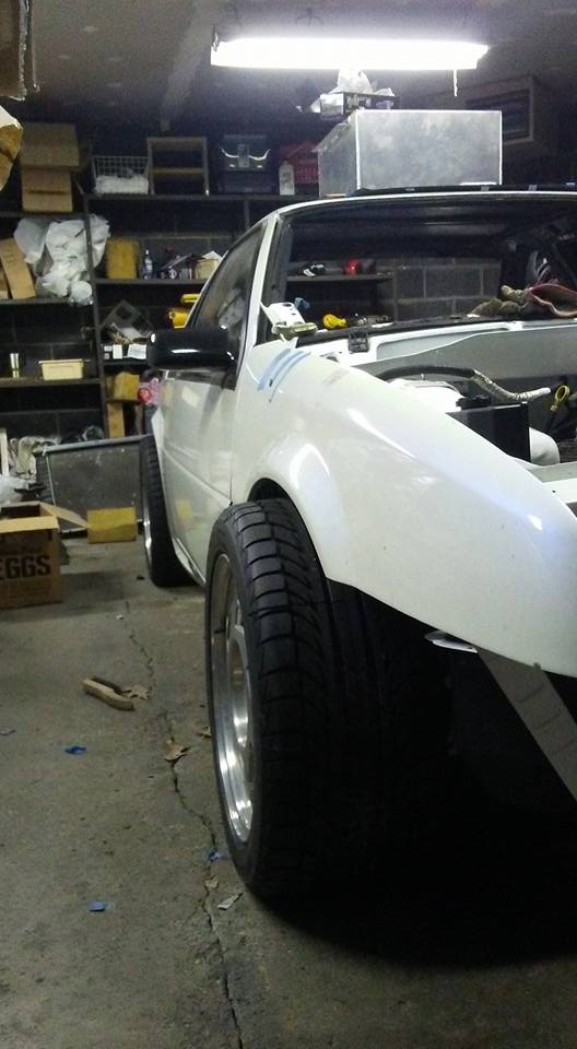

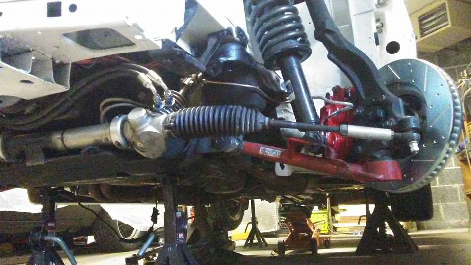

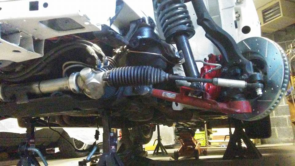

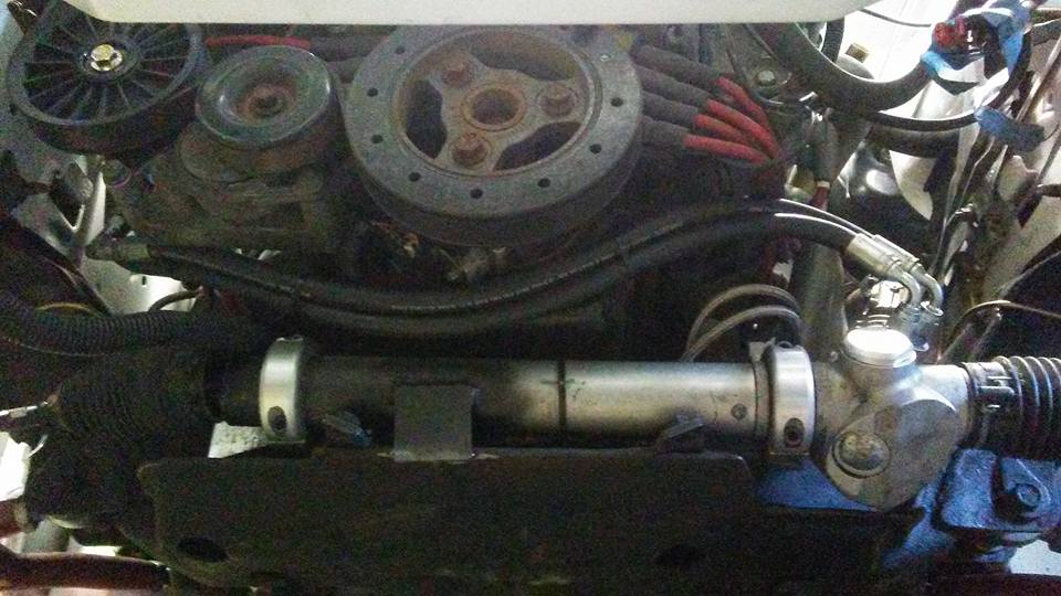

Progress has been slow lately as ive been working lots of OT and holiday stuff....... finally Worked out some clearance issue on the flaming river power steering rack spacer brackets and installed it hopefully for the final time. Rack is also welded to the cradle to prevent it from slipping. front steering / suspension is 99% complete for now...im really happy with how fast the steering is with this rack and knuckle setup... As u can see in the last pic. It's time for fiberglass widebody fender flares

Some pickup truck flares might work well! :)
Looks good man - keep up the good work!
Re: Beretta Z28
integrate a c6z wide body kit.

If everything works out I will be able to 3D scan the existing body surfaces an recreate new wider fenders that have tire coverage.
Plan b is to continue cutting and sectioning the "universal" fiberglass flares which I started doing and haven't felt like it's what I really wanted.....But is an option
