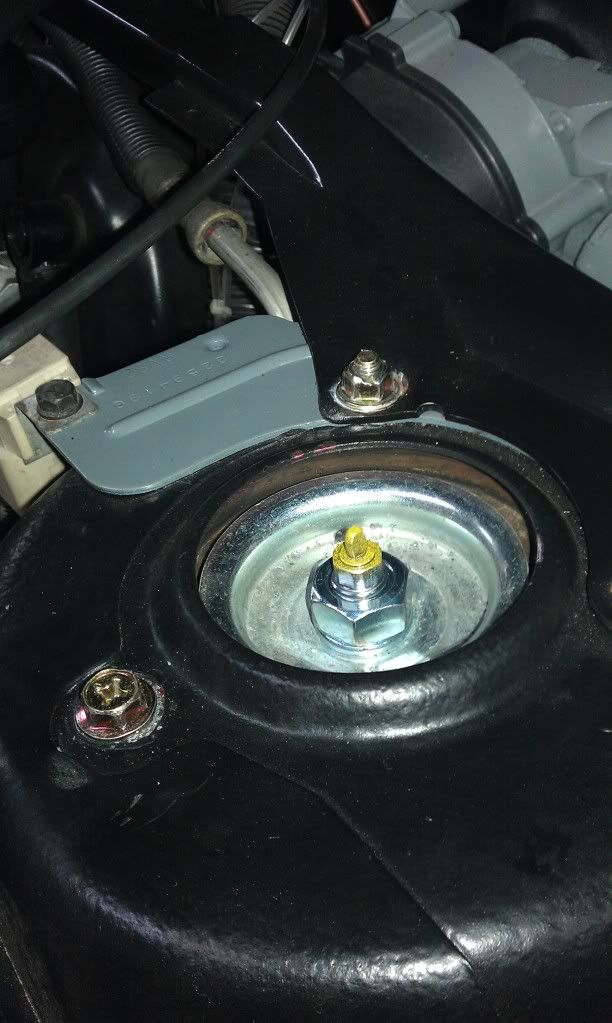

- Posts: 10923
Re: 1996 Mr.Pink
96's don't have strut mount covers... And I need to access this, so it's just in the way in the end...
