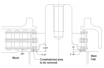

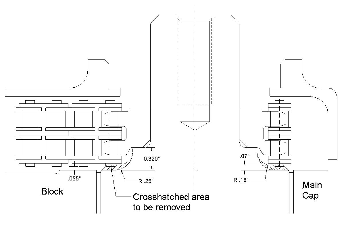

I did send it back when everyone else did. I haven't looked at it beyond seeing that the gears appear to be heat treated now. What do you tell your machine shop so they machine your crank for the new sprocket?

Ask yourself though... Why do you want the 3500 bottom end. They are very limited on performance parts vs the 3400... Honestly I wanted an easy bump in compression while keeping many other things the same to keep costs down. That is now not working out for me much with the bad cam news. Granted I'm still not dropping 1k on custom pistons for the 3400 to get the same CR but I do have a possible $800 price tag on a completely new valve train.Z26_T wrote:I did send it back when everyone else did. I haven't looked at it beyond seeing that the gears appear to be heat treated now. What do you tell your machine shop so they machine your crank for the new sprocket?
I can't really tell you how excited I am right now that I can go to a 3500 bottom... I thought they changed the chain set up.
Going to ask another dumb question.. do the 3400 head studs work also? I couldn't see 3500 studs on wot-tech.
Head studs are all the same... the heads are interchangeable so the studs are as well.
Also the TCE sets were always heat treated... He just had them black hard coated before sending them back. Flip over the cam gear and look at the slots near the center hole, those were originally not there. And regarding the crank machining, just give them this print.

There's a few reasons I want the 3500 vs a forged hybrid. The stock 3500 bottom is obviously better than a stock 3400. They can also be found locally for 300. The money for forged rods and custom pistons for the 3400 or 3500 just isn't worth it to me.
Thank you very much for the diagram!
