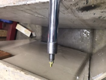

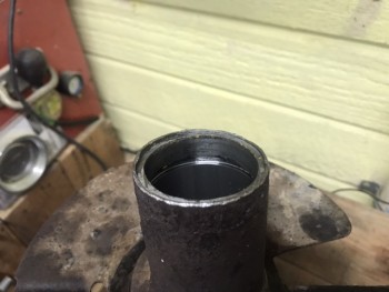

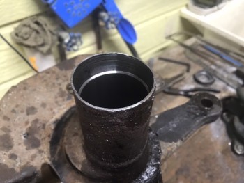

Prepare the beretta shock housing by cutting the top off to remove the innards. Now KONI wants you to cut a certain amount down the tube which exposes an inch or more of their shock... I did not go this low. I just made sure that the housing tube does not touch the KONI. If I cut too low on the Gabriel, I would need a bushing. By going down a half inch (2nd cut made after the innards removed) the “bushing” is already formed into the housing and I was able to use that (on the Gabriel).
To be cautious, because we don’t know for certain what’s inside the tube, cut near the top (as opposed to almost 2” below the top like koni instructs). Cutting too much toward the top and we can’t extract the guts, too low and we may have to cut the bushing separately in the vise (your choice really). We intend to use the inside as a clamp on the bushing should we need it. We don’t know if we need it yet and are preparing. Be aware that we may need a bushing here so the koni doesn’t flop around atop the tube after mounting. That’s why we are doing this.

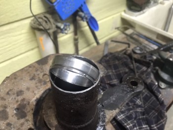

- Cut 1
- 3 piece
You can see what I did here. The right ring/bushing is what I’m using cut from the left two pieces. Discard the left two. This right bushing exactly matches the koni and of course the tube that it just sat in. It will hold into place by setting into the tube and lightly hammering the top of the shock tube over the bearing enough to hold it in place.
Here it is done. Before bushing, going in, and then bushing installed.

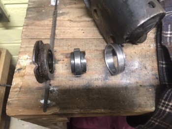

Now for the eureka moment on making these fit to the old style top strut steering bearings!
Pull the skirted bushing from the bearing plate. Channel locks work well.

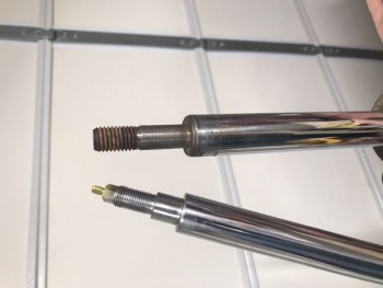

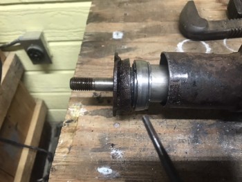

- Piston top
- Pre bushing

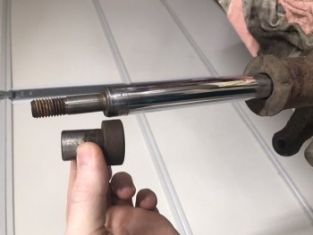

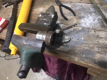

Since the koni’s shoulder is in the way no matter how we look at it, it’s easier to use the old bushing except we need to make it fit better. To get proper height (defined as 3 threads past a tightened nut) take the old bushing out of the steering bearing unit and cut the skirt off. Mine measures 0.64” and covers threads by some so the bushings seats against the bearing plate.
- Vice bushing
Next, the koni shoulder is 0.584”
The busing is almost there at (forgot)... 0.560”?
I didn’t have a bit on hand so I just hand filed it to wider.
Now it fits on the koni!

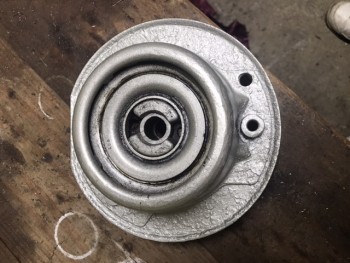

Now rather than leave it on the shock, remove it and push it as far up to seat (below picture it’s not pushed in all the way) in the top bearing unit where it was so we don’t use the nut to draw it snug (difficult and so we don’t have to grip the shock piston risking damaging it when torquing the top nut).
- Bearing plate
I did not drill out the bearing plate. Let the koni shoulder hit the mount as it should, or if your spacer is tall, it may not touch.
