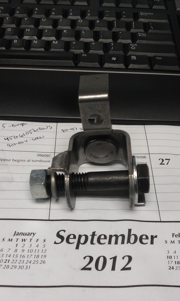

To use the Thunderbird shocks above you will need to purchase some cheap aftermarket shocks they come with a lower bracket to mount them. Just narrow the collar on the shock by a tiny amount to fit this width and your good to go. Only difference between the Saab's and these Thunderbird ones is the valving is a bit more aggressive and the lower mount is a 14mm bolt vs a 10mm bolt.
Lower bushing is also 41mm wide vs 36mm. Hence the need to narrow it to fit the bracket.

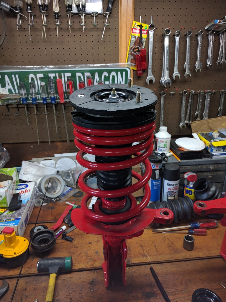

WELL I finally got some free time to install the Koni's that have been sitting around a couple months. I used a set of OEM Delco struts from a 1996 Base (Daves base)

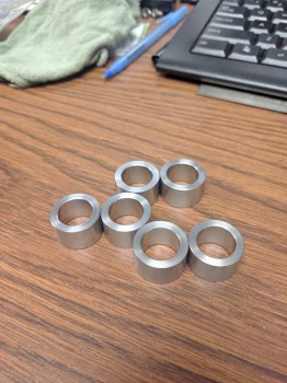

You will need to make a bushing to fill in the gap, exhaust tubing works well

Reinstall spring, then alignment and enjoy.

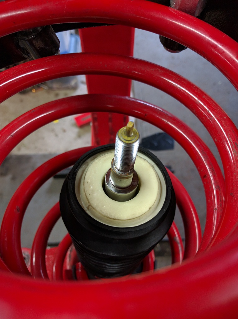

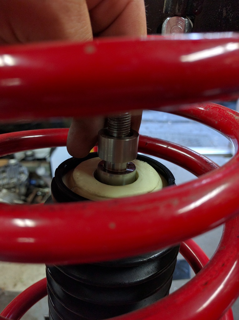

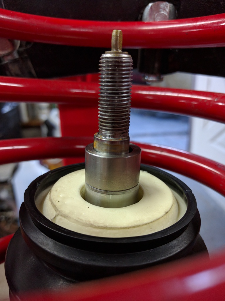

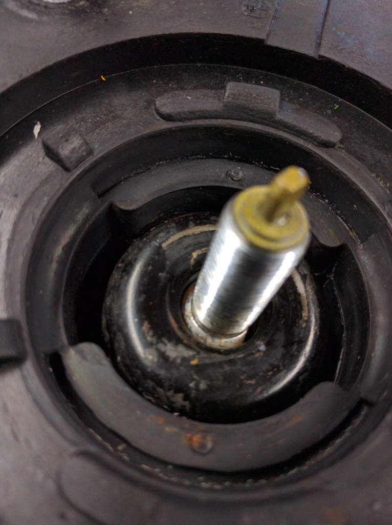

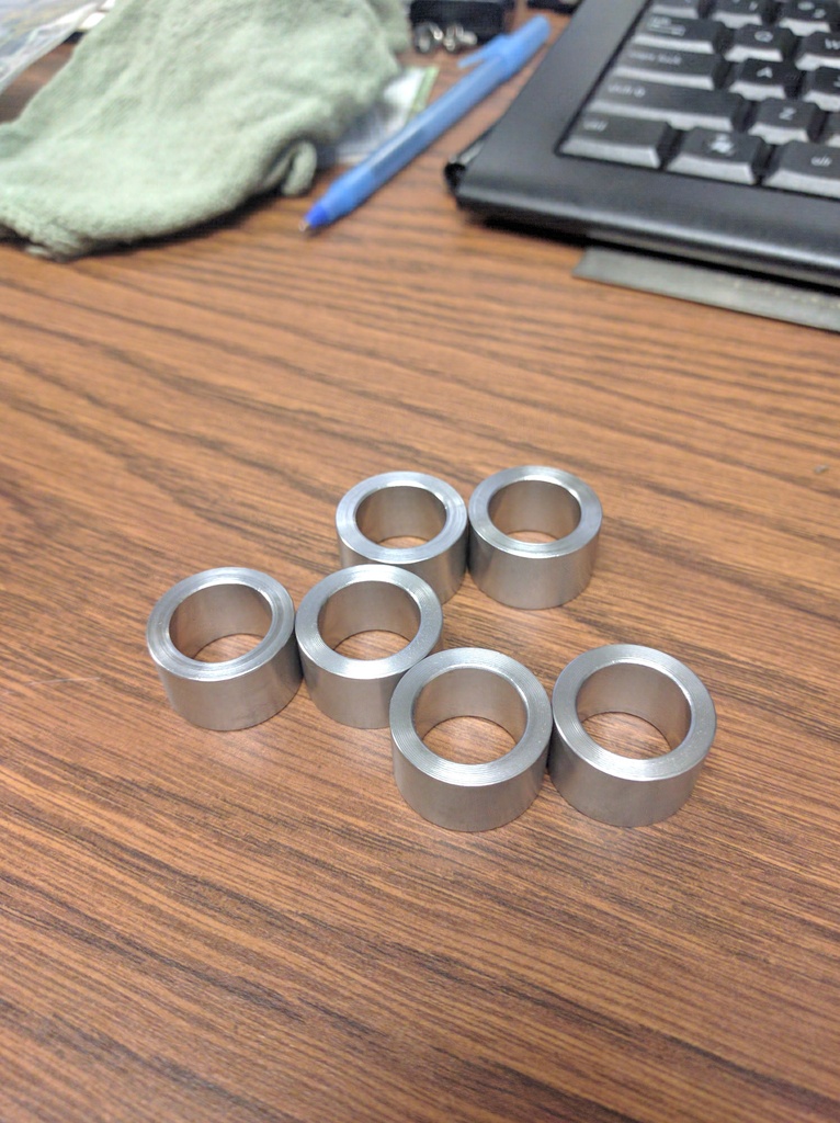

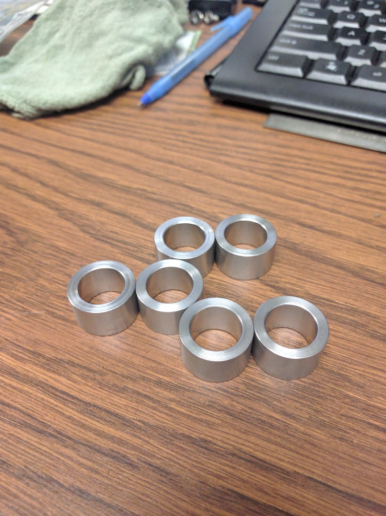

In conjunction with the longer cut to use the mitsubishi inserts you also need to compensate for the different top thread vs the older J-body versions. There is a step that messes with how the top hat fits everything and you need one thin bushing to take up that extra space. Bushing is 0.855 OD x 0.590 ID x .500 thick. The other sleeves that I was selling to weld into the strut housing also needs to be tighter since the Mitsubishi strut housing was a smaller diameter.(dimension coming) The J-body ones are larger and if you use the older sleeves then the insert will move around some which is not good.
Spacers you need for the top hat's Where the spacer goes. With Top hat installed. Completed strut
