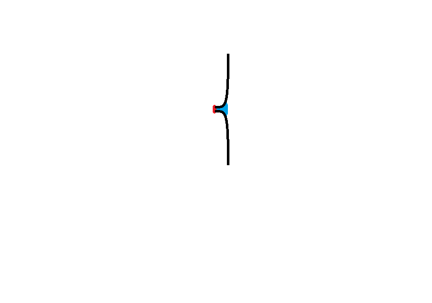

Butyl-tape is, if nothing else, an automotive product -it is used to hold windshields and other glass on older cars, and it used to be used to hold in tail-lights and many other components that needed to be sealed to the body of the car to prevent leaks. The question about the engine-bay heat is a very good one, but yes, it should hold up just fine -I believe it retains shape at over 200 degrees, but that is guestimate based on what I was told by a body-guy way back, so it could do with more research.
The sealant 3x00-Modified is proposing should do fine, maybe even better, since it applies in liquid form and may seal into the cracks better. But, I still suggest spreading the sealer in from the inside as well (maybe even first, and try to push it all the way through from the inside to the engine bay to make the sealant form one solid piece and prevent any air-gaps from forming between the multiple applications). There is better access from the inside, and the sheet-metal pieces meeting at this seam diverge on the inside, so it would be almost impossible to fill the entire gap and have it factory-smooth inside without applying it from under the dash.
Okay, look at it this way, if this sketch represents the cross-section of the firewall where the two pieces meet, applying sealant only to the outside (left side, represented in red) is a pretty flimsy seal as compared to pushing the sealant from the divergent inside joint under the dash (as represented by the teal color on the right).
Either way, good luck with it. I'm still going for the butyl-tape on the inside, but I think I'll apply a thin, deep layer of a sealant more like Jon suggests first just to get the gap filled better, and cap it off with the butyl-tape to make sure water never gets through it again.

Re: help me diagnose this moisture problem?
thats not how the seems look... but ok.
