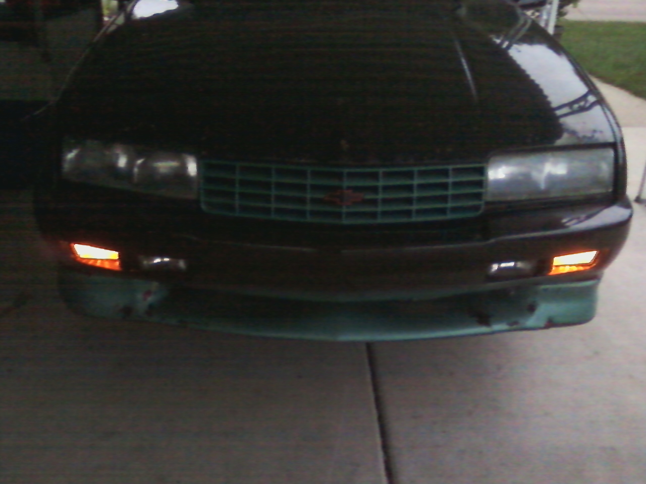

I have a Beretta Indy that someone put z26 ground effects on it so it has fog lamps since the Indy didn't come with them. My question is awhile ago out of nowhere both fog lamps quit working. I suspect its the relay being that its doubtful in my opinion that both bulbs would go at the same time. Buy since fogs weren't stock with the Indy I don't know how they are hooked up if a relay was added somehow or howto find out. I really miss my fog lights it was one of my favorite parts of the car I'm just not highly electrically inclined please help!
