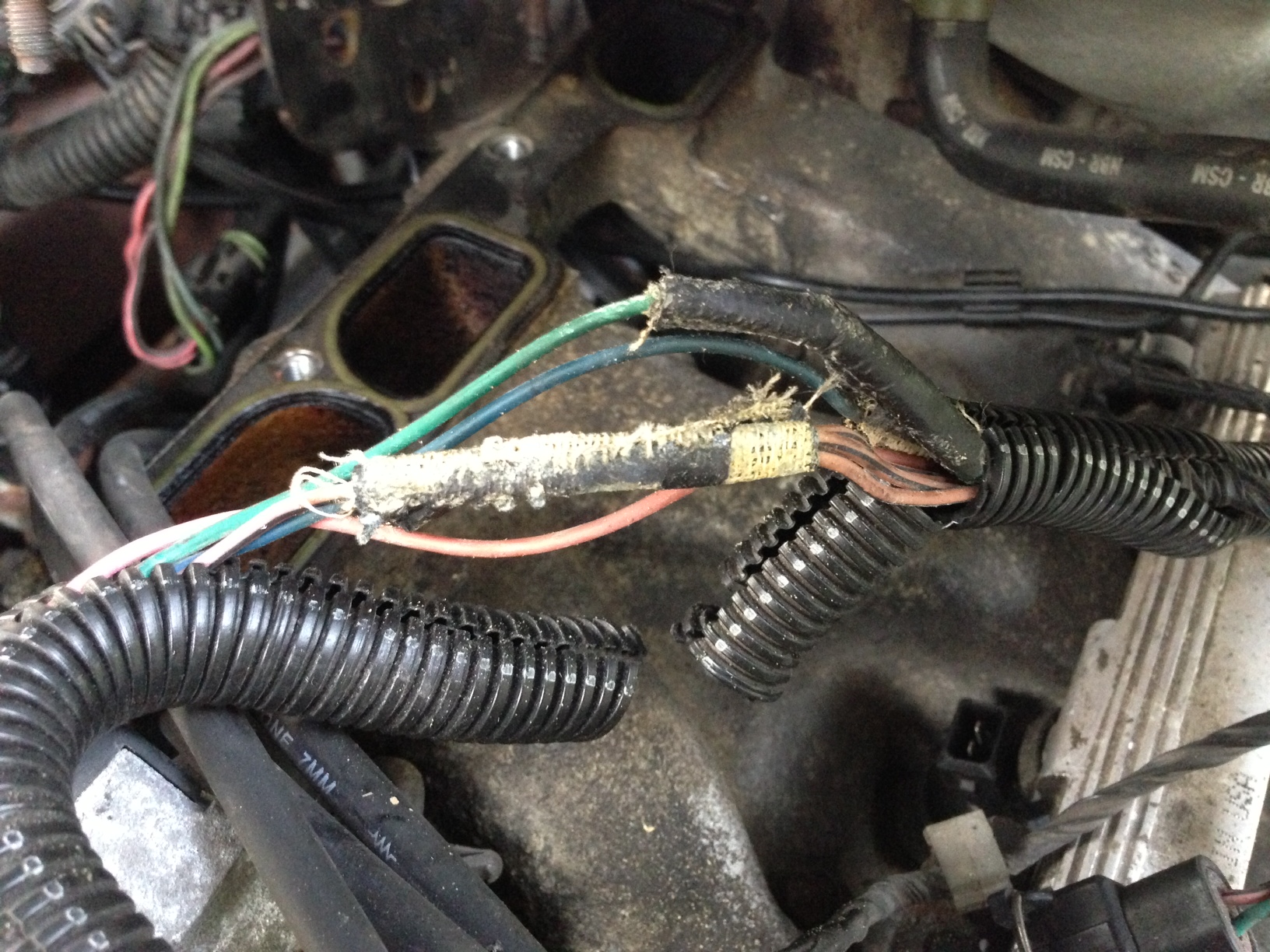

My injector harness looks like it was modified at some point but I checked with someone else and I guess this is factory. I tested to be sure there was no shorts in this cable. It seems the front 3 cylinders are wired parallel and same with the back 3. From what I have read in the manual this is accurate.

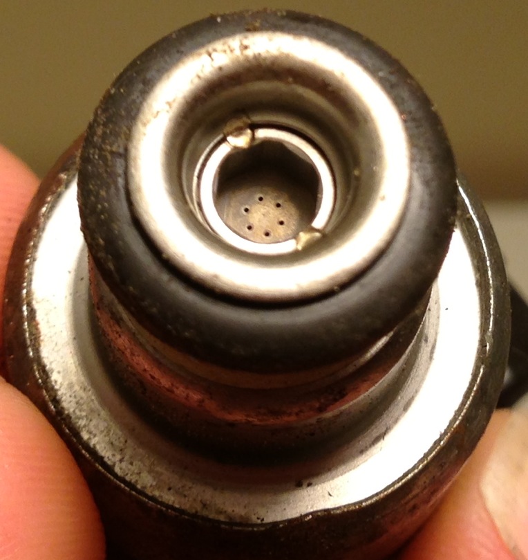

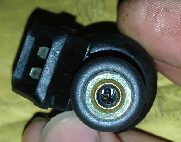

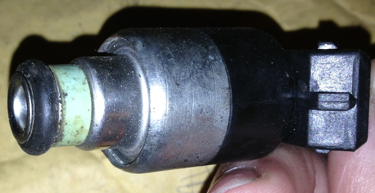

changed out the injectors with the originals and the car is actually better, i got about 100km more on my last tank of fuel. it has changed the way the car sounds when its missing. something else interesting about this is the set of flow matched injectors that i got were actually quite different looking that what was original to the car. I am surprised that I didn't question that before installing. I am on the hunt for a set of 6 working injectors, may just end up taking them off my running 2.8 for a test.
Here are the ones i took out

Those look like 3100 injectors, but that should be fine for that engine.

If the ECM is pulling fuel (BLM under 128) then it knows it is running too rich and is trying to lean it out. Pretty much rules it out as a source of your problem and points to a mechanical issue. Running rich it would not be an issue with insufficient fuel either. And swapping injectors should rule out a sticky injector causing it to run rich.
Have you tested for leaky injectors by pulling the rail and injectors and cycling the fuel pump on? If you leave the injectors installed on the rail there should be no leaks anywhere when pressurized.
It sounds to me like that would be the cause...one injector leaks and causes the o2 to read rich. The ECM tries to lean out the fuel mixture and it runs the other cylinders too lean causing a misfire.

By mechanical issue do you mean the injectors ? As the compression test came back good
I did cycle the key with the flow matched injectors and there were no leaks, I will try to pull it apart and try this test on the original ones.
