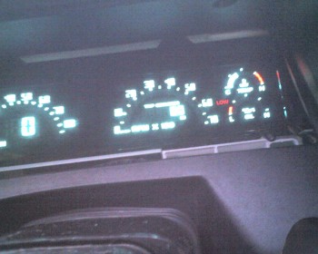

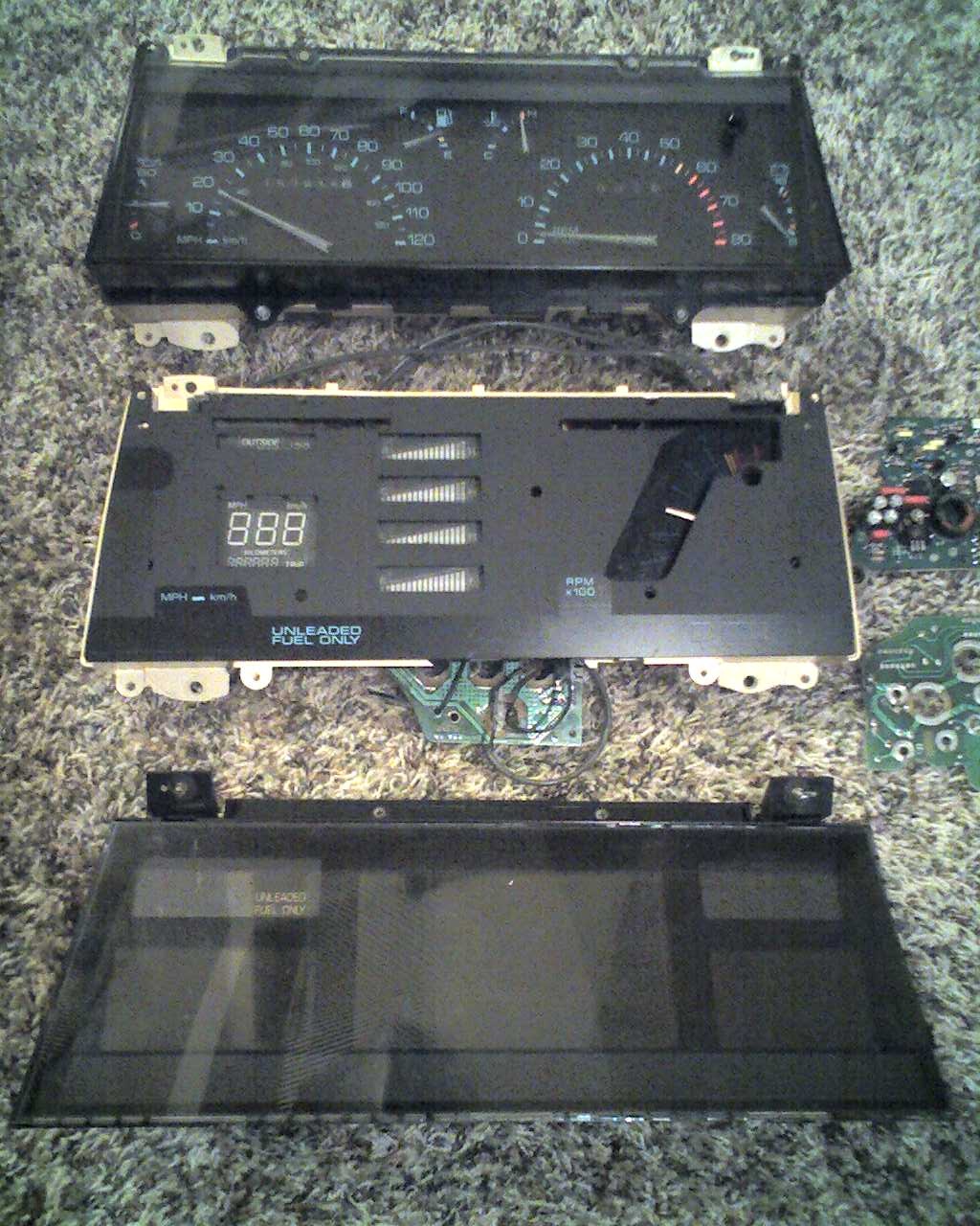

My '90 turbo 'T-Type' 'Retta came with analog gauges. I didn't like the orange needles in the standard clusters, particularly since my car is blue with blue. The top cluster in the picture shows the grey needles in my original cluster, on top, with a stock digi-dash cluster at the bottom, and a digital Z-24 cluster I modified for the Beretta in the middle.
Top: My '90's analog cluster, grey needles, blue LED lighting.<br />Middle: Z-24 semi-digital cluster modified for my 'Retta.<br />Bottom: Stock Beretta digital cluster.

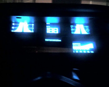

Digital cluster powered-up in my '90 'Retta.  Sourced from an S-15, still requires a speedometer calibration unit installed, like a Dakota Digital SGI-5.

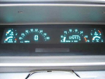

This second picture is the digital cluster I have in there now, but I am replacing that with a digital cluster from an Olds Cutlass Supreme. I like the Supreme cluster because it looks very similar to the Beretta's analog cluster, with bars placed radially in a 180-degree arc around a digital display. It is a color that compliments, rather than clashes with, my car's interior, and is arguably the most attractive digital cluster GM ever used.
Olds Cutlass Supreme Digital Cluster.<br />Photo Courtesy of Google Images.

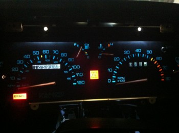

nicee!! job. i just went crazy and stuffed a LED strip inside my cluster to improve backlight..
how it used to look
how it used to look
this is how it looks now more or less

That looks good. The stock lighting on the alalog dash is sufficient, but not really anything better than that. Nice improvement!

Olds Cutlass Supreme Digital Cluster. i want that! how would you go about installing it?

The Olds cluster is WAAAAY too wide for our old dashes... So, I cut both idiot-light sections off of the ends with a hack-saw (after carefully removing the printed 'soft' circuit-board from behind). It may still be a little wide, but it is darn close -I'll let you know after I get that far with the re-install.
Just like the stock Beretta digi-cluster of our era, the Olds cluster needs the ECM to run it. That presents a serious problem if you are not running the engine with the stock computer, like me (the '90 'Retta this is going in is using a '97 Venture PCM to run the LA1/LG5 3400/3.1 turbo hybrid I have in the car), because it needs the 7X crank-position sensor to run the ICM, which then communicates RPM data to the ECM which in turn sends data to the cluster for the tach... Whew! I will be making an external reluctor-ring to trigger a dummy CKP7x for my tach. Now, if your car is stock, you can actually run your 2.8 off of the Olds computer, since it is looking for a 3.1 MPFI engine anyway -the 2.8 and 3.1 are essentially interchangeable, even the injectors are the same. EGRs might be different, so investigate before committing.
So, if you get to the point where you have the Olds Cutlass Supreme UB3 cluster (look in the donor car's RPO build sheet or sticker, usually located in the trunk on the spare-tire cover to see if it has the UB3 'full' digital cluster or the tachless 'base' cluster, or the analog cluster), ECM, and wiring pigtails for both (the ECM will NOT plug directly into your car's wiring harness, so you will have to re-pin or piggy-back the Cutlass ECM), PM me and I will send you the pin-outs for both the instruments and the ECM.
To really clean this all up, I will be using the Cutlass' tinted lens, that looks almost blacked-out when off, and will add a custom warning-light bar across either the top or the bottom, with LEDs so I don't have to worry about replacing burned-out bulbs, ever. Even the stock Beretta digital cluster uses bulbs to back-light the cluster, and for the dummy-lights...

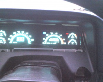

Digital Cutlass cluster is in (mostly) and operating (mostly). More info on my thread for that car, but here is a quick peek...
Powering up...
Powering up...
I did have to notch-out the Beretta's dash, inside the instrument-housing area, to make the cluster fit without carving off so much that the mounting-holes would be weakened, and I piggy-back soldered the Cutlass' instrument wiring-harness pigtails instead of making a plug-into-the-stock-Beretta-instruments-connector housing on the back of the cluster like I did with the S-15 digi's and the Z-24 semi-digi cluster, but I am confident I will want to keep this cluster in the car permanently, and I can still go back to the stock Beretta cluster easily enough if I change my mind...

Soo cool. Those little numbers kill my already damaged eyesight though lol
1988 Beretta GT 2.8L V6 - Yeah my Retta is a year older than me! :)
Work in Progress
Posts: 1847
Re: Analog dash Mods
My crappy photos are courtesy of my 'ancient' phone. They are actually super-crisp, and much more readable than ANY analog display. Unfortunately, until I complete the wiring to the park-light switch to tell the cluster to dim for night-mode, it is stuck in full-bright, which means daytime visible. Once I splice in that one wire though, the dimmer function should work properly.
