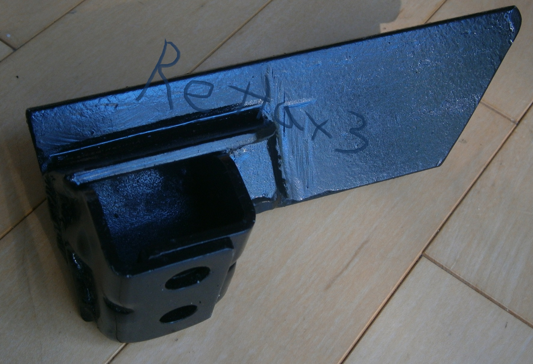

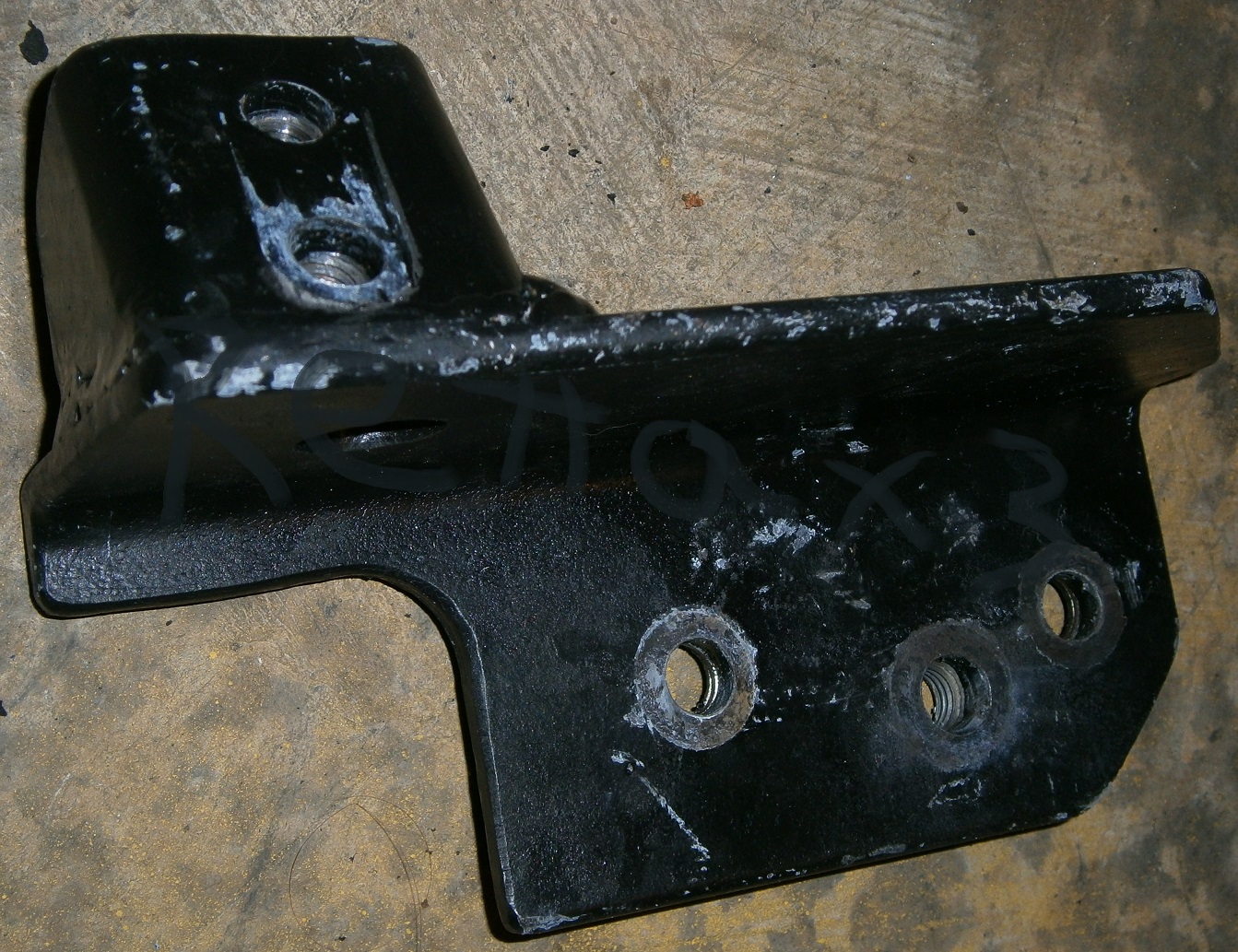

There is a guy here in the US that makes the custom mount, but he is on the V6Z24 site. Not sure if it has to be welded in. The stock one just bolts in the newer cars.
WOT-Tech sells a 3400 swap chip for 2.8/3.1L. As for the mount the later 3.1's had it(like 91-92?). After that it was all 3100's.

For interchangeability, the 3.1 MPFI bolts on, but isn't really much of an upgrade, 3100 SFI isn't too hard to adapt, except for the front mount, dito for the 3400, 3500 will go in, 3800 and 3800SC (I have one of those in a car that was a 2.8 ) but requires a bit more fabrication, even a 3900 should go in with some work (I can't say for certain, though), and the 3.4 Twin Dual Cam 24-valve engine will also bolt in, but will be fairly difficult to fit into the car (no one has actually done it, to my knowledge, and that engine uses a timing belt and earlier versions also require partial engine disassembly just to change the rear spark plugs). The 2.8s are also fairly cheap to turbo-charge, whereas the Quads have a higher compression-ratio which tends to make forced induction costly to make reliable.
BTW, I also have made some of the front-mounts for adapting the 3X00 SFI engines into the older Berettas, and I am willing to make more if there is a demand for them... These are not as complex as the ones sold on the other site, and they are able to accept the older-style A/C bracket.
