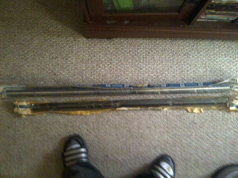

BerettaMN wrote:If anyone has the original parts number or a superceded number try looking it up on http://www.partsvoice.com. I use d this site to find tons of oem trim and parts no one else has.
I highly doubt anyone would EVER find OEM external dew strips available online somewhere still, and if anyone did I'm putting out the offer that I would pay you 1k for them. That's simply because I do not believe any online sales store would have these in stock or hidden on a shelf somewhere... Hell GM vintage parts doesn't even have any. I know some have gotten lucky and find the occasional person on Ebay that has one or two stashed away but even that has become a long lost dream.
I ordered some generic felt dew belt strip online from a company that was pretty close to the top rubber profile, it doesn't have the lower inner curve that the OEM ones have but if we could just get something to replace the top exposed rubber I think that is all we need. I'm working on retrofitting them to the OEM metal part.

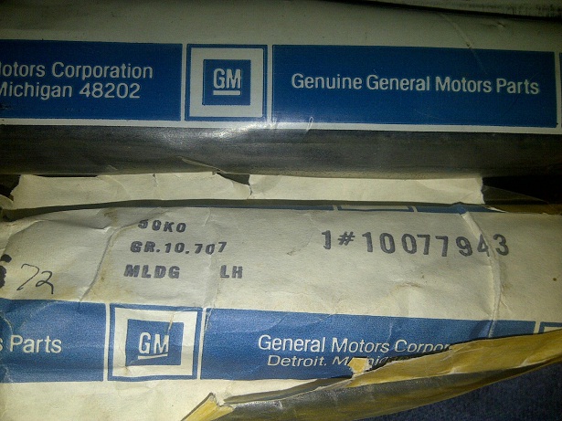

You mean like these......
88 GTU 5spd 67k black
08 TBSS LS2 AWD
Posts: 10923
Re: Exterior Door Window Trim moulding
Yeah and how long have you had those?
I have one where the rubber strip has a 99 date code on it so it's obviously not oem.
Offer still stands find some online retailer selling these and I will pay 1k.

88_GTU wrote:
SELL TO ME! :shock:
88_GTU
Posts: 474
Post by 88_GTU »
pretty sure they're OEM....
08 TBSS LS2 AWD
Posts: 10923
Miss understood my statement... I mean original run for production... a seal with a 99 date code was obviously not produced to be installed on a new car, it was made as a replacement part, so the dew strip I have was never installed on a car at the factory, it was more than likely purchased to replace one probably like the ones you own so they are not as old as the newest Beretta.
