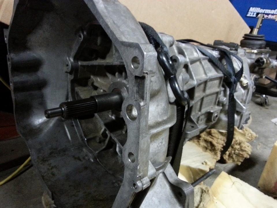

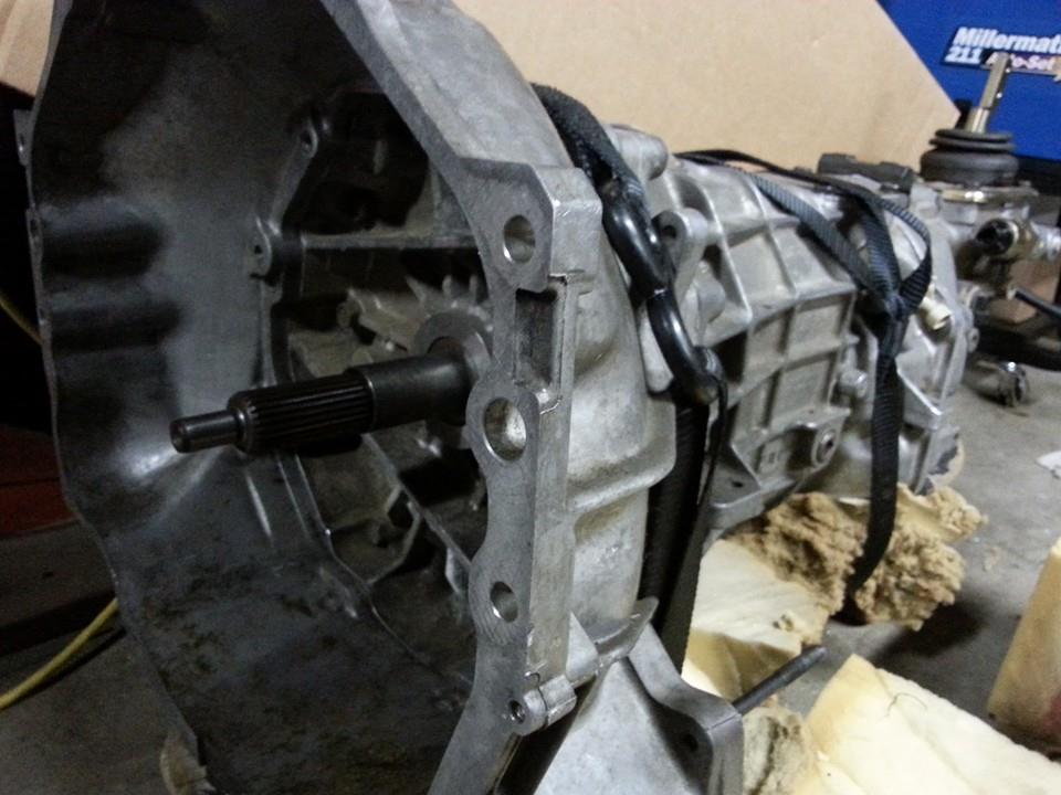

got a reconditioned T56 6 speed and mocked up the manual pedals as im also doing a manual swap

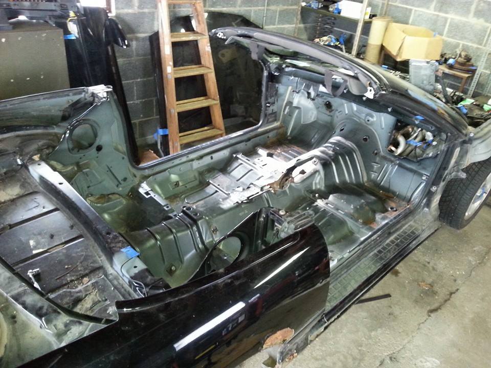

some more up dates... completely striped down to the unibody from the fire wall back. all wiring, fuel lines and tank, rear end, suspension, exhaust and convertible top and hydrolics/pump. Im ready to brace the floor and cut off the body. due to some crunchy frame rails under the body i have also decided to replace the rails with some 3x2 box tube from the rear up to the fire wall to stiffen up the chassis and have something solid for the roll cage to tie into.

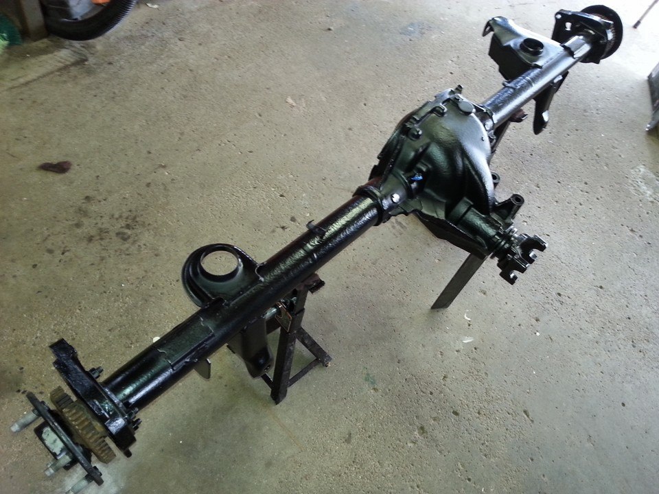

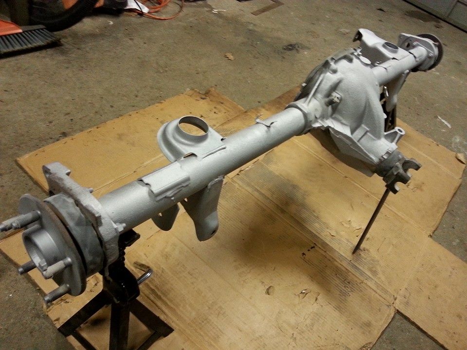

also cleaned up the axle and got 1" drop springs adjustable panhard bar and adjustable rear trailing arms.

its easy to take stuff apart.......the real fun is about to begin as i begin cutting on the two bodies............ again i will do my best to keep everyone updated
