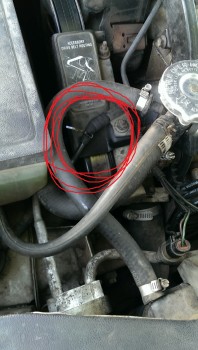

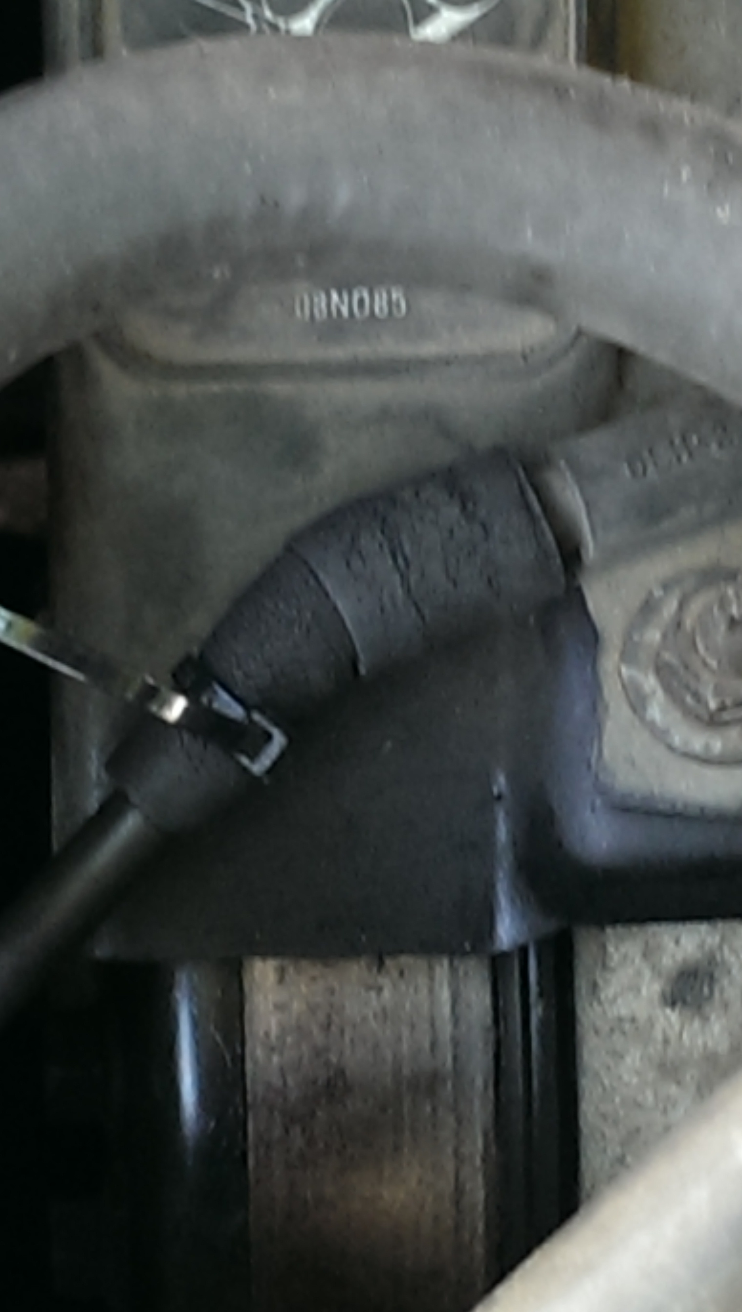

So I got a new battery to put in, and figured I'd ask the guys at Walmart what this part was,
(I had been told "some random vacuum thing" by mechanic, who knocked it loose when replacing sparkplug wires and used the ziptie to hold it on, and chevy also) and get told it is a thermometer part basically. I'm guessing it has something to do with the IAT (or is?). So whatever it actually is, any thoughts on where to find one? Mine is pretty obviously shot from age.
Re: Engine questions
'Random vacuum thing' is fairly close -that is the line from the EVAP canister. Basically, it flows gases into the engine that build-up inside the fuel-tank when the EVAP solenoid says 'go'. Low pressure, not very essential either. Gotta love those Wally-World-Wrenchers, boy howdy they are on top of it!
Just find a rubber connector of the correct size -about 1/4" on one side, maybe 5/16" or 3/8" on the other? It isn't really a specific 'part'...

My vacuum line to my EVAP canister recently popped off mine and will give you the gas smell you were talking about.
