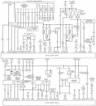

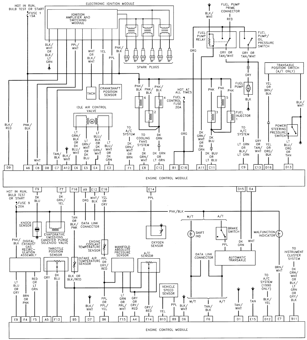

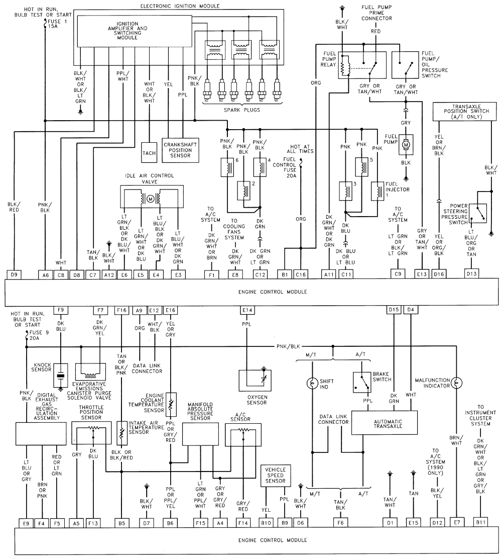

While my motor is out of the car, I plan on finally having reverse lights from my 5 speed swap.
Does anyone have the factory service manual for this model year and can tell me on the automatic plug which wires trigger the reverse lights?

Re: 1991 Beretta V6 automatic wiring diagram
this is actually a really good diagram to have but its not labeled on this
I see this as light green... Pin F. There is a dark blue listed but that goes back to the fuse box.
