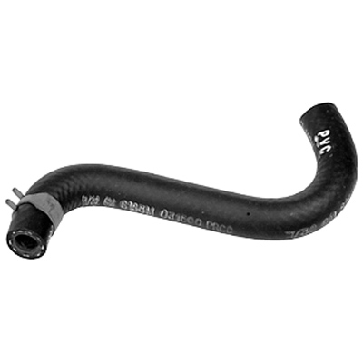

make sure the hose for the pcv isnt cracked/torn. It can be found going to the under side of the uim.
it goes on the port in that pic.
This is the hose:
This is the hose:
