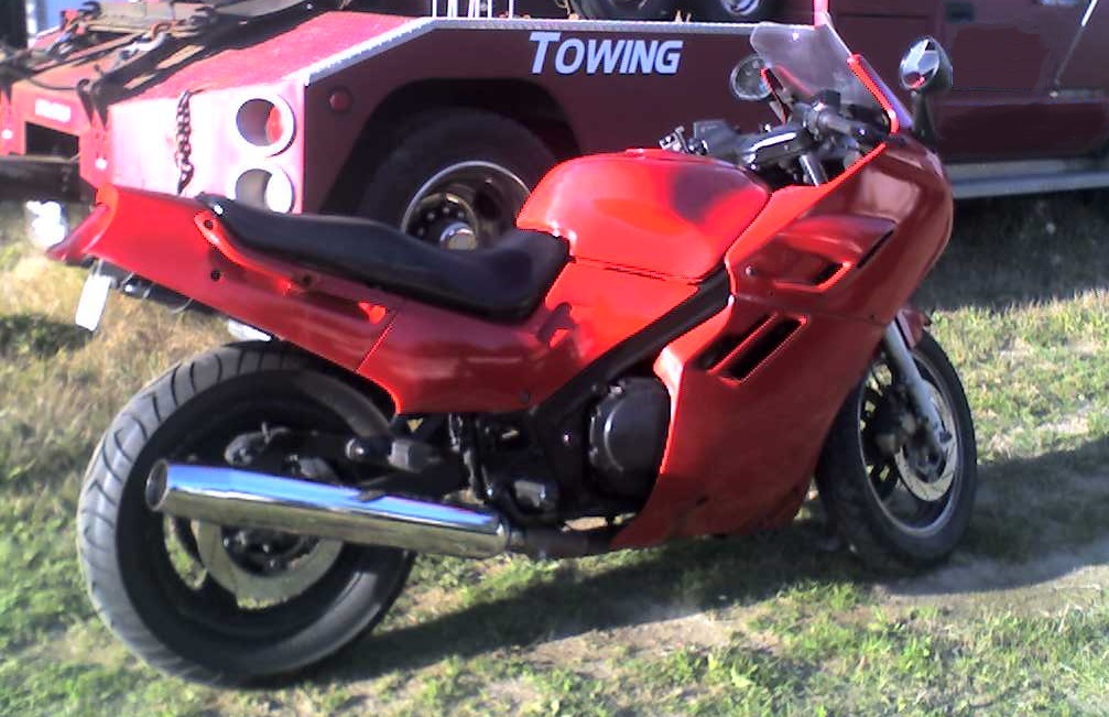

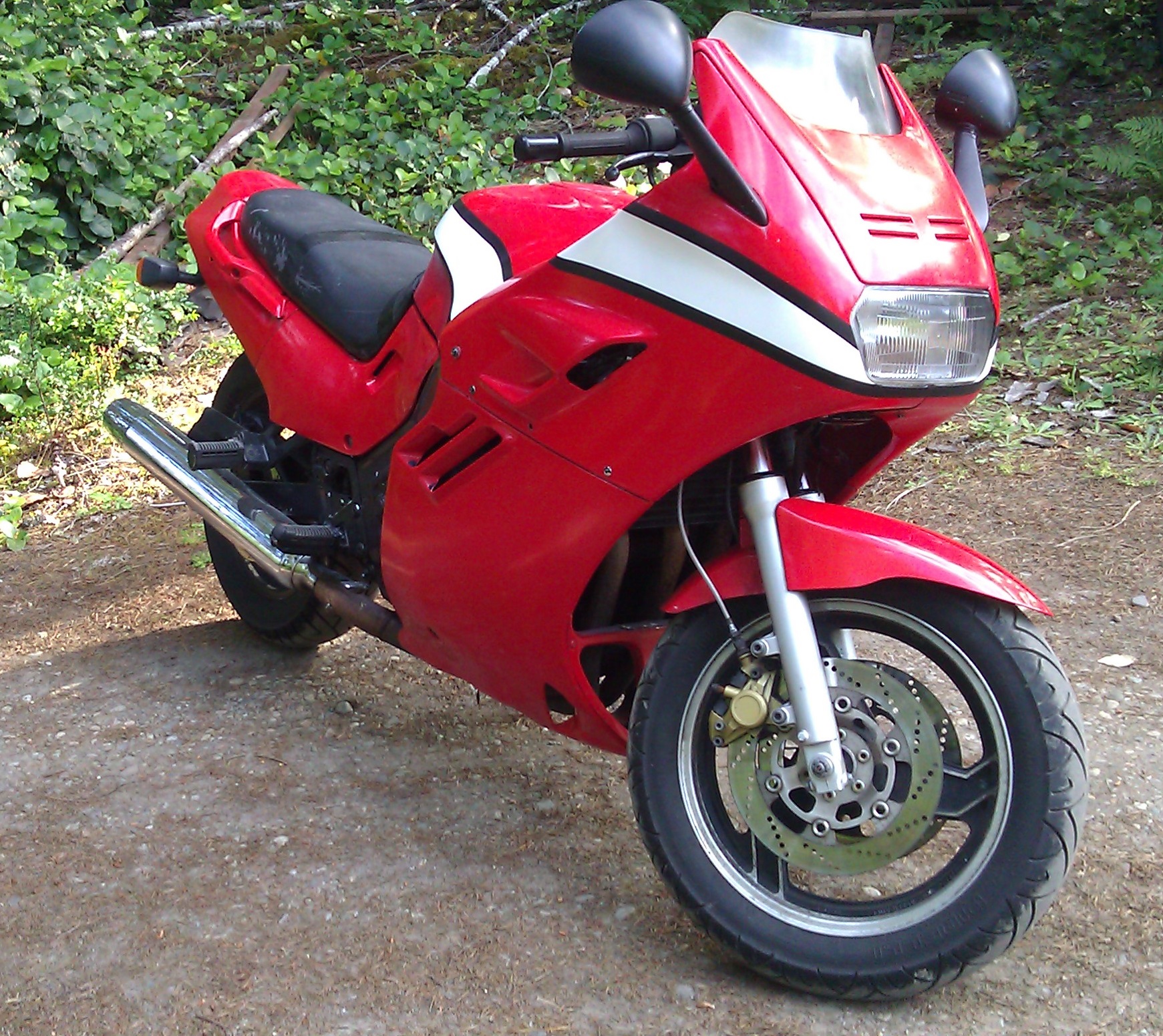

Updated the look of my older bike. The red paint-job (I don't care much for red on most vehicles anyway, but was able to overlook that because of the price and overall condition of the bike) was wearing on me a bit, and flaked a little during the most recent washing. It has been a good bike for me for the last several years, and I had wanted one of these fairly unique and rare open-class sport-tourers for a long time, so more than likely, I will keep it and eventually do a full re-paint, likely to a two or three-tone silver.. But for now...
An hour or so here and there spruced it up a bit, and helped to break-up that huge slab-side of red. I had intentions of adding another stripe along the side, and continuing all the way to the tail-section, but I'm satisfied with the look for now, so it will wait. Besides, I also have the other bike to toy around with now too.
The seat may be the next big project on the bike, the cover is starting to show that I don't garage the bike at all. Mechanically, I've done very little to this after the first round of maintenance and minor repairs it needed at purchase. I will have to re-lube the window tracks again though -it was pretty sluggish when I raised it for cleaning/polishing this week.

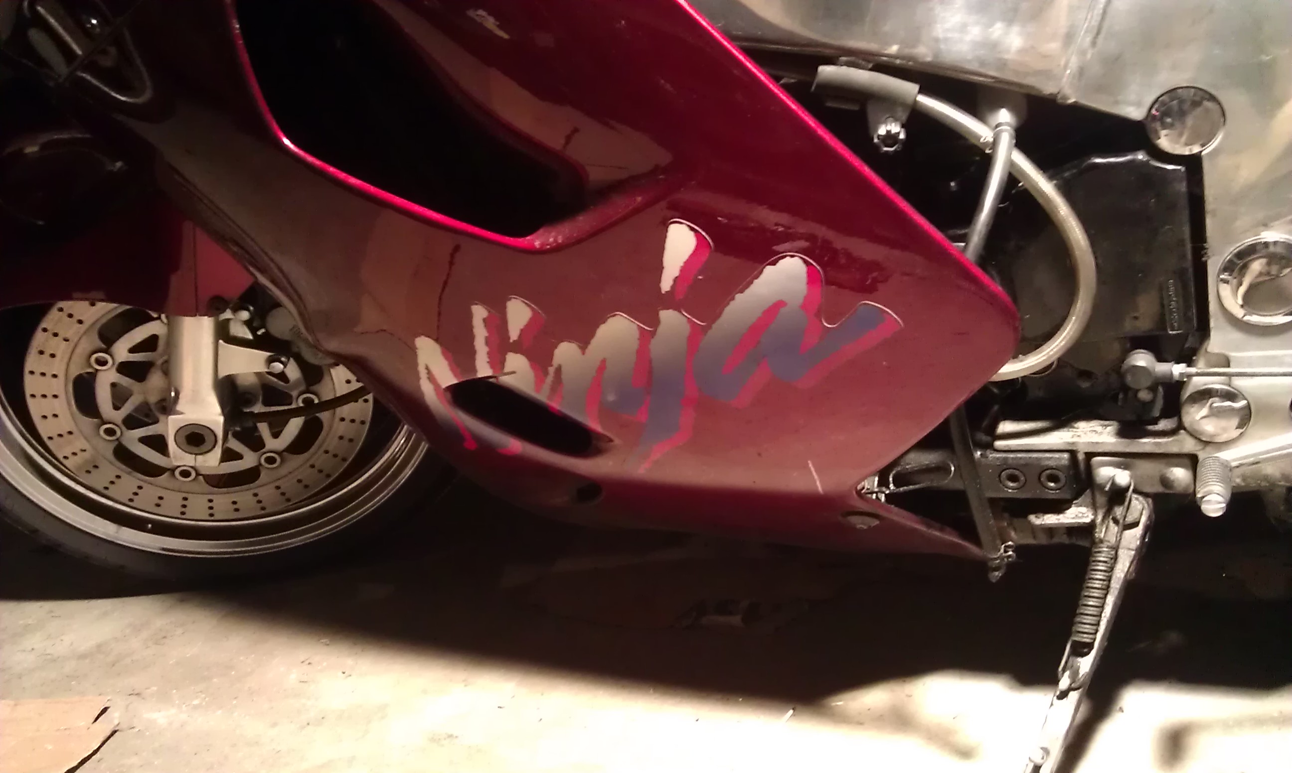

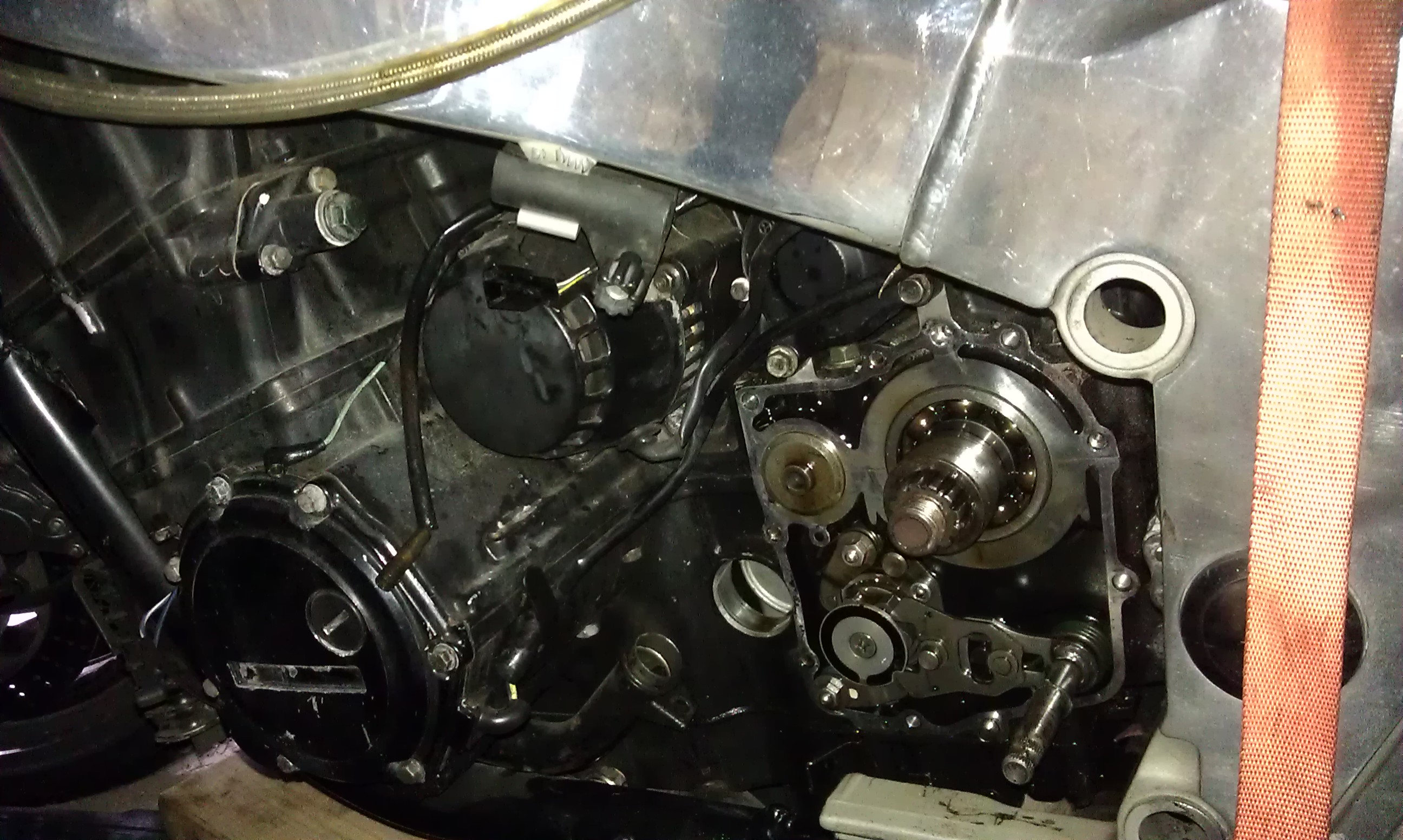

... And for more summer fun, I managed to replace my old ZX-11, after seven years. Managed to pick up a beautifully-kept bike for under $700 from a dealership, because the bike had some mechanical damage and was brought in on trade. They didn't want to spend the labor-hours fixing it, so for $50 in ebay parts and a couple of weekend evenings (okay, a 4:30 a.m. wrench-fest is more than an evening, but it still wasn't a ton of time involved and was fixed by Monday) I got an awesome bike. The original drive-chain had broke, slightly damaged the aftermarket aluminum chain guard, and smashed into both inner and outer drive-sprocket cases, which broke them both. The dealership was apparently scared-off mostly because of the oil-leak caused by the cracked inner case, and the low oil-level that resulted -they weren't sure just how low the oil was, and didn't want to start the bike to find out if there was any other damage. I took a gamble, and it paid off nicely.
The engine did have to be unbolted from the frame to scoot it forward enough for the inner sprocket case to clear the side of the frame, which is where most of the time was spent. Aside from that, removing the lower fairing sides and applying the 450+ foot-pounds of torque it took to unbolt the front sprocket without tipping the 601-pound bike off of its' center-stand were the only real effort the repair took.
Some nice upgrades on the bike are the full stainless Yoshimura 4-into-1 performance headers/exhaust, K&N air filter, red LED instrument lighting, real carbon-fibre instrument-bezel cover and matching triple-tree 'key protector' (small patch that covers the piece at the top of the forks where the ignition lock is), fully polished frame and swing-arm, polished and color-matched rims, braided stainless-steel brake and clutch lines. Not the greatest fan of the 'euro' rear fender/plate-mount delete, but it does clean up the back of this particular bike pretty nicely, so I can be okay with it, and it wasn't done with a sawzall for a change... The previous owner also installed a "Zero Gravity" brand 'double-bubble' dark-tint windshield, and an HID LED headlight bulb, which definitely lights things up nicely. With 32k miles on it, the bike is broken in, but definitely not worn out. The good quality Metzeller tires will last the season, likely even next year too. I can't believe how easily this thing pushes around -makes me want to rebuild or replace the wheel-bearings in everything else I have, and it makes the Katana feel top-heavy and big (though I'm still not sure which bike is the quickest). I ordered a pair of stock-type windshields, one smoke and one clear, and I also received the pair of handle-bar risers today, I remember clearly wanting them for the first ZX. Risers and windscreens brings my cost of ownership up another $100. It was missing the owner's manual and tool-kit -I still have the manual from my other ZX, and I think I can put together a decent tool kit of better quality than stock for pretty cheap. I also have the complete factory service manual in hard-copy and CD, and the complete parts catalog on CD as well, courtesy of having owned my old bike at a time when I was insistent on having the factory books. I have a few spare parts left over too, should I find I need them.
