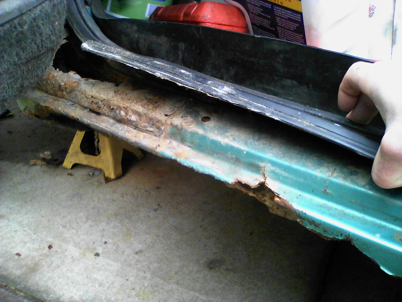

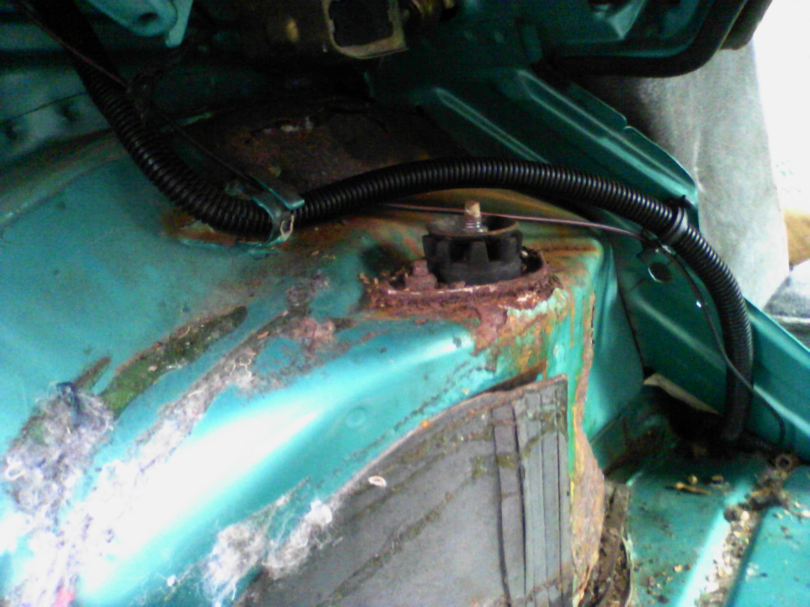

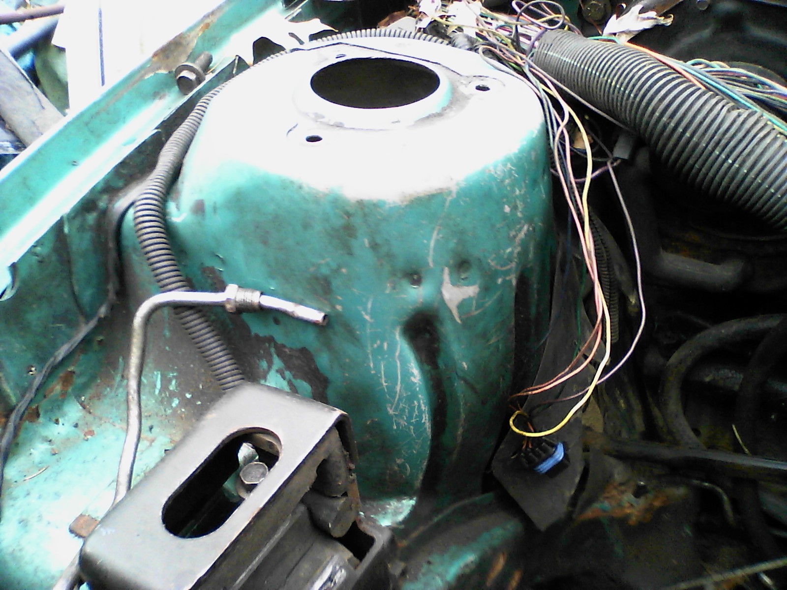

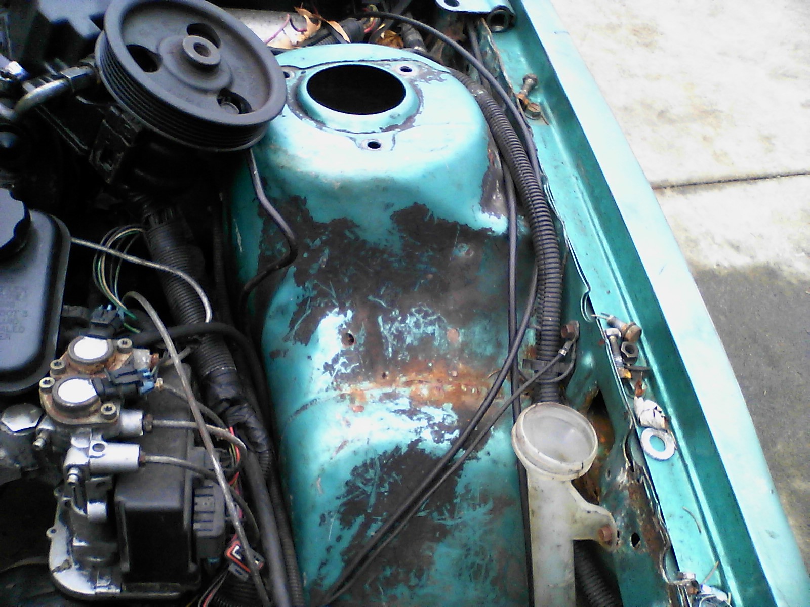

Before we go any further than this, what condition are the subframes, rear upper spring towers, and the rockers both inside the fender and inside the door?

whiteretta wrote:Before we go any further than this, what condition are the subframes, rear upper spring towers, and the rockers both inside the fender and inside the door?

Get underneath the vehicle, and take a photo of the top of the coil springs on the rear, both sides. Also, take photos of your front subframes where the lower controls arms connect to them, also both sides. Take out the plastic inside the fender wells in the front, and take a photo of where the rockers are at, from under the car, from the wheel well back.
These are common rust out areas, along with the two photos you posted of the rockers. The other photos don't really show the common rust out spots, but that rear shock tower is getting pretty rough. Never seen one in that shape before...
Those rockers are excessively rotted out as well. Until we see photos of the other three spots I listed, we won't really have any accurate idea of the structural integrity the car may have left.
Re: My 1992 Beretta 3.1L
SCRAP IT!
The damage you see on top of the rockers is only 10% of what is going on underneath.
That car is almost unsafe to drive!
What are you like 15 years old and this is your first car?
You are just fooling yourself and wasting money on that thing!
Sorry, but sometimes the truth hurts!

That is a DANGEROUS vehicle to be using with that rust on the unibody, dangerous for those around you as well as yourself.

Those rear strut towers sketch me out ...I've seen them rebuilt and the rockers Could easily be replaced ....but...if they are that rusty...what's the rest of the subframes and everything else look like underneath ...I'd say she's done...mine had a little rocker rust and wheel well rust ..but the shock towers and subframes on mine are rust free...which is why I put the effort into fixing the rockers and wheel well..I'd find something in better shape and start with that ...sorry dude ...also engine wise ...those 3.1s are everywhere at the scrappers ...probs just be cheaper to pick up a low km one in better shape...good luck!
93 retta gt quasar
I'm not that worried about the shock towers, hell I removed the upped layer of sheet metal from mine completely with no issues, there is another thicker one under it in the wheel well that actually does all the job.
How ever, that rocker rot is extreme and this car would wrap up in accident like tinfoil, unsafe.

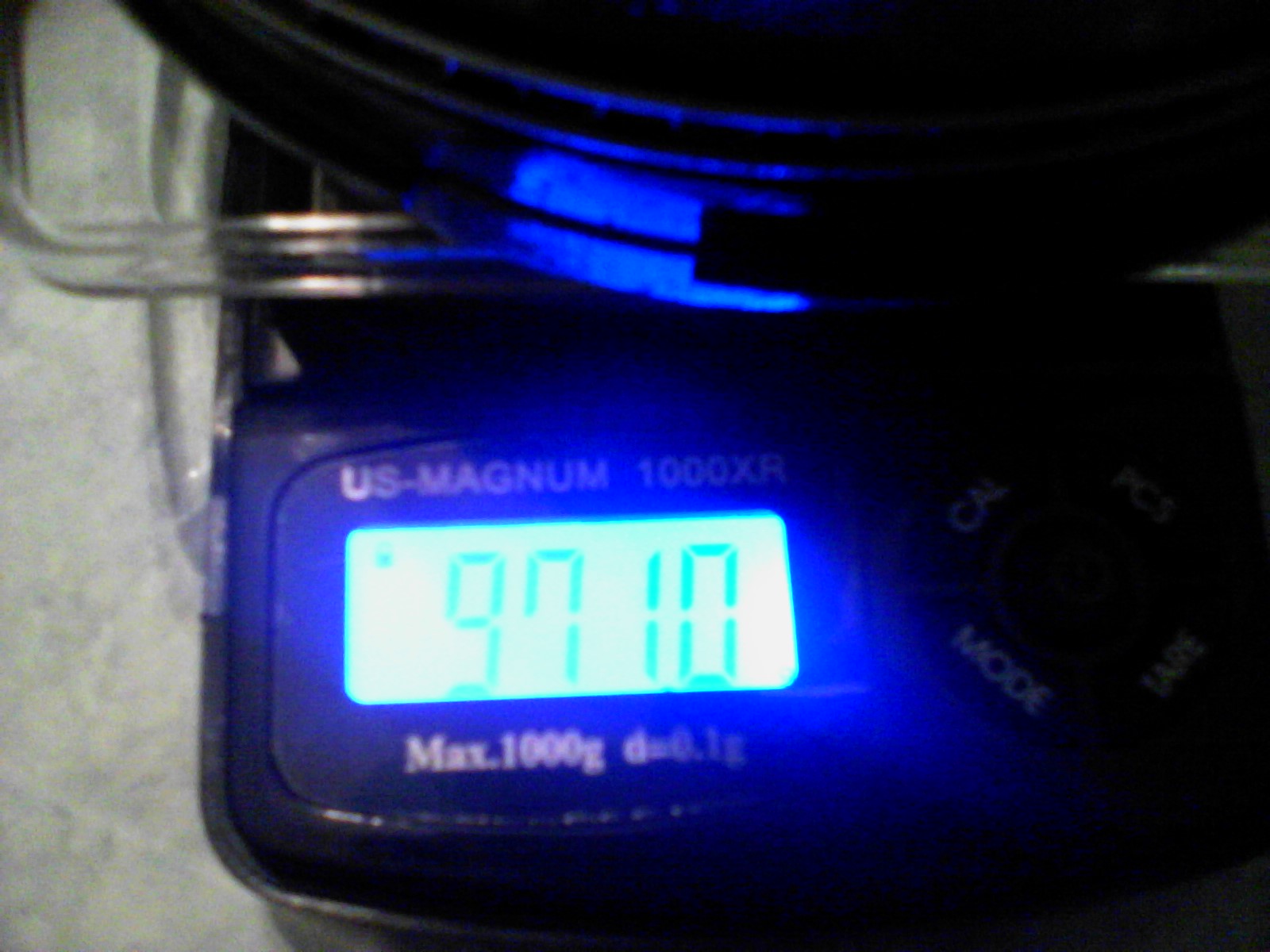

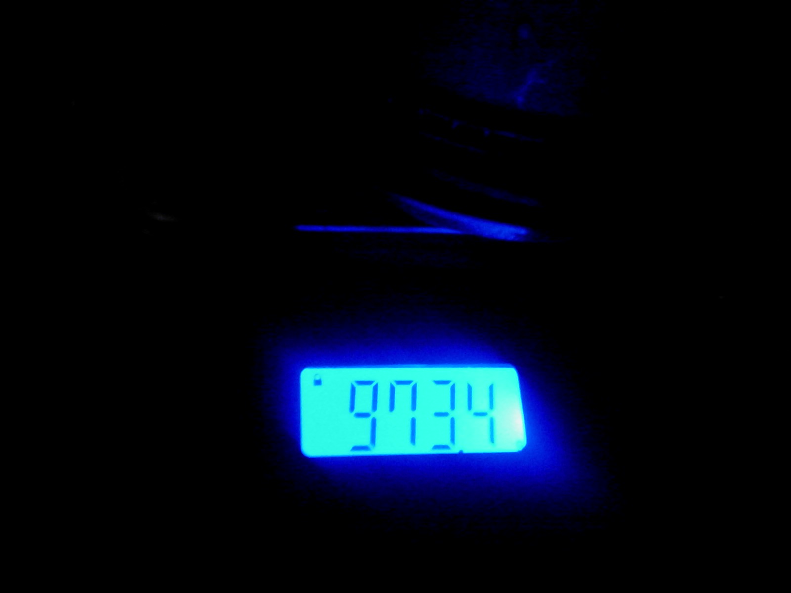

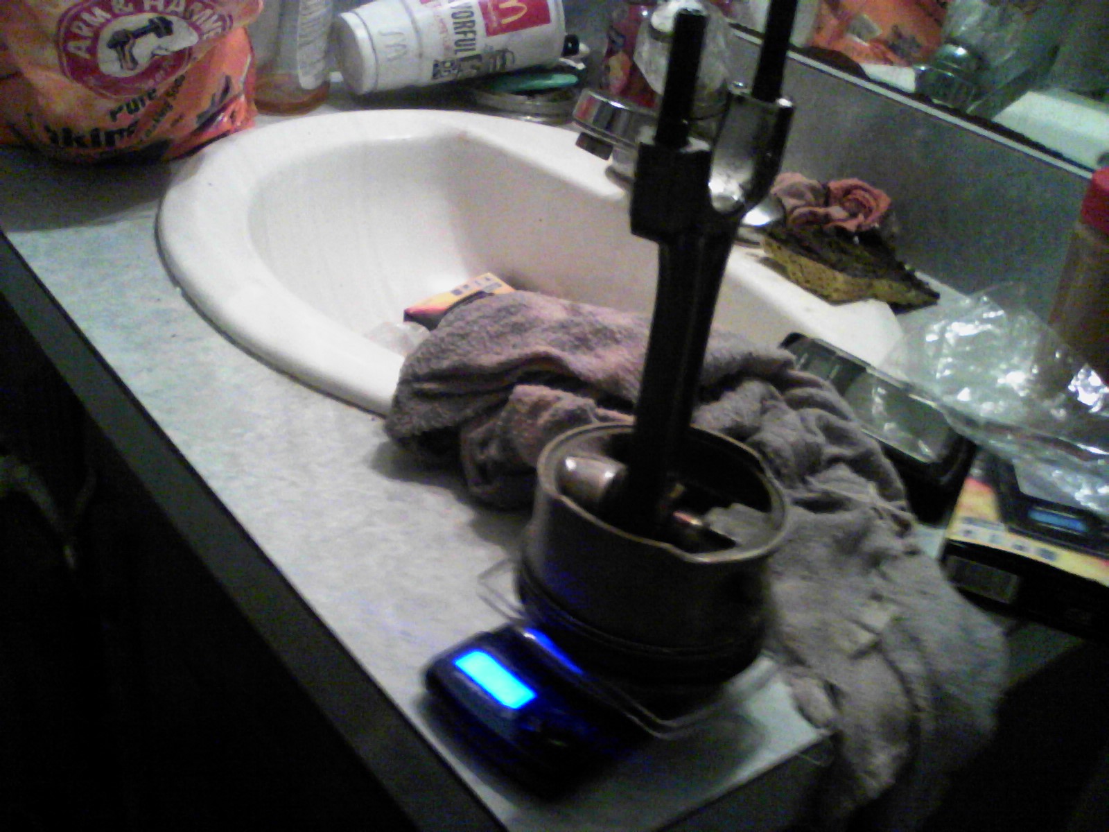

Today i removed two pistons, one good and one damaged. Then I
measured them both on my jeweler's scales, which always give
comparable results.
The greatest difference was 973.4 grams less 971.0 grams = 2.4 grams.
One ounce = 28.3495231 grams. So with three pistons off by 2.4 grams
each, that is 7.2 grams, or about a fourth of one ounce total.
Here is a close-up of the damaged piston, showing off my grinding job here: Here i measured the damaged piston:
Then, one of the good pistons was measured:

Any way you slice it what you did is back yard hack and would never be recommend to fix that specific issue... Whatever may result from it could be really bad or you'll just have a poor running engine overall and make this rebuild a wasted effort when you actually could improve your situation.
The weights would never match 100% either but with how much yours varies all over it could be worse and exaggerate an out of balance vibration.
