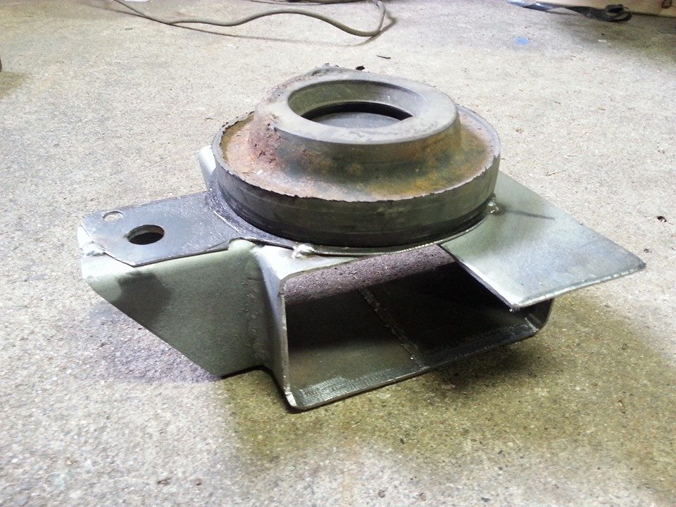

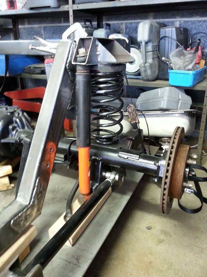

Tacked on the upper spring centers on the mount and mocked up the springs and shocks for the first time!!!!! Got to make some minor location adjustments but its getting there

Welded all upper suspension mounts on the the rear sub frame. And final mocked up the springs and shocks..
