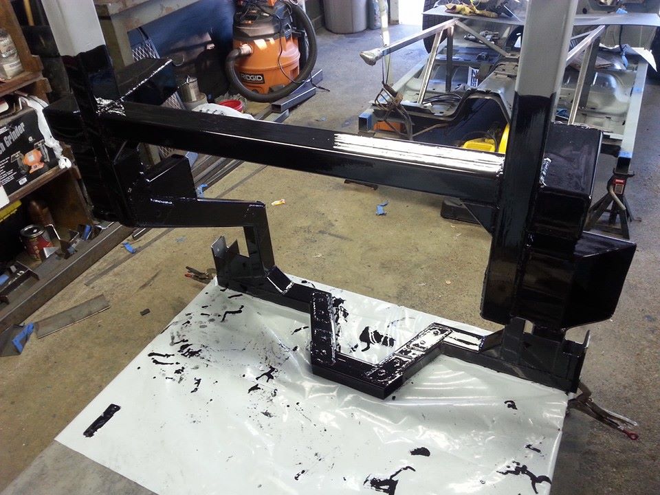

Sand blasted and painted POR15 on the rear sub frame. Next step is mating the rear sub to the body rails and finally having a rolling chassis !!!!!!!
Re: Beretta Z28
feel like i should have went satin on the frame like i did on the axle ........but my buds seemed to like the gloss........so its done......gloss black frame it is.......
