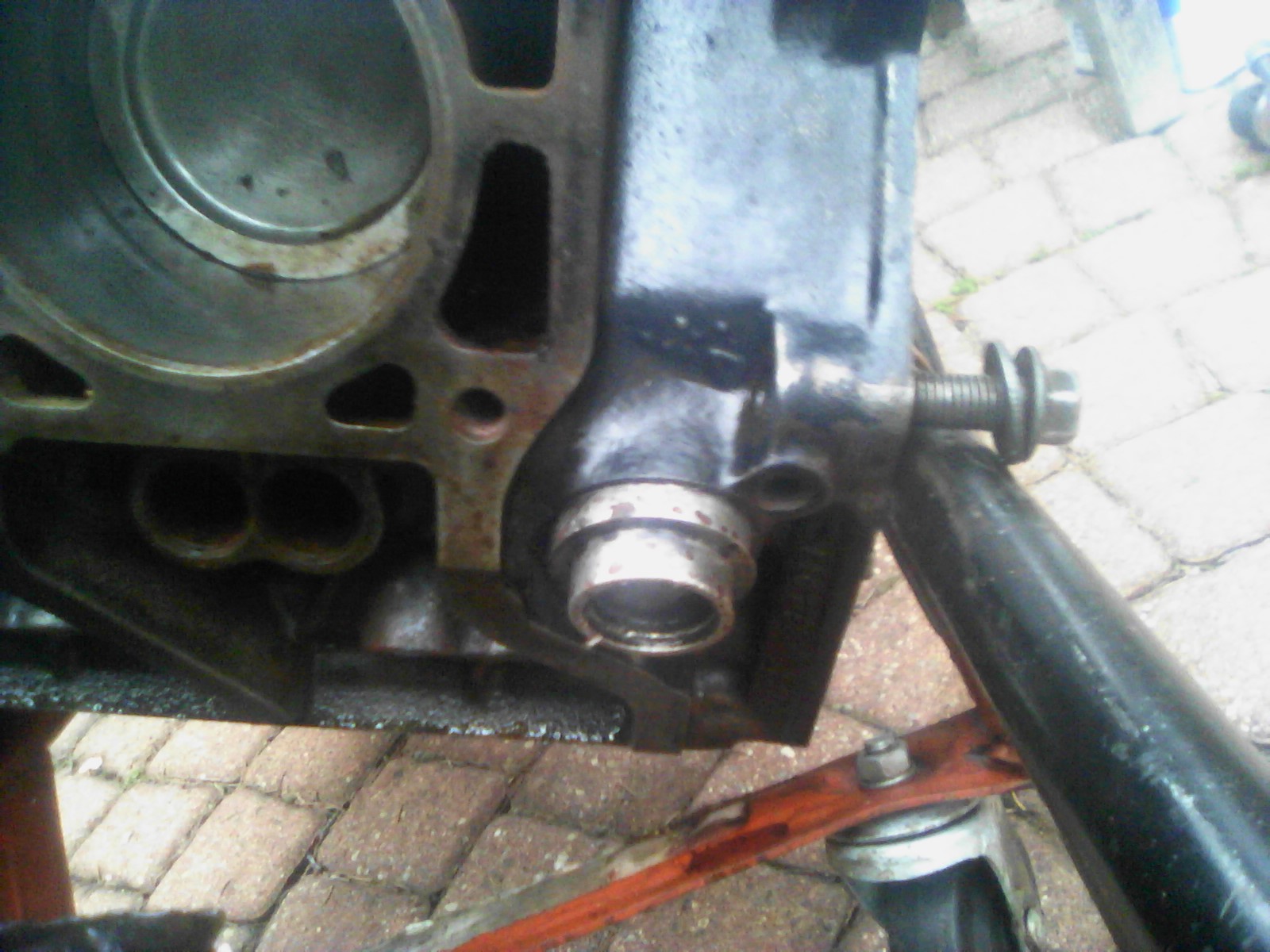

does this round aluminum head get removed? the service manual indicates this is so.
Re: Camshaft removal, 3.1
That appears to be the access plug to the cam gear although they are usually more like a frost plug.
Remove that, get a magnet and remove the cam driven oil pump drive.
You may be able to rotate the cam clockwise a quarter turn to get the oil pump gear to pop up a bit so it's easier to grab.

okay, but how is the access plug removed?
it is just a round plug with no hex head or anything for a socket or tool.
it is aluminum, so it is easy to destroy.
It's a damn frost plug!
Hit it on one side with a screwdriver and it will pop loose, and you will likely be able save it.
If not,,,Very easy part to find and replace the O-Ring while you are at it! Get the brown on not the black one.
:good:
Posts: 10916
It's not a frost plug it's like the base of a distributor since that's the hole it's plugging... Put a thin flat head between the plug and block and carefully pry it up.
This is what it looks like when removed.
ronaconda
Posts: 688
Location: Salt Lake City, UT
Post by ronaconda »
^^^ what Jon said DO NOT HIT IT WITH A HAMMER!!!
Juro
Posts: 43
Joined: Wed Nov 05, 2014 10:41 pm
Post by Juro »
Removed both. a sharp-edged chisel and a light tap of a hammer was required
but the plug popped right out.
