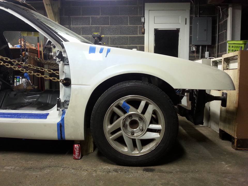

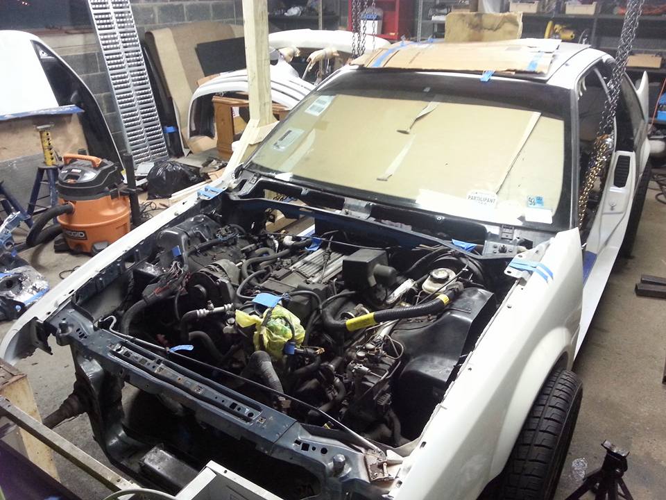

Sitting at a decent ride height 2 inch of jounce in photo. ..and could easily go down another inch....and can see the pop can clearance on The rocker so shouldnt be to bad for street driving after all. .....pretty sure driver side wiper function will be lost due to brake booster clearance.....but could always go with the one center wiper in a pinch......obviously gonna have some work to getting tire coverage on the fenders so looks like a prety agressive wide body is gonna be a must especially in the front..... but till then dont drive behind me cause there is no coverage for rock throw :b even the engine is looking pretty natural in there .....everything seems to be lined up fairy well....

I wonder if adding the GTU skirts to the sides and some sheet metal work will make it look ok? The front, thats gonna be alot of widening to do, unless you go custom wheels all around and have them a little narrower up front...?
On a more serious note, holy gently caress im in love!!! Keep that awesome work up!

Im probably just gonna end up with box flares .....I think I will be fine with that

You could always go hydroboost to get some more wiper motor clearance...
Posts: 4773
Re: Beretta Z28
Good idea Cliff. How much room do you have to bring the wheels further inboard with more offset? Start getting into suspension clearance issues I assume?
Re: Beretta Z28
Should have seen this coming ages ago for Heaven's sake!
Wheel offset may help but that will compromise Lord knows what else.
To me, sort of throws the whole "stock looking" thing out the window.
With all the effort involved the rear should have been easy to figure out and get the right width.
The front, while a bit more complicated, could have been addressed.
:beer:

Definitely looking into the hydroboost. Found a few companies the make specific for the f body but they sure are pricey. ...looking into some used OEM for trucks and vans .....maybe can retrofit thanks for the heads up on that one :)

Put most of the body panels back on and placed a few sand bags in the interior to simulate weight for doors and seats and cage and gas tank for a more accurate weight distribution. Finally got it sitting on its own weight and looking pretty good

Never really paid much attention to it, the front of our cars really narrow in that much from the rear? Too bad theres no way for you to suck the rear tires in an inch, and the fronts two inches. That would look alot easier to widen for.
