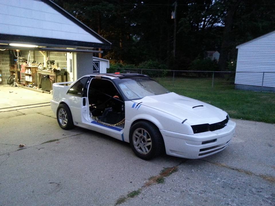

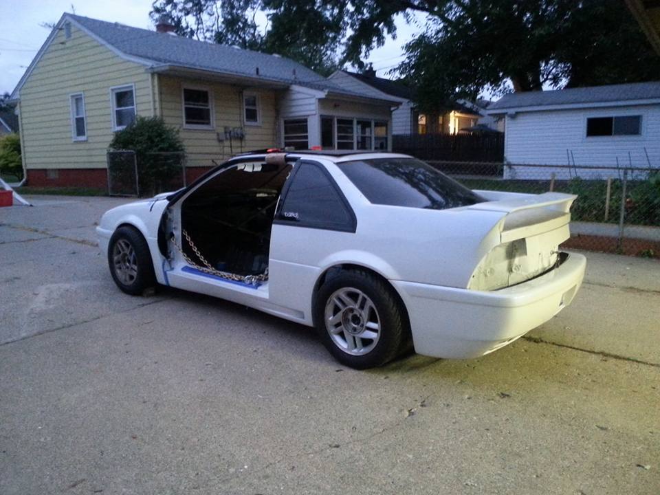

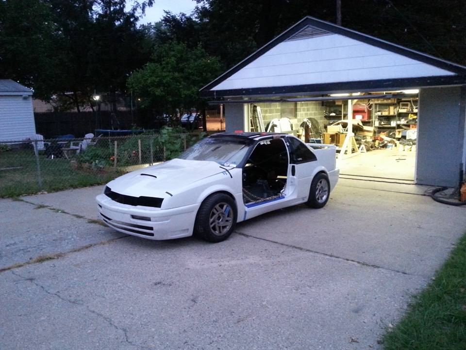

Actually tacked the body to the frame and rolled her out for some fresh air. Its really starting to look like something.!!!!gotta get a plan going for the next steps
Re: Beretta Z28
It's got fins like a '57 Cadillac and a trunk spoiler off an '09 Honda Accord?
The wheels stick out like a Clown Car!
Should have maybe checked with this guy on how to build a RWD properly.
http://www.smithperformance.com
Everything lines up and a rolling chassis is out the door for about $15K, certified to 8.50's.
Just a thought.
Just a thought.
