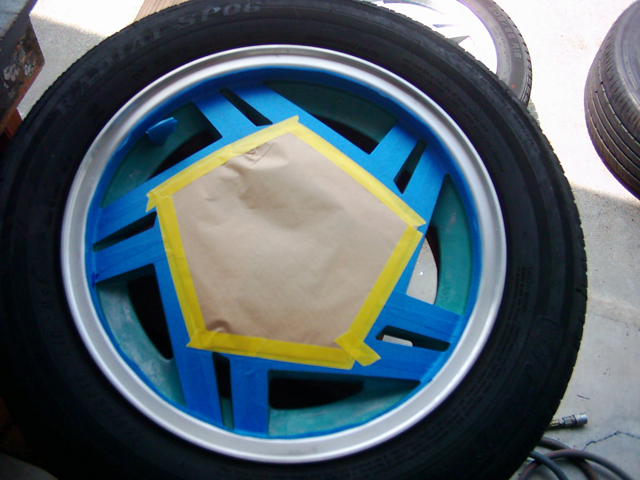

I layed tape over the clear parts of the wheel carefully, and not too hard, to paint the green inserts before the clear. remove tape and cleared the entire thing. It worked and I'm happy.

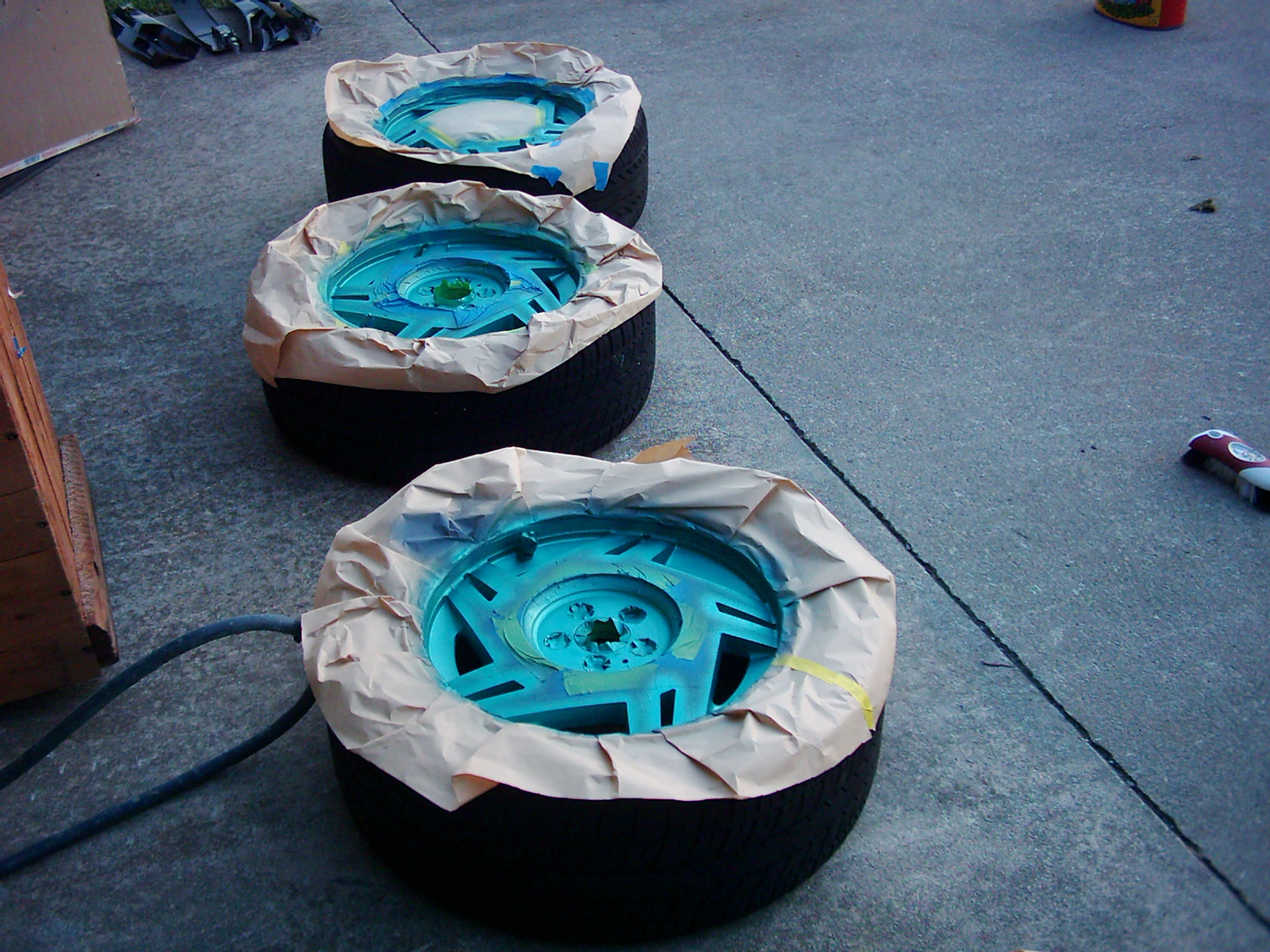

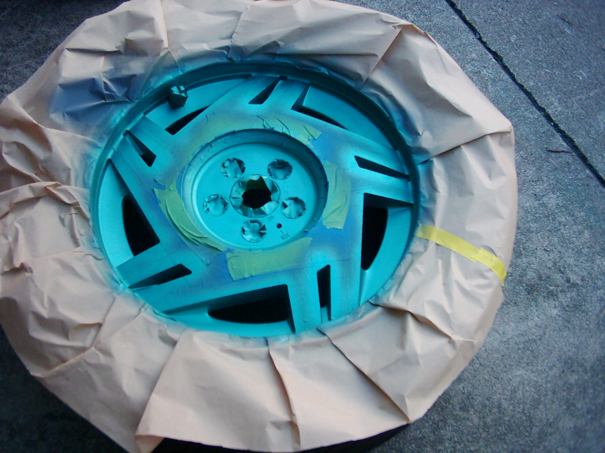

Its amazing how I even function. I do somehow manage though. oh, and I'll have to update this later with a finished picture... that I'll be taking in two min because its still off the car and I can get a good sunlight pic.
