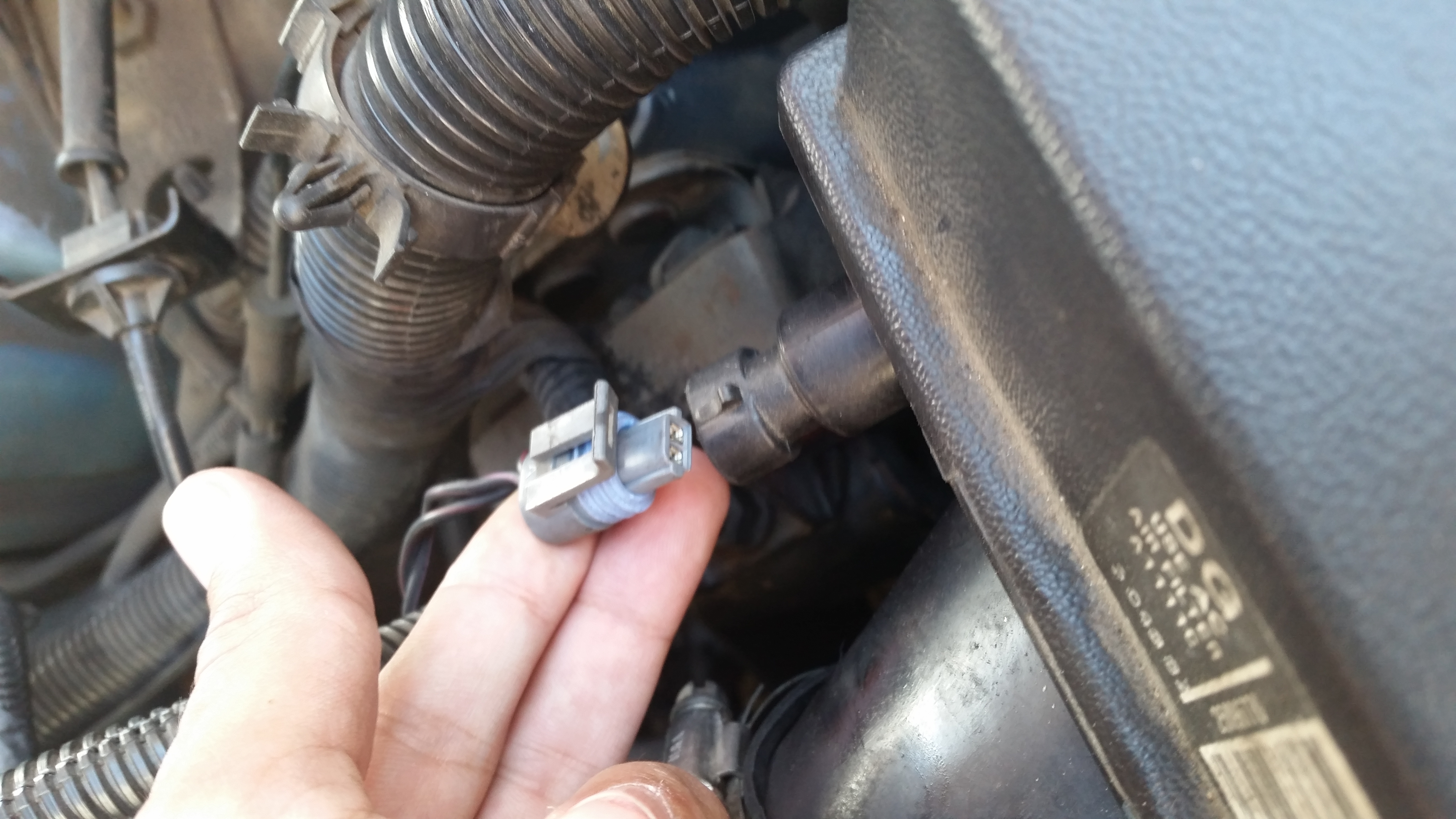

Re: Help please 89 Chevy Beretta
Unfortunately we don't have a way to pull codes. I replaced the TPS 2 days ago and that didn't help. Did another relearn on it as well. What it's doing is when I brake ands then take my foot off the brake it just dies. The idle seems to be fine now otherwise. I'm located in Gardena CA probably to far. My number should you want to reach out is 310-803-2523 my name is Jarrod
The MAF is located between the air filter housing and the throttle body.
If this is an idle in park stalling condition then that would exclude the TCC all together... but if this only happens after driving at a steady speed then coming to a stop I would have to agree that the TCC is not unlocking as it should. Another way to test that if you can not find/unplug the TCC (not the sensor pictured above, that is the Intake Air Temp sensor) try just putting the car into neutral when coming to a stop and see if it stays running that way. It will probably still stall as soon as you try to put it back into drive if the solenoid didn't release.
