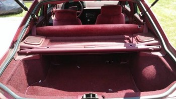

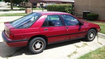

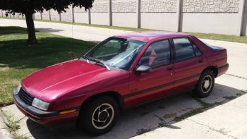

I'm new to this forum, but not to working on my cars. I have an '89 Corsica hatchback I acquired. I'm the third owner of this vehicle and I'm presently having a problem with. It. It won't start. I have replaced all three of the coil packs (engine is a 2.8 FI V6), the ignition module beneath those, the ignition switch,, spark plugs, wires, the starter and, finally a couple days ago, the fuel injectors. Still, it won't start. My next action is to replace the crankshaft position sensor. I just wanted to know if there is anything else that I need to check. Pictures enclosed.

Welcome! Unique car, appears fairly clean.
