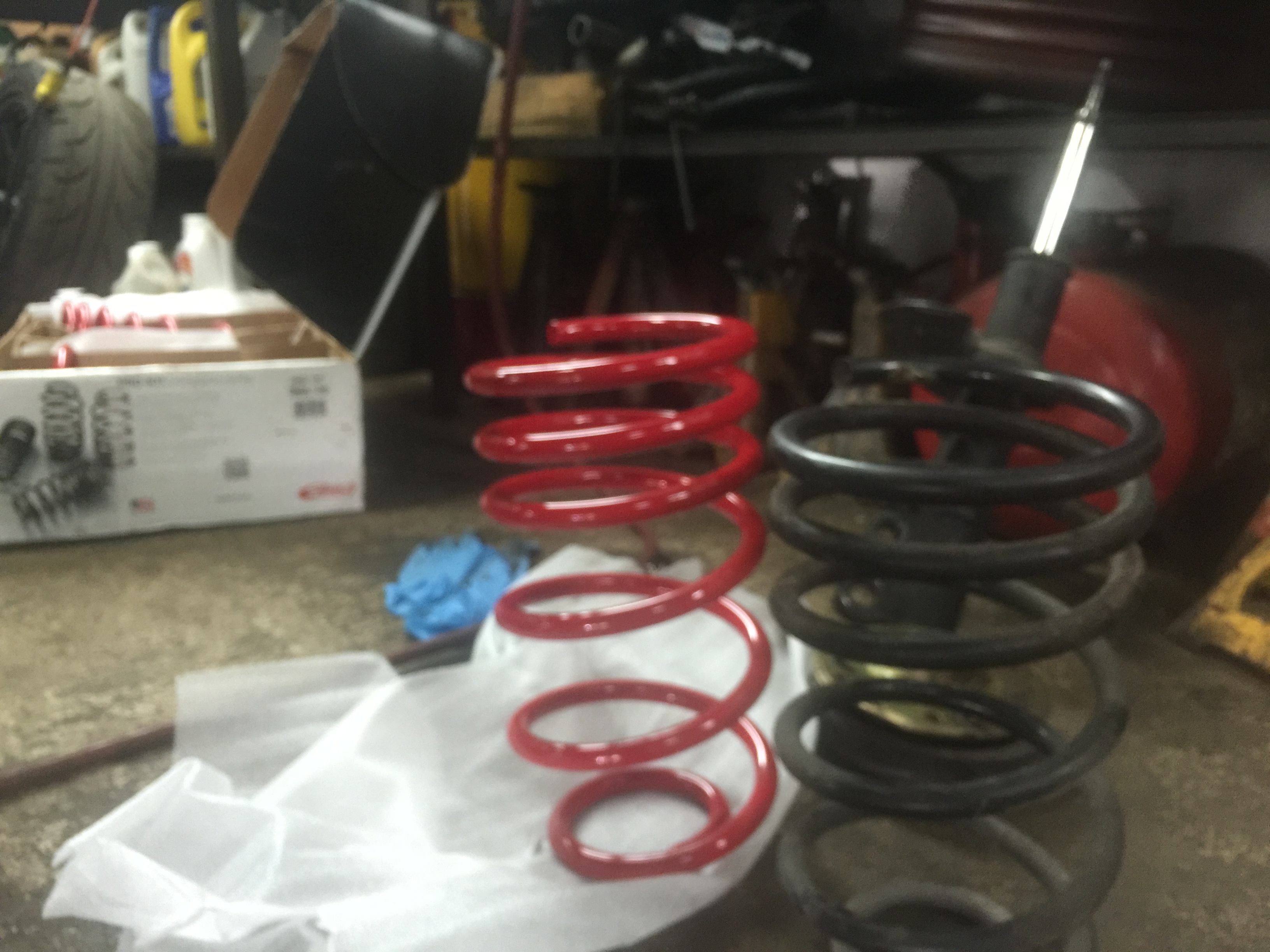

Over the last 18 months.
Purchased group (Kimmitt) eibach and Addco sway bar.
Had them powder coated red, today they are getting installed.
The newer springs appear to b 1/2" plus higher.
Measured the car b4 the swap, the car was 1/4" lower on the drivers side compared to passengers side.
Also installed my brand spanking new rad juice a wind shield washer resevoirs.
Also installed those little plastic parts that go between the inside upper door grab handle and the panel. Old ones cracked to pieces.
Alignment to b done later this week.
Front drivers spring
Front driver spring
Front driver spring
Posts: 10919
Re: Pauly's 90 GTZ rebuild.
I experienced the same thing... the Eibach's appear to be taller than the FE7 springs but the car height ends about the same IIRC... I never did measure exactly. FE7 appears to be a linear spring vs the eibach which is progressive so the first few coils take on the load and level the car to the same point but under compression they will get stiffer... May handle a bit better in the end.
Red_Bra_Black_GTZ
Posts: 378
Post by Red_Bra_Black_GTZ »
My springs are not fe7, I do not know what they r, they r a mantapart installation. That is 1 reason Y I swaped them
