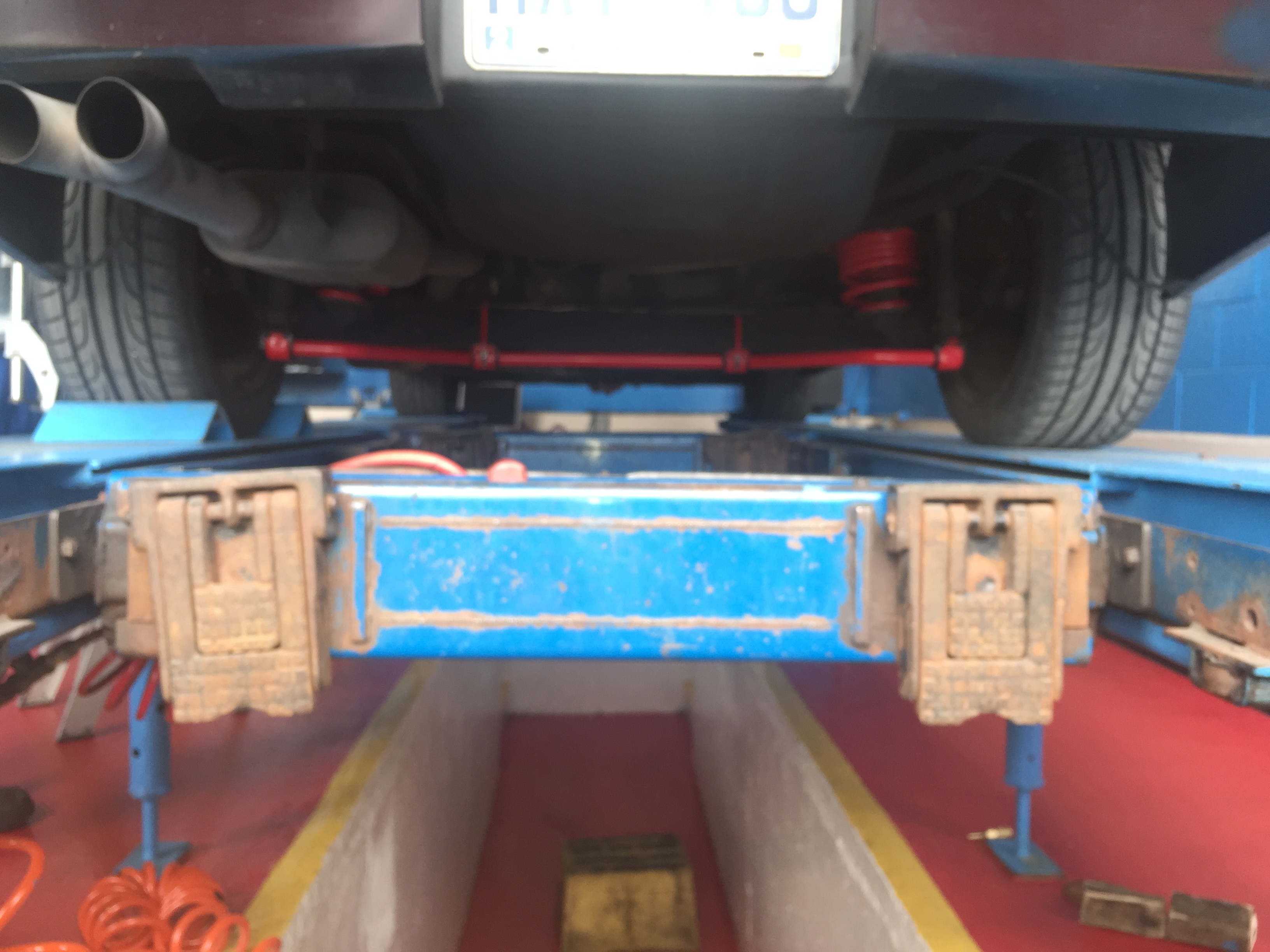

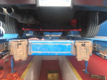

getting a wheel alignment, camber was way off after the spring swap

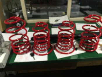

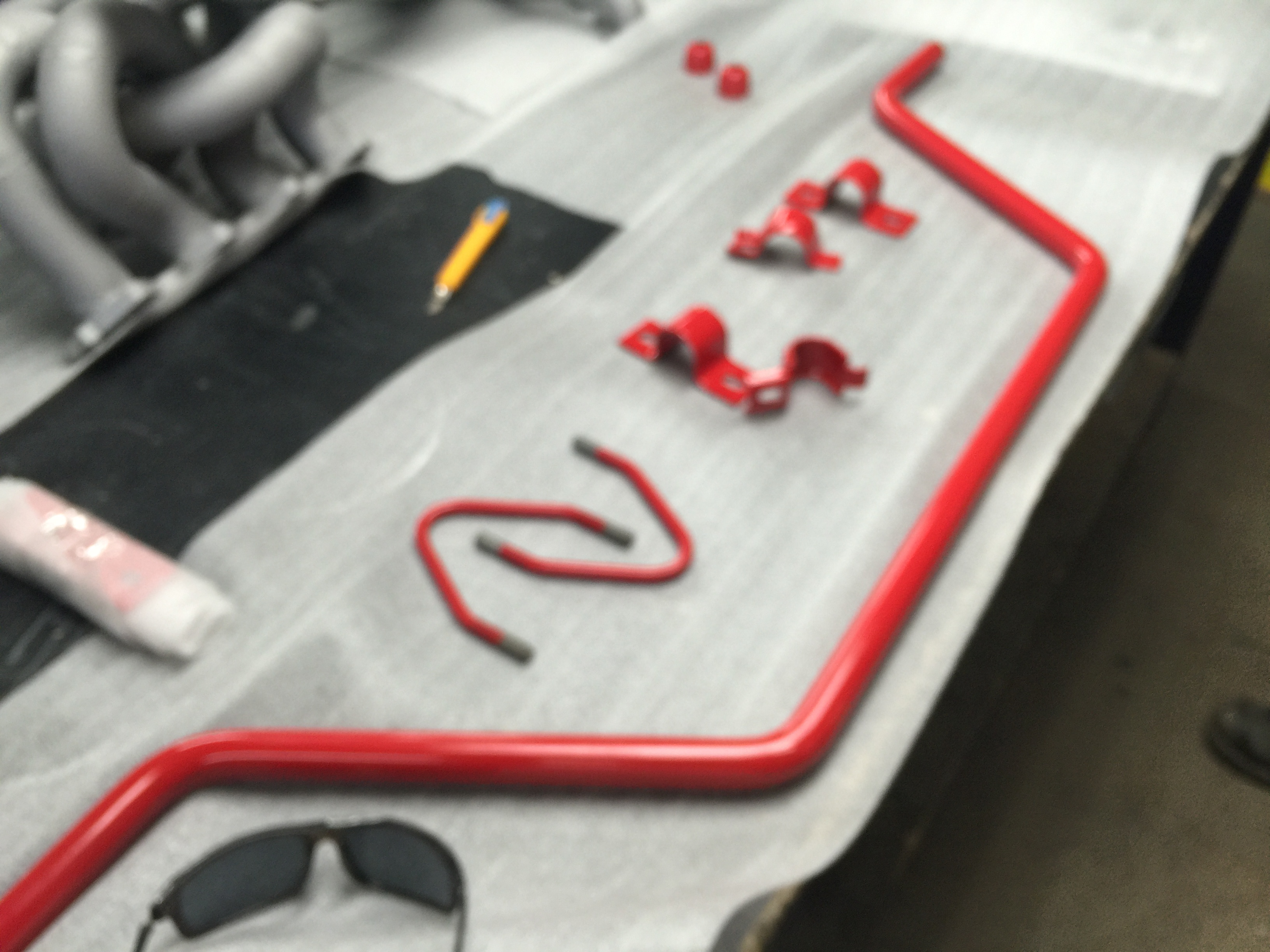

better pics of the (KIMMITT) Eibachs springs and Addco sway bar.

fyi, i just noticed that my new eibach springs ride lower then my previous rear springs. previous were from june 24th 2000 at mantapart.Red_Bra_Black_GTZ wrote:Ride heights,
