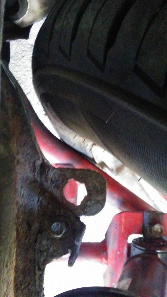

Smoothed out some flanges on The engine cradle and welded em up to prevent the tire rubbing at full lock. And squeeze another degree out of the steering angle.

Re: Beretta Z28
Are the lower arms still powder coated?
I know its a drift car - but clean them up with some degreaser - the new calipers make them look terrible!
LOL...
LOL...
Re: Beretta Z28
Believe it or not .....I tried......they might need a fresh coat of spray paint :/
