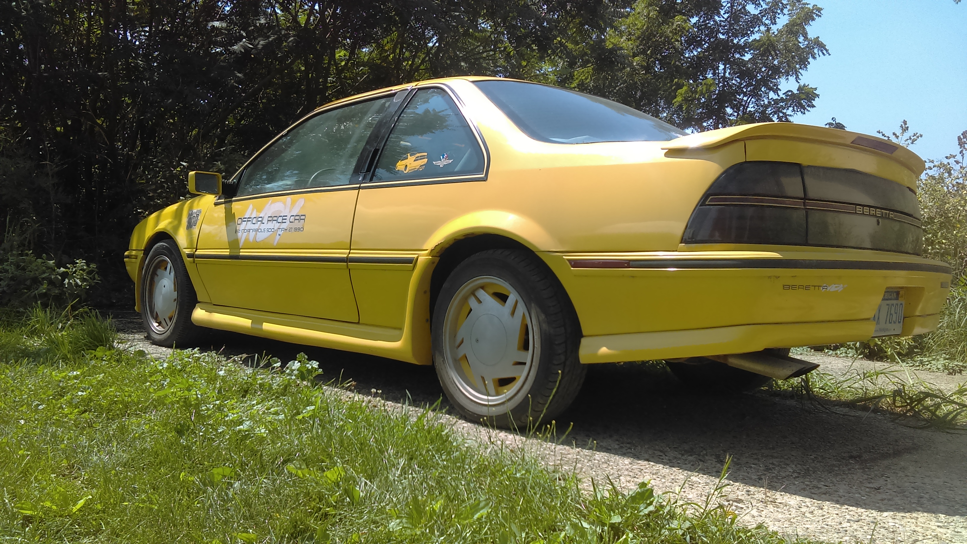

It's been awhile since I've posted on here most of you guys know my 1990 Beretta Indy. She has been put away for over a year now due to a broken seat last year after Beretta Fest, we fixed the sea and then now we're having problems with it misfiring We have replaced the injectors which was the sole problem recently had 3 bad injectors I bought all new injectors and had replaced them, tore the engine apart and had one that was leaking to make thiga easier to explain here is my post on facebook.
Ok so replaced intake gaskets today and she's running better than she did Thursday (staying started/not stalling) but she still has a misfire. So any guesses on what to check now? Plugs (again), wires, no vacuum leaks, its not old gas as this was just put in a few weeks ago. Also just took it for a drive and found that it only misfires under low RPMs what could be the problem any advice is welcome thanks in advance
