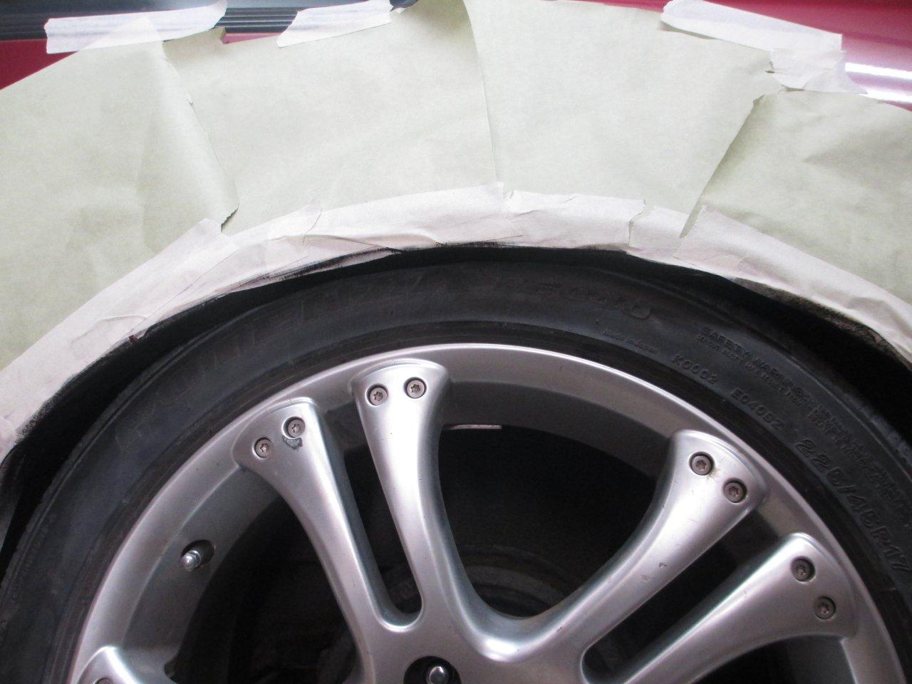

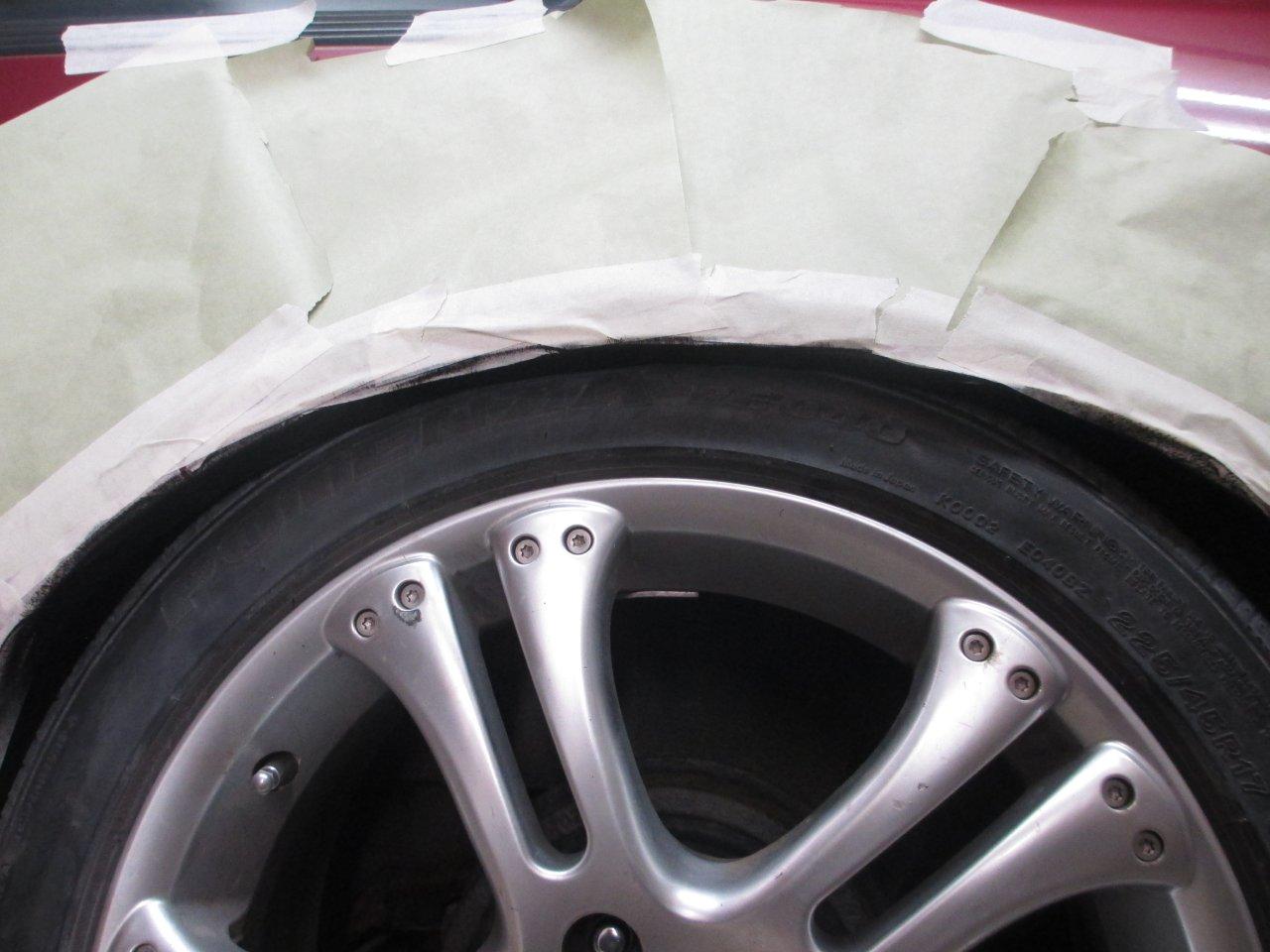

Quarter panel to tire clearance
It seemed like slow going this weekend. I've had tire rub on the drivers side quarter panel lip since I got the car.
I need new tires, so I was thinking of dropping to 215 45 17's to try and remedy it.
I decided to stick with the OEM springs, so I'm getting 225 45 17's again.
I pulled the shocks and springs and ground down the wheel well flanges as much as I could without getting in to the spot welds. Wheels on and off several times to check progress. They still rub if you bring the axle up high enough. I can't imagine that the springs wouldn't be bottomed out at this point though, so I'm just going to roll with it.
I cleaned the flanges all up, painted them with zero rust paint, and then shot some undercoating over it.

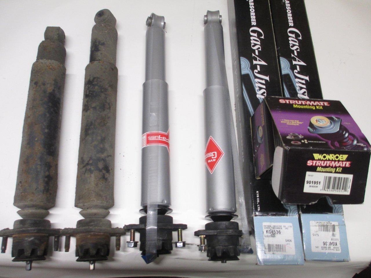

New rear shocks, front struts out
I'm pretty sure these are the original shocks, wow. Zero resistance. I can't believe how much more stiff the gas a just's are. They look like a quality product, made in Japan so they have to be good!
I'm hoping between the new shocks and the trimming I did that I will be able to load the trunk up for vacation and not bottom out the whole way like we did when we took it to Ocean City.

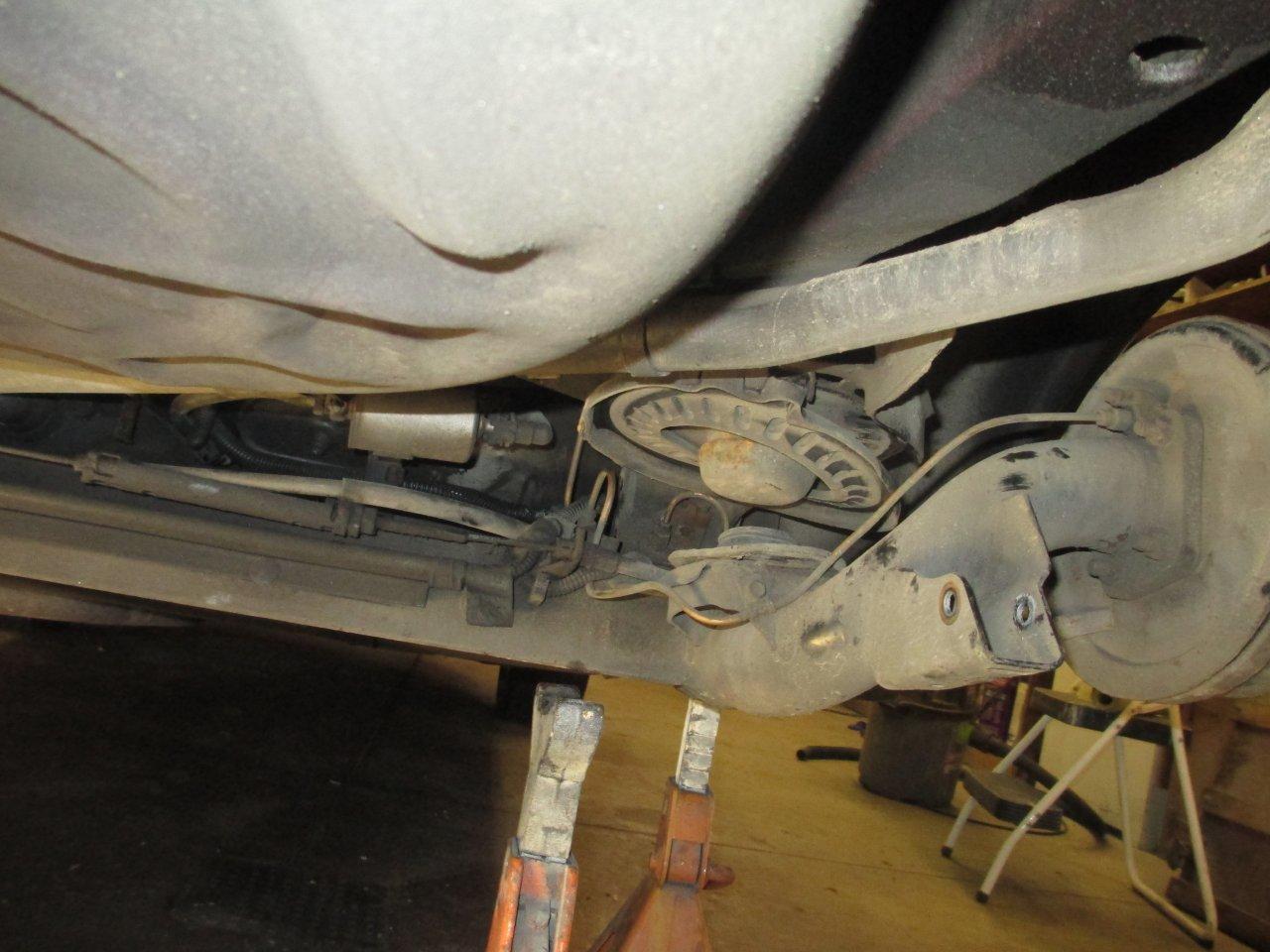

It took a lot longer, but I'm trying to do everything I can to keep this car from rusting out. After I put the rear back together I pulled the struts. I have kyb's coming from RA since one of the sachs ones I bought was bad out of box, and it was the last one.
I had the car aligned last summer, and so disassembling it I discovered that the splines had been ground off of the knuckle bolts(!) They had called and said they had trouble getting the bolts out and charged me extra.
I was pretty pissed. I took it to a highly regarded shop, and I planned on taking it there again once I get the new struts on. Its like half mile from my house, and I don't want to drive the car far with the camber all out of whack.
I need to order new bolts I guess. I have to assume the splines are there for a reason. I ended up going in for the day because I was pissed about the bolts lol. They may have needed to grind them down, maybe they were all puffed up from rust, I don't know.
Edit: I searched around for new strut bolts, and what come as replacements are camber bolts, and they do not have the splines. I will re-use the original bolts: maybe I was upset for no reason that they had been ground smooth.

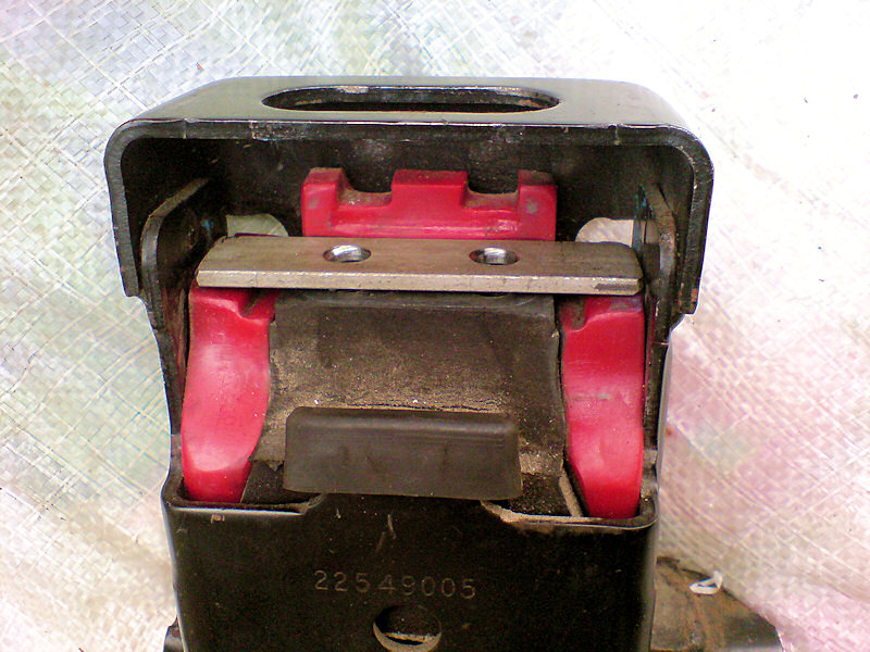

good god! 1.10 for that poly insert... the price just keeps dropping...heavywoody wrote:Get a new motor mount, then get the polyurethane insert from here: http://www.rksport.com/product-p/rk-507.htm
That should help with your situation!
LOL I couldn't believe it was that cheap, I was reading old posts on here and guys were happy to pay $15-20.3X00-Modified wrote:good god! 1.10 for that poly insert... the price just keeps dropping...heavywoody wrote:Get a new motor mount, then get the polyurethane insert from here: http://www.rksport.com/product-p/rk-507.htm
I was going to order 3 or 4, but the shipping was going to be $30 for 3 qty, but only $10 for 1. So I ordered one.

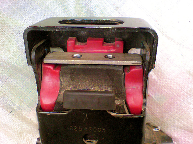

I found some old very useful info from member Weba about making a plate to sandwich under the aluminum T, this will hold down the insert. (I have the earlier style mount, '93).
So thank you to Weba, I'm going to copy your design. I'm attaching a photo I found from way back.
- Posts: 4788
Hmm. I've never seen that before.
- Posts: 10923
No need for that on our year mount because it's capped off already. The older versions didn't have something that would hold the insert down.

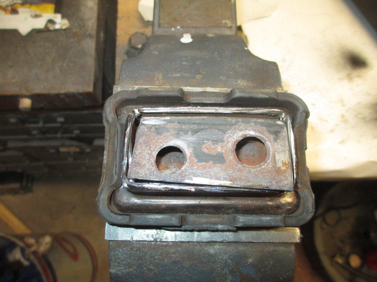

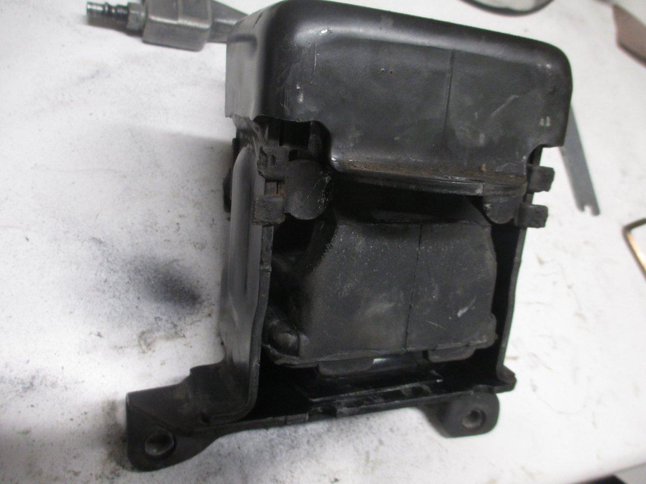

I went ahead and replaced this inner mount insert since it seems like the RK Sport poly insert is NLA. No official word yet, but the order has shown "processing" for at least a week.
There was rust from where the original rivets had let loose and the rubber mount was moving around so I cleaned it up and painted.
I then went to screw in the new mount with the countersunk screws that it comes with, and they bottomed out before the mount was secure to the housing.
I ended up cutting the bottom out of the existing mount and used it as a spacer after I cleaned it up and painted it. Hard to see, but it is underneath the rubber mount insert.

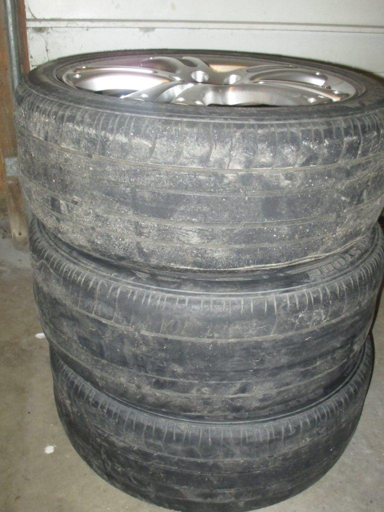

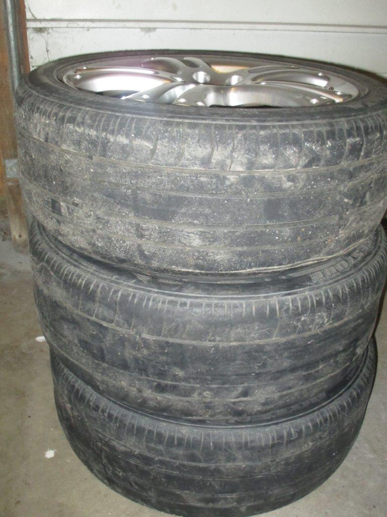

New tires on the way
Time for new tires? Man are these bald, I'm actually glad the car had an electrical problem that made me quit driving it (posted in diagnostics). I knew they were worn out, but when I saw cords I knew that was it.
These are bridgestone potenzas that came with the car, expensive tires.
I ordered Sumitomo HTR A/S. I originally was going to go with summer tires, but there are a lot of days where its well below freezing, yet the roads are clear, and I will drive the car on those days. I'd probably be fine, but this isn't a "performance" car anyway. In my mind it is though, dammit!

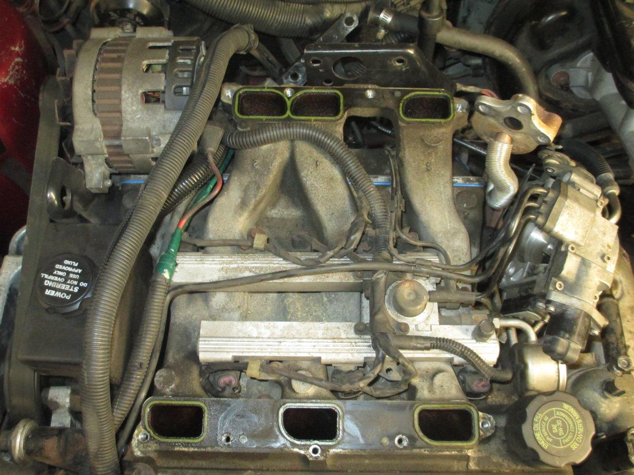

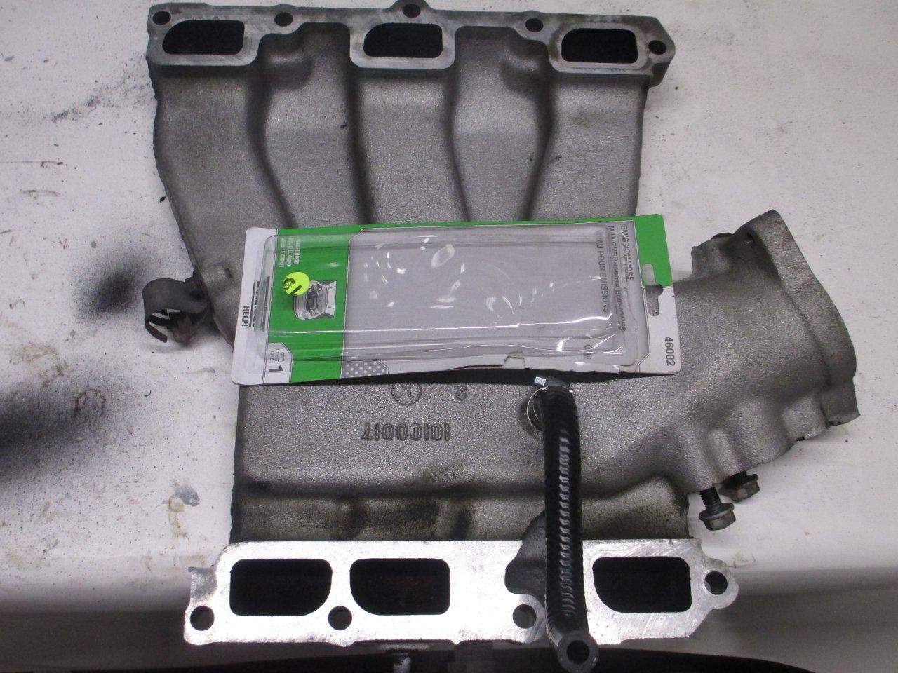

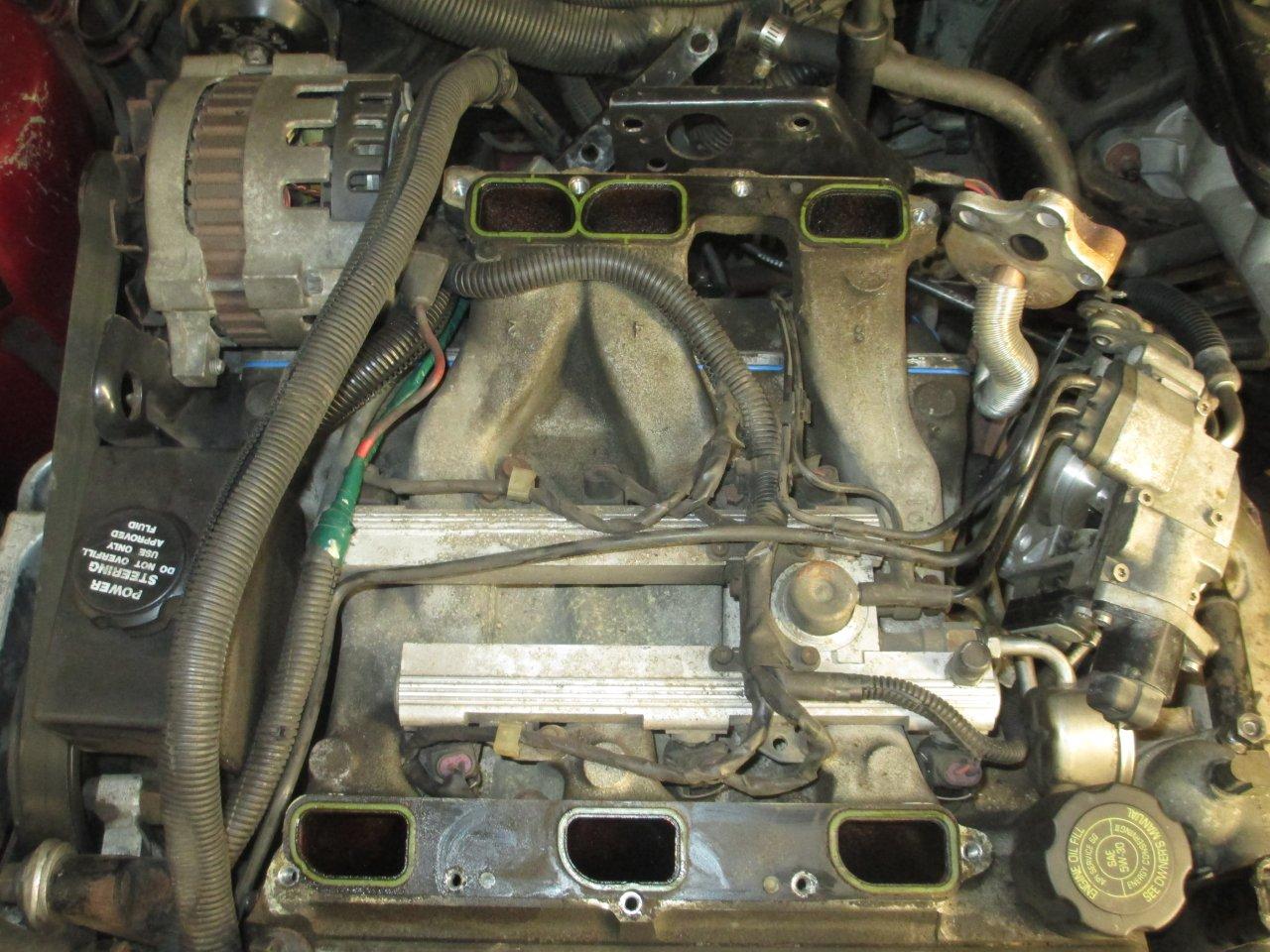

PCV hose
Nothing too exciting. Pulled the upper plenum to replace the PCV hose that was hard as a rock. Don't want to chance that vacuum leak, I doubt the engine would even run with a leak that big. Checked over the vacuum lines under there and cleaned out around the injectors, there was dirt from over the years, and leftover sandblasting sand from when I repaired the cowl. Don't worry I taped over the intake ports before I blew everything out with the air hose.
Dorman p/n for the hose is shown, I like to document this stuff since I kinda stumbled across the premade hose, I thought I'd have to make my own.

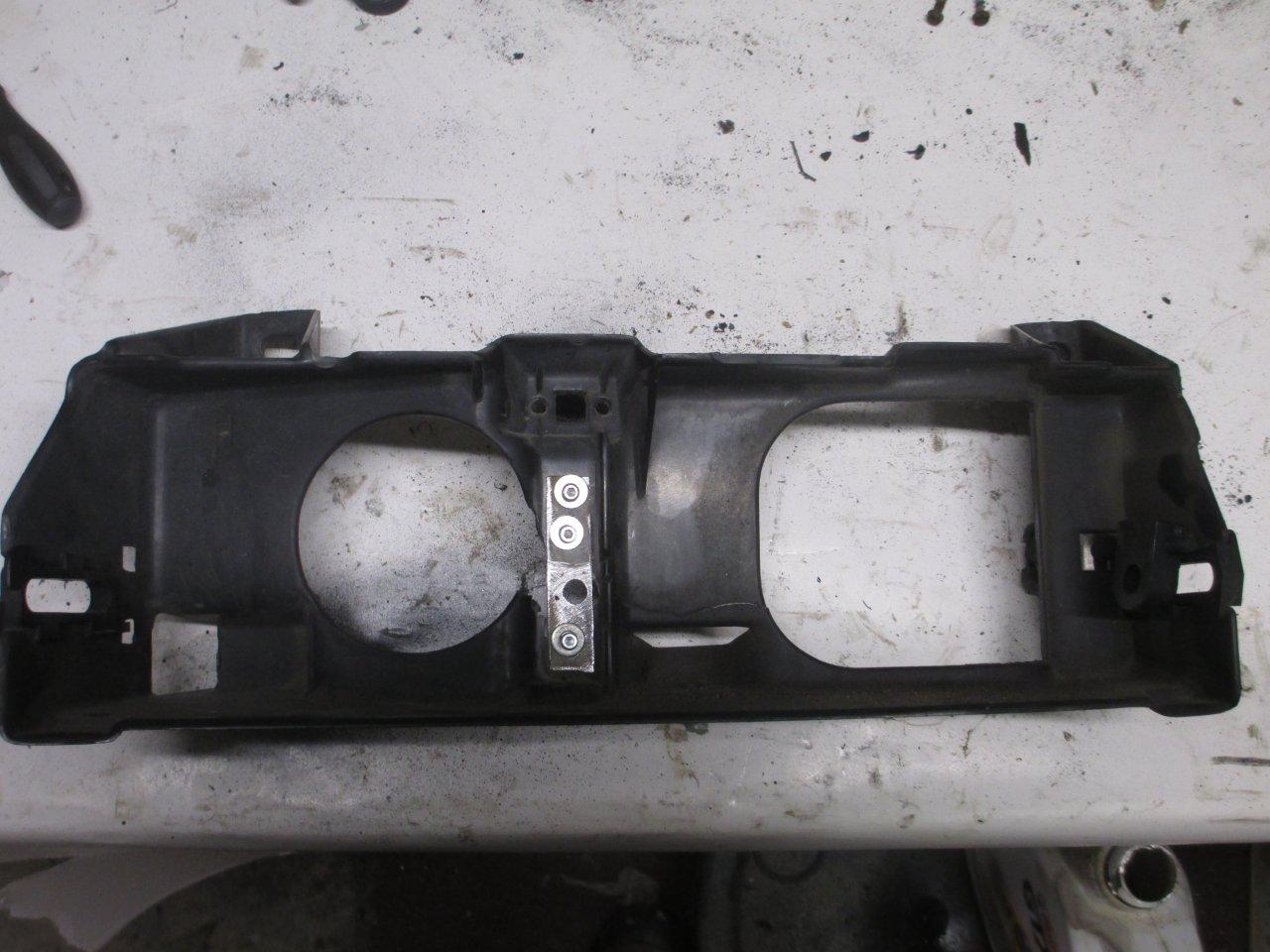

Headlight housing repair
I'm still waiting on a good pair of struts, so I have been fixing all kinds of things that have been on my mental list.

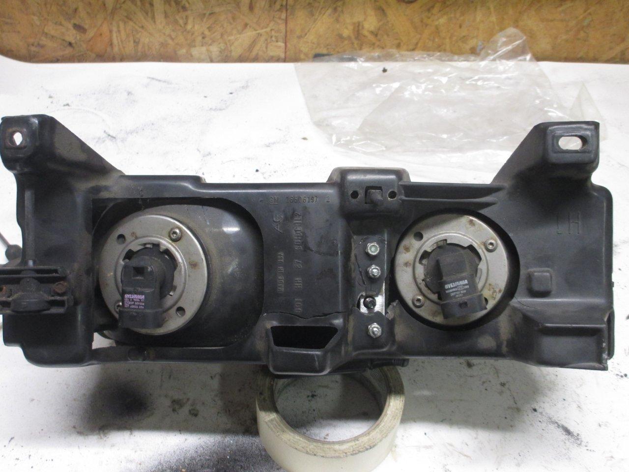

The drivers side headlight has always pointed at the ground. It took some kind of impact because the housing is all cracked.

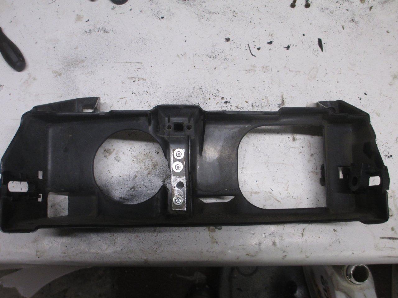

I took it apart and there's a spring that holds tension against the adjuster screws. The spring was still there, it just was unclipped due to the damage.
It would have made more sense to just get another assembly, but why not fix it? I had everything I needed in my garage. I just cut a piece of sheetmetal and braced the cracked area, it worked out OK. I still had to turn the adjusters quite a bit to get the light to look halfway aligned.
